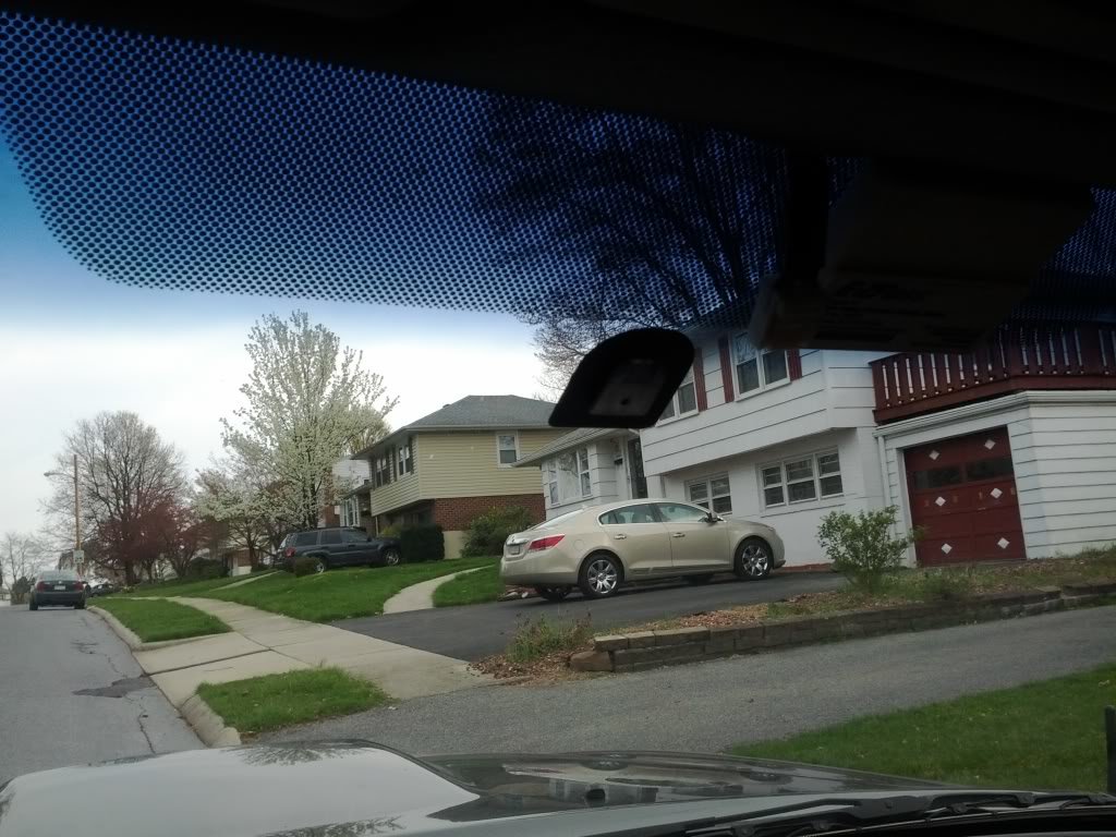

    So got my mount today and got it installed. At 6'3" this has always been a huge annoyance to me. This is generally what my view used to look like while driving.

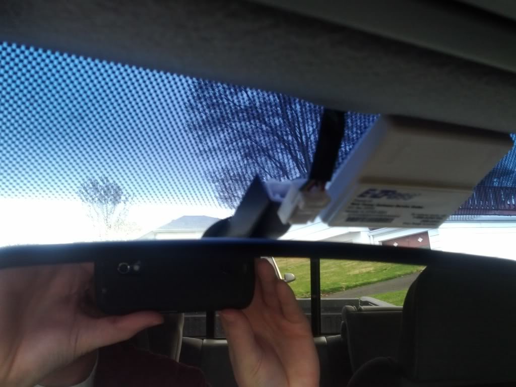

    View after removing plastic cover over wiring with wiring unplugged.

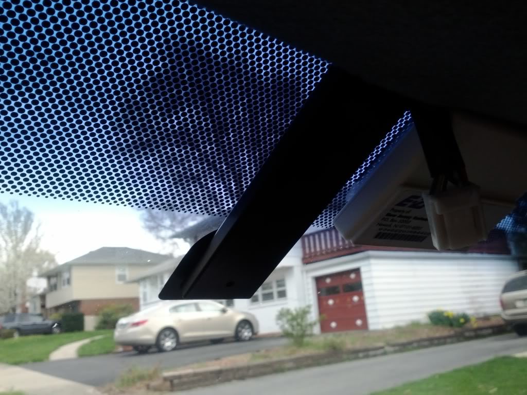

    Rear view mirror removed.
    Mount slid into place. You'll probably have to pull back your headliner a bit to slide the top up a bit so you can get the right angle to slide the mount down onto the existing windshield mount.

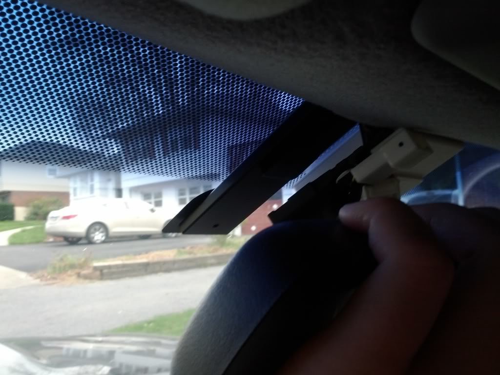

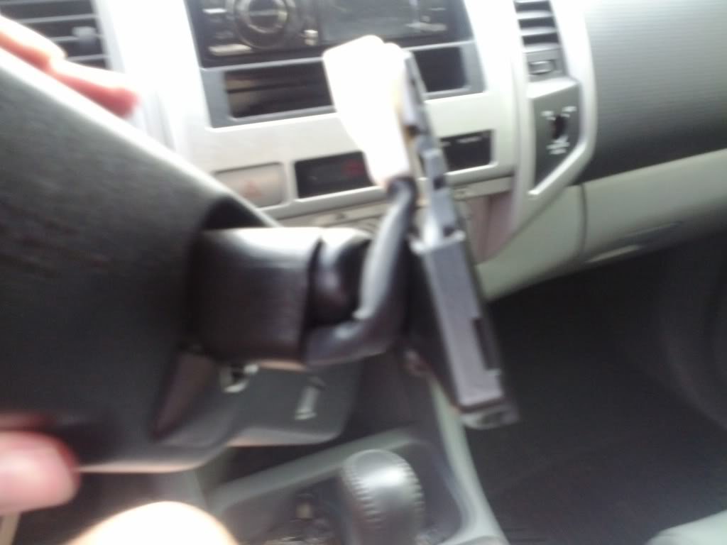

    Only part that may give you trouble for a second if you're brain dead like me is if you try and install it like so.
    The wiring connector makes it impossible to slide into place.
    But what I didn't notice without the help of ImMrYo is that the connector comes off. You'll need to first remove the plastic that holds the wiring in place around the mirror stalk. This will give you slack that you can pull the wire connector off from the black plastic of the mirror(forgot to take a picture with it off). You'll then be able to slide the skinny part that's left behind the headliner so you can again get the right angle to slide the mirror down onto the new mount.

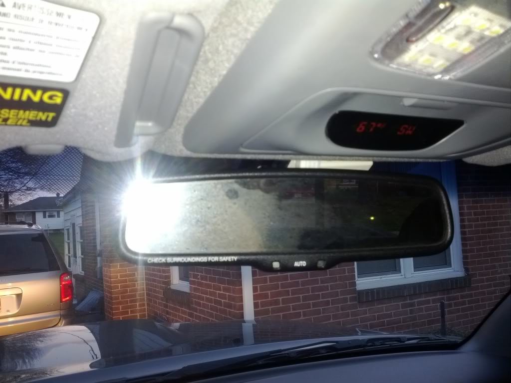

    Received mine today and installed in minutes! The mirror position was my only complaint about the truck besides my rear leafs, and that's getting resolved, I think.
    Pic shot from eye level:
