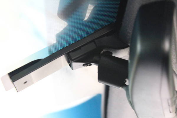

    A little bit of plastic trimming cause I couldn't deal with seeing the plug.
    What I was using:[​IMG]

    I like the plastic trimming you've done. Looks awesome. I might give that a try. Thx.

    Yeah, someone else had a brief writeup on this a while back but I think they cut the headliner and not the trim piece. Pretty much pull the tape holding the rearview temp and camera wires back, stuff the connectors into the headliner and trim the plastic at a 13/16" radius about 1" overall length and it fits pretty well.
