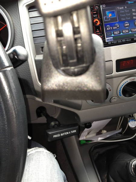

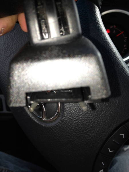

    pinch the plastic cover with your fingers and it will pop free of the mirror base. The mirror base has a plastic clip that grabs the flat side of the metal window tab. flex that clip and the base will slide off of the metal window tab.

    You sir ^^^ are correct and want to say thanks for getting back to me. I took a few pics but just realized they are terrible so hopefully people here can read what you wrote and use it to figure out my pics! I will say that in terms of the person that cracked their windshield....I don't think it was because of this bracket alone but rather user/installer error. The precision of this piece should be compared to a fine switch watch! Probably off by .00000000000001 of an inch and is unbelievable! What I can say is the bolt and little allen key that Jerry provides would probably snap before it could cause that kind of damage because they are so small (which also contributes to the nice aesthetics!). BUT....once the mirror is mounted, you may notice this one thing about the mirror that you never knew before and that is that there are actually 2 points of adjustment on these!! Problem is that the newly discovered one is SOOO tight that when you apply pressure to it incorrectly say using a downward force, you will definitely snap that glass. But again, has nothing to do with the bracket because you should not be applying that kind of pressure at that angle regardless of what it is mounted to. You need to actually grip the entire part with your fingers and apply pressure against itself in order to adjust it properly.
