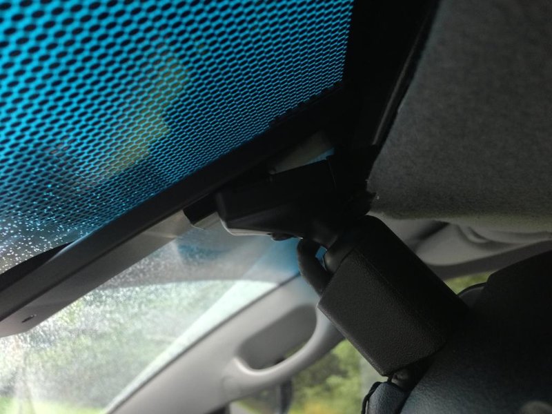

    What am I doing wrong here??? I get the mirror on the bracket at this obscure angle but can't get it to slide down from there.

    It looks all off kilter. You have to slide the mirror up under the headliner just a bit if I remember correctly. Then it should slide nicely down on to the new bracket.
    Also, are you sure your new mounting bracket is all the down as far as it will go on to the OEM plate that is attached to the windshield?

    I actually found it easier to attach the mirror first and then slide the bottom part onto the button securing with the setscrew. I had much more leverage to make sure the mirror was seated properly prior to attaching to the windscreen.

    Tried it a few times. The new bracket was definitely all the way down and the mirror was on the track but the top of it hits the roof at a weird angle not allowing me to slide it down.
    Tried this as well but couldn't get it down. I'm gonna fiddle with it some more tomorrow when it's done raining.

    I believe it may be something simple we are overlooking.
    Two questions.
    1. Has your windshield been replaced at some point in the past and the button reattached a little closer to the top?
    2. I will assume you do not have the clip on type of mirror so is the setscrew backed out sufficiently?

    Got it installed today (#747). Not sure what I did differently this time. Loving the extra visibility out of the windshield.
