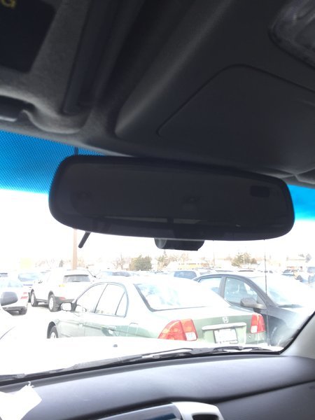

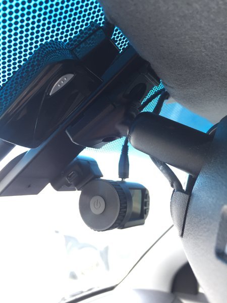

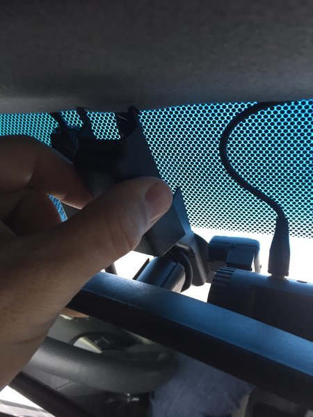

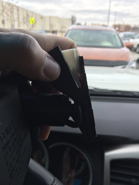

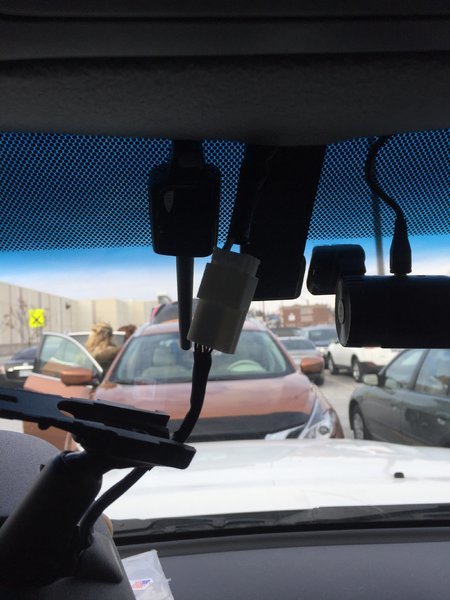

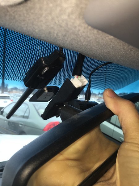

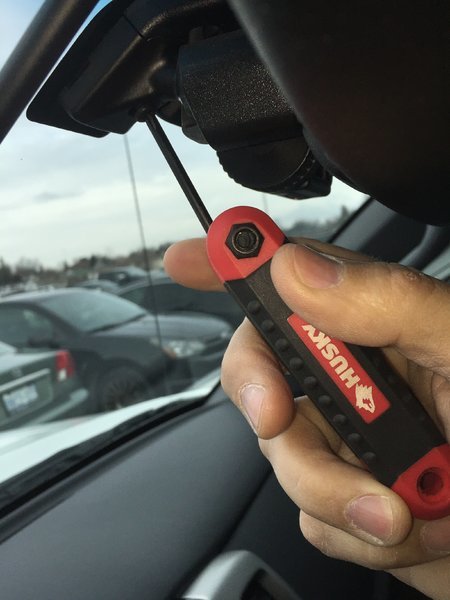

    Just received my mount and it's GREAT! I thought I'd do a little picture tutorial, unless it's been done by all means edit this post.
    The instructions from @ImMrYo are pretty straight forward so I'll just use his words.
    Step (1 of 3) begin by gently removing plastic wire cover2017-01-14 13.52.27.jpg (step 2 of 3) then with an T20 torx driver loosen the set screw and lift the mirror off OEM mount2017-01-14 13.54.01.jpg 2017-01-14 13.54.36.jpgthen squeeze the plug and separate 2017-01-14 14.06.34.jpg (step 3 of 3) pull off the last plastic clip that holds the wire so you'll have enough slack to tuck under the headliner. 2017-01-14 13.59.33 HDR.jpg(note: there is 2 clips, the one that covers the plug and the wire). The rest is very straight forward as to putting the new mount on and stuffing the wire up in the headliner, then tightening the screws. 2017-01-14 14.08.08-1.jpg2017-01-14 14.11.15.jpg As you can see I did this in the parking lot at the mall while waiting for the boy to grab a card, with my remote starter antenna and video camera in close proximity. Which reminds me, I have to re tuck everything nice and neat lol!
    Hope this helps someone.

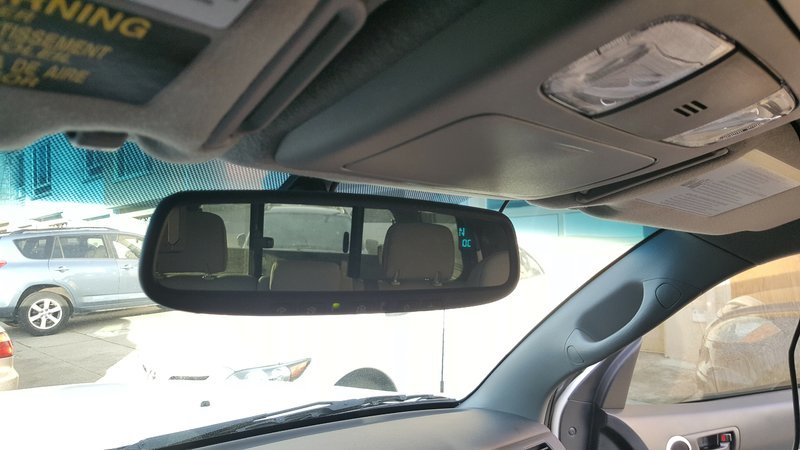

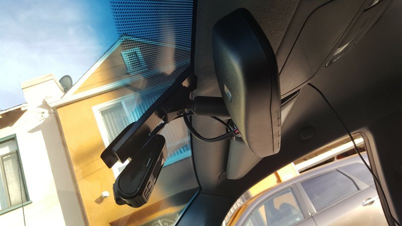

    thanks mryo, looks great. i get a better view on windshield
