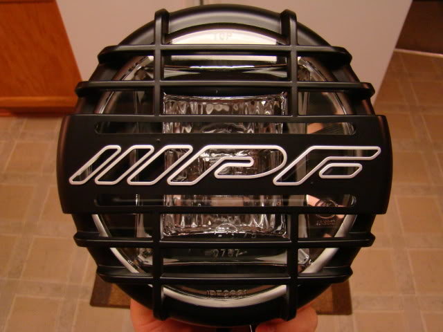

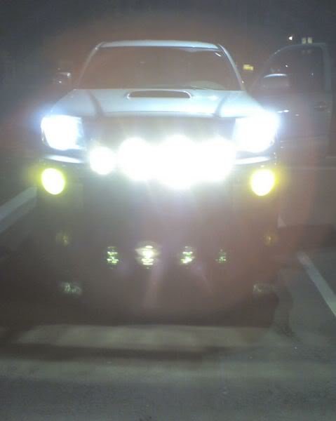

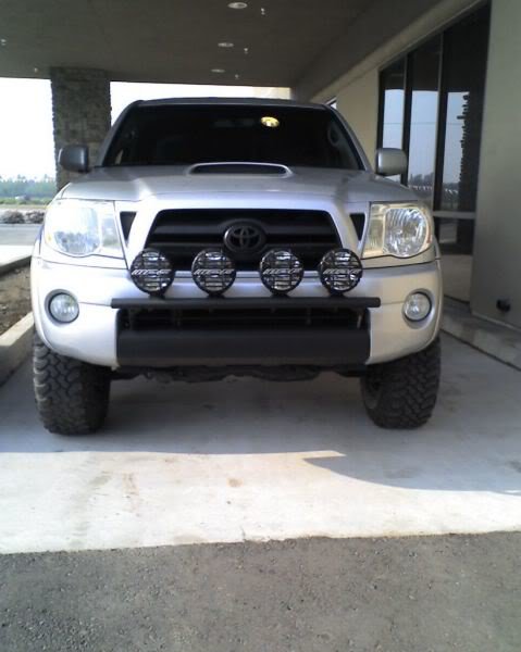

    Just installed 4 of these lights a few weeks ago and have gotten a few PM's on how they are quality wise and their performance.
    I gotta say these are some high quality lights for the price. You can find them online or from any ARB dealer. Average price I found was about $150/pair.
    They come with 2 sets of H3 Halogen Bulbs (55w and 100w). I never installed the 55w but the 100w are very bright and noticeable even with my HID 55w headlights turned on.
    Some have compared these to the Hella 500 lights because they are comparable in size and both have plastic housings but I have had both and these IPF's beat them in brightness and quality.

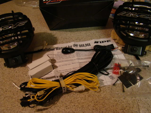

    Complete light kit included:
    - 2 lights with connectors
    - Complete snap together wiring loom & relay
    - Mouse style switch
    - Black Protective Grilles

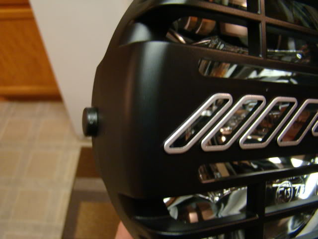

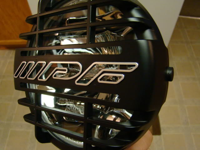

    The lights come with the IPF black grilles but they just slip-on over the housing of the light. If someone wanted to steal them they could with very minimal force and little time. You also have to worry about wind ripping them off so I had to come up with a way to secure them on.
    I searched my local Lowes and found these screw covers.

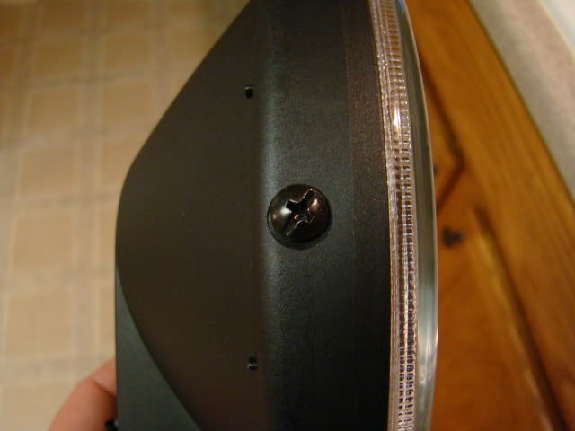

    As you can see in this pic the screw that holds the glass lens into the body of light is visible with the black grille on.

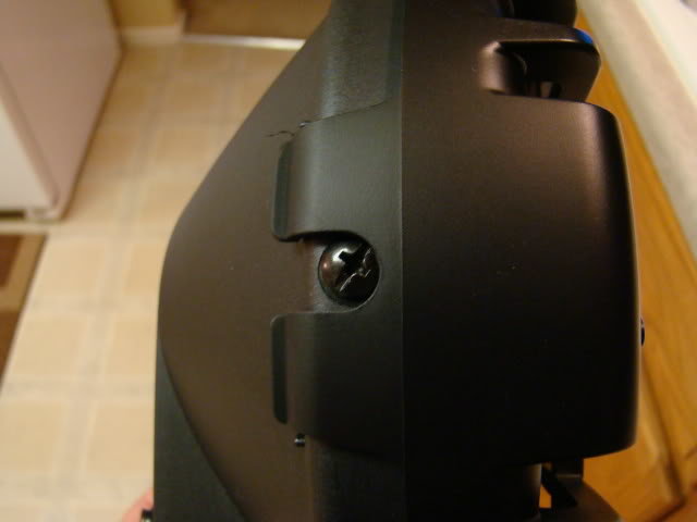

    Take the screws out and put them into the screw covers.

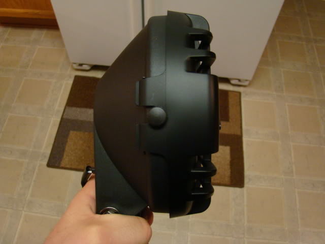

    ...then reinstall the screws back into the lights with the screw covers on. Tighten them down snug and you have a secured light grille. :D The screw cover is just big enough to clamp onto the grille clips without damaging or scratching the grille covers.
    The cap closes hiding the screw head. The screw covers are very difficult to open so I am thinking the only way to take them off is to cut off the head of the cap cover. Good thing they're only .68/pair!
    A couple pics of the finished product. Looks like it came from the factory with these screw covers!
