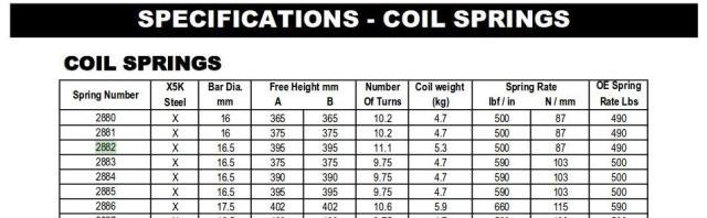

    Anyone else running 882s on Billies?
    Spring rate is the same as 881s...they are just 20mm taller.
    20 millimeters = 0.79 inches
