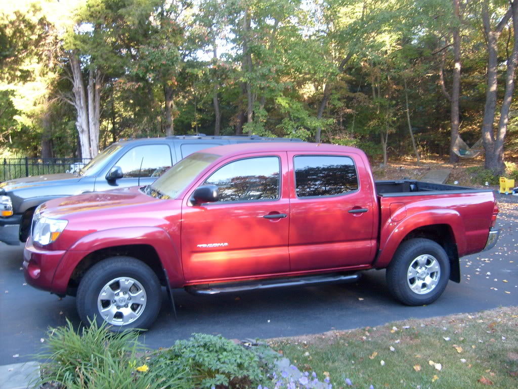

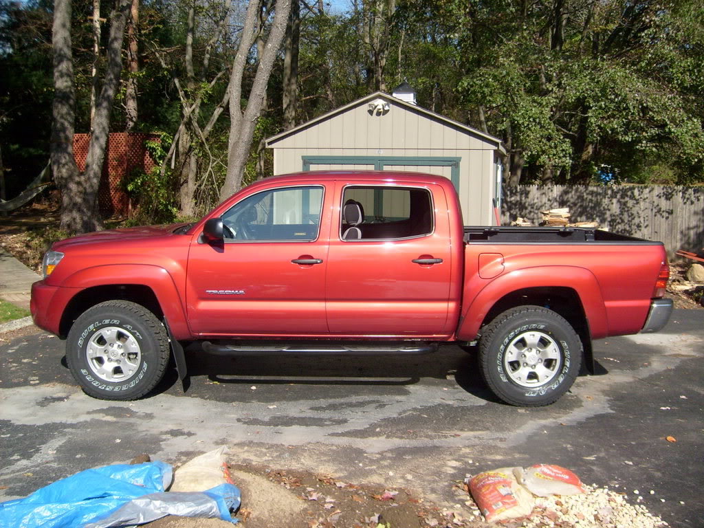

    Yeah, I know TJOPILOT has the 285's with the Toytec 3" and he had to trim just a bit. I have to recheck my measurements to see how close they are to his.S6300026_3096889dcb7a4db980c6fd3214b3455577a773c4.jpg
    my before and after

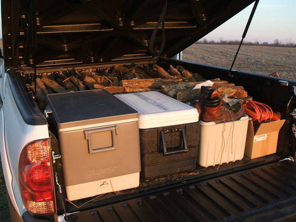

    I had the TSB done and it is firm but not harsh. Raised the rear approx. 1.25" running light. Just got back from a successful MO deer hunt and had all my hunting gear in the cab and two large coolers of meat and approx. 1 cord of firewood in the bed on the return trip to TX. Truck rode about even loaded this way and got about 18 mpg running 75 mph against a 35 mph headwind. I really like this truck compared to the '99 it replaced. The stops were about 1.5" from bottoming out.

    holy shit dude! that is one neatly packed bed! if i put all that in my bed it would look like a tornado just dumped a bunch of debris in it.
