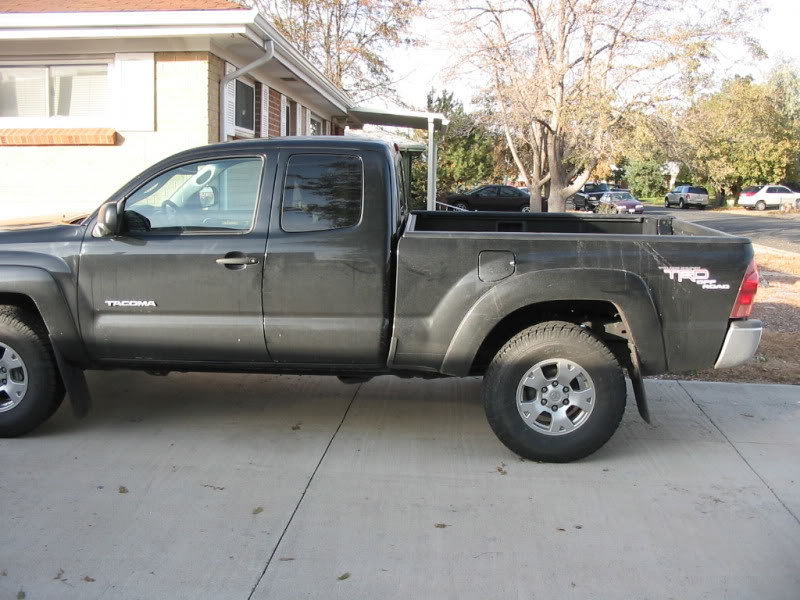

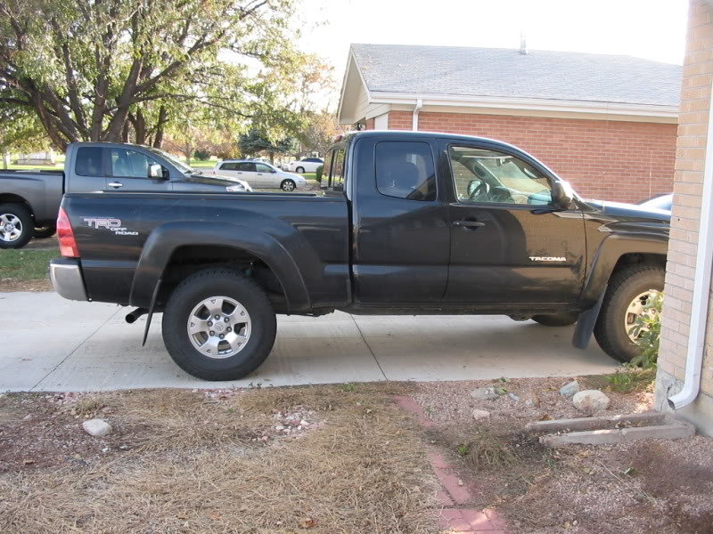

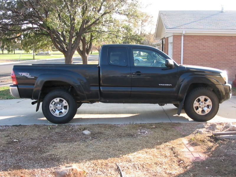

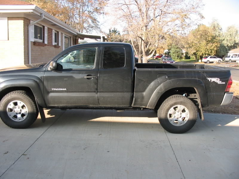

    Just got my taco back after getting the rear TSB done! Don't notice a difference in the ride.
    Before
    After
    Before
    After
