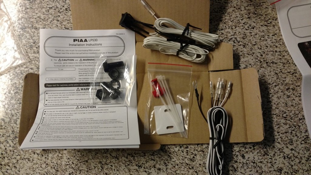

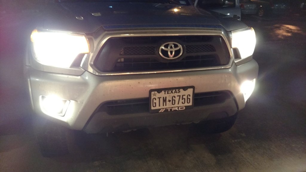

    Hey guys - I just finished installing a set of PIAA LP530 Foglights on my 2015 stock bumper. The kit is advertised as plug and play for 2012+ Tacomas.
    http://www.automatcentral.com/PIAA-LED-Tacoma-Kit.html

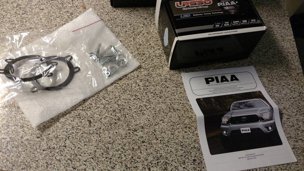

    The large box contains the LED light kit, Tacoma specific brackets, hardware and instructions.

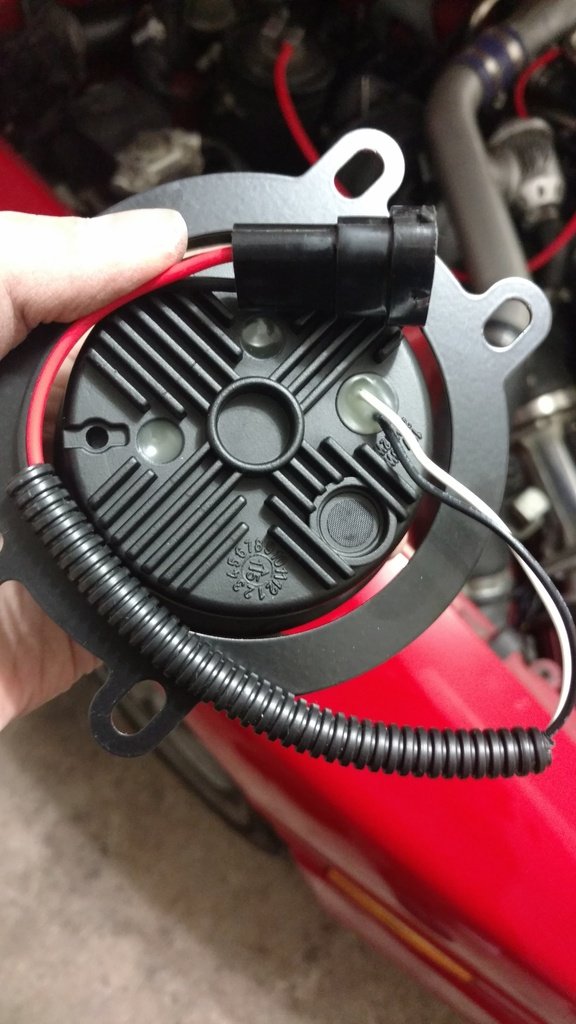

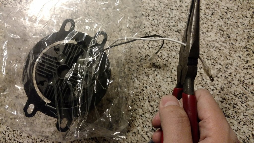

    The wiring comes inside the box with the lights. There's plenty of wiring to go from the cab switch to the lights and to a power/ground source. Everything you need is there, but it's not as plug and play as I thought.
    The included rocker switch was not visually appealing and if I wired it as instructed, my factory foglight switch would be inoperable and useless. I can't stand buttons that don't do anything, so I opted for a different solution. (I will also mention that the included wiring instructions showed a relay and different style switch, which were not included with this kit. These have a low power draw being LED, so I assume the inline fuse sufficed.) Regardless, I bought some H11 extension harnesses from Amazon, cut off the female end, cut the bullet connectors off the lights and soldered the harness on. This actually makes it plug and play and I keep my factory switch working.
    IMG_20161228_172412890_zps3quilghc_22ca03c497fdb3ee44a9e195a50b40ef7d7dc79d.jpgIMG_20161228_190018848_zpsh9rs8tzn_57908637aa4e27f425d876a5f7cf3ea09f97049f.jpg

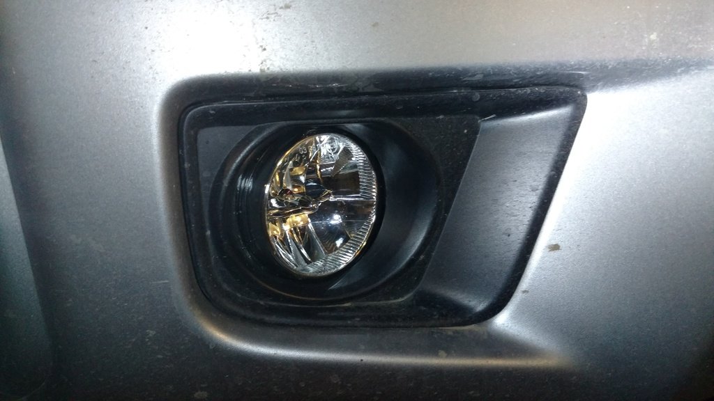

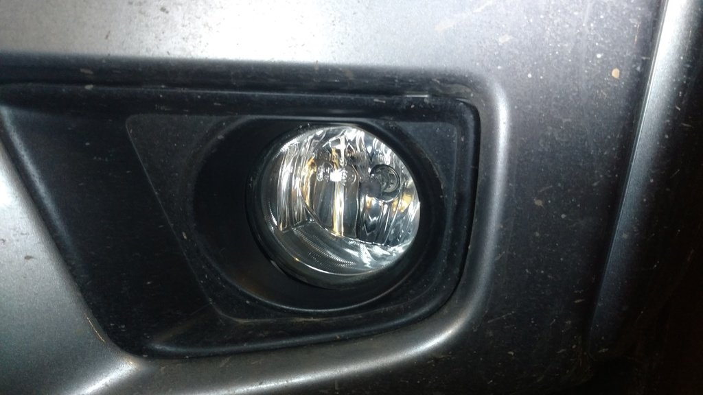

    The install was pretty straight forward. Take out 3 screws holding the fender liner in place, unplug the foglight connector and remove 2 screws holding the light in the bumper. The new one goes in with 4 screws (the two inboard screws include a spring to aid in adjustment).
    BEFORE - OEM Halogen Foglights

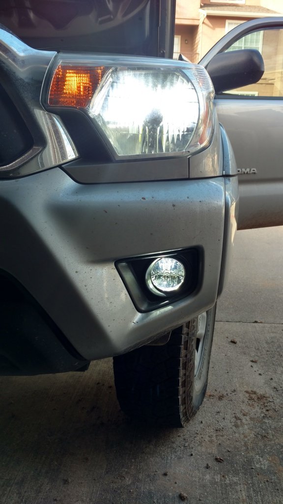

    AFTER - PIAA LP530 LED Foglights

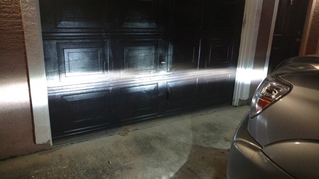

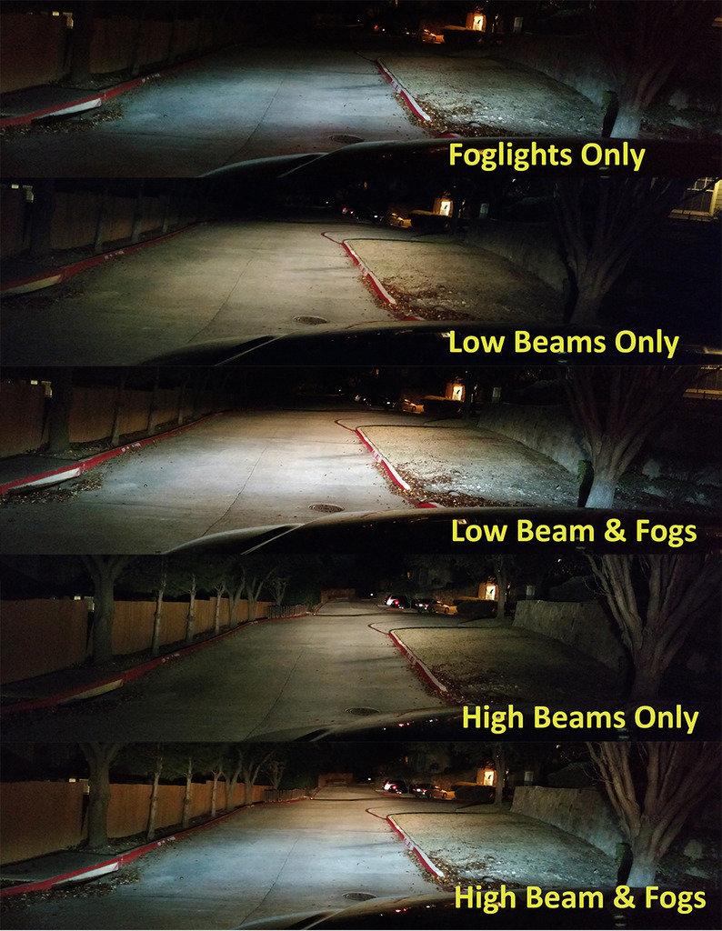

    Here are a few other comparison photos

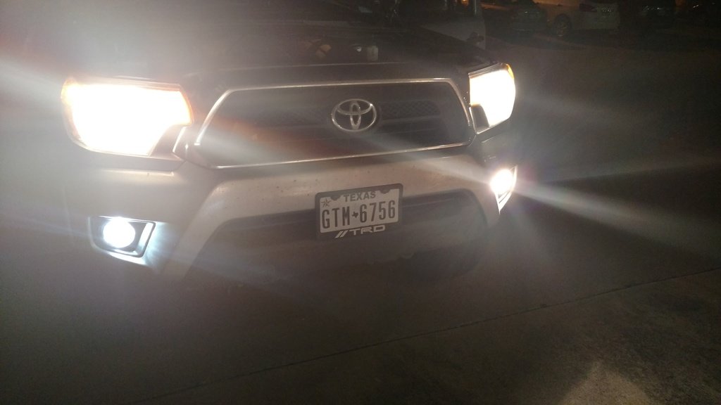

    ***EDIT: Here are more comparisons after I installed some Rigidhorse H4 LED's in stock halogen headlight housings.***

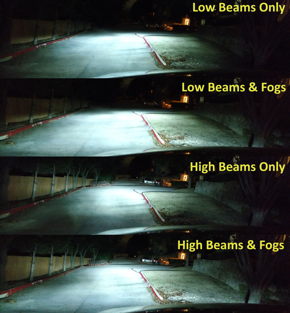

    After a quick drive around the block I can really notice the white of the LED's versus the yellow halogen headlights. I did the Foglight Anytime Mod, so using the LED fogs with the High Beams really helps to light up things both near and far. I may have to tinker with aiming them, but they seem to be an improvement over stock. I really like them so far. Besides the wiring, I really have no complaints. Well, maybe one other...now I'm going to have to get retrofits or LED's in my headlights so they match the fogs. I really like the color and output of these fogs. If you are looking to replace your stock fogs or if you didn't have any to begin with, this kit will have you covered. Easy install, great price and the quality you'd expect from a name like PIAA.
    Thanks @automatcentral for the opportunity to review these lights!

    awesome:thumbsup: the white LED looks great, and the lights are Tacoma specific looks OEM but far better. the pictures show a lot of added light when they are used with the halogen hi/lo s

    Thanks. Those do look really blue in your pictures so im guessing the 6K temp is about right. But then digital cameras never really represent what the eyes see at night.
    XB's have a slightly lower temp, prob not noticeable and more lumens. Thanks for the reponse and write up on these.

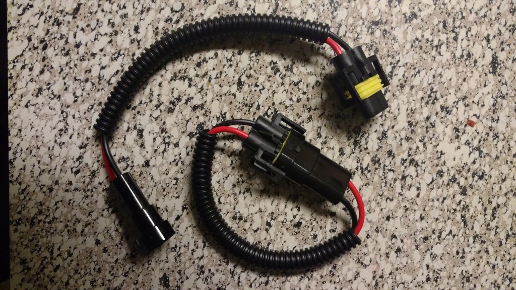

    You mentioned an inline fuse being used but I did not see one in the pics you posted? Reason I am asking is because I want to wire in LED fogs to replace my OEM ones but I really want to keep that factory switch.
    This setup will allow me to do so once I cut the female end off the H11 extension harnesses, splice in the fog light and connect the male H11 extension harness into my factory harness, correct?

    The harness that came with the lights had an inline fuse using an old style glass mini fuse. You can barely see the white plastic housing near the twist tie in my first pic that shows the harness. If you're wanting to reuse the factory switch, just buy the harness adapters and cut splice connectors at the fog lights. You don't need to add any other fuse for factory switch.
