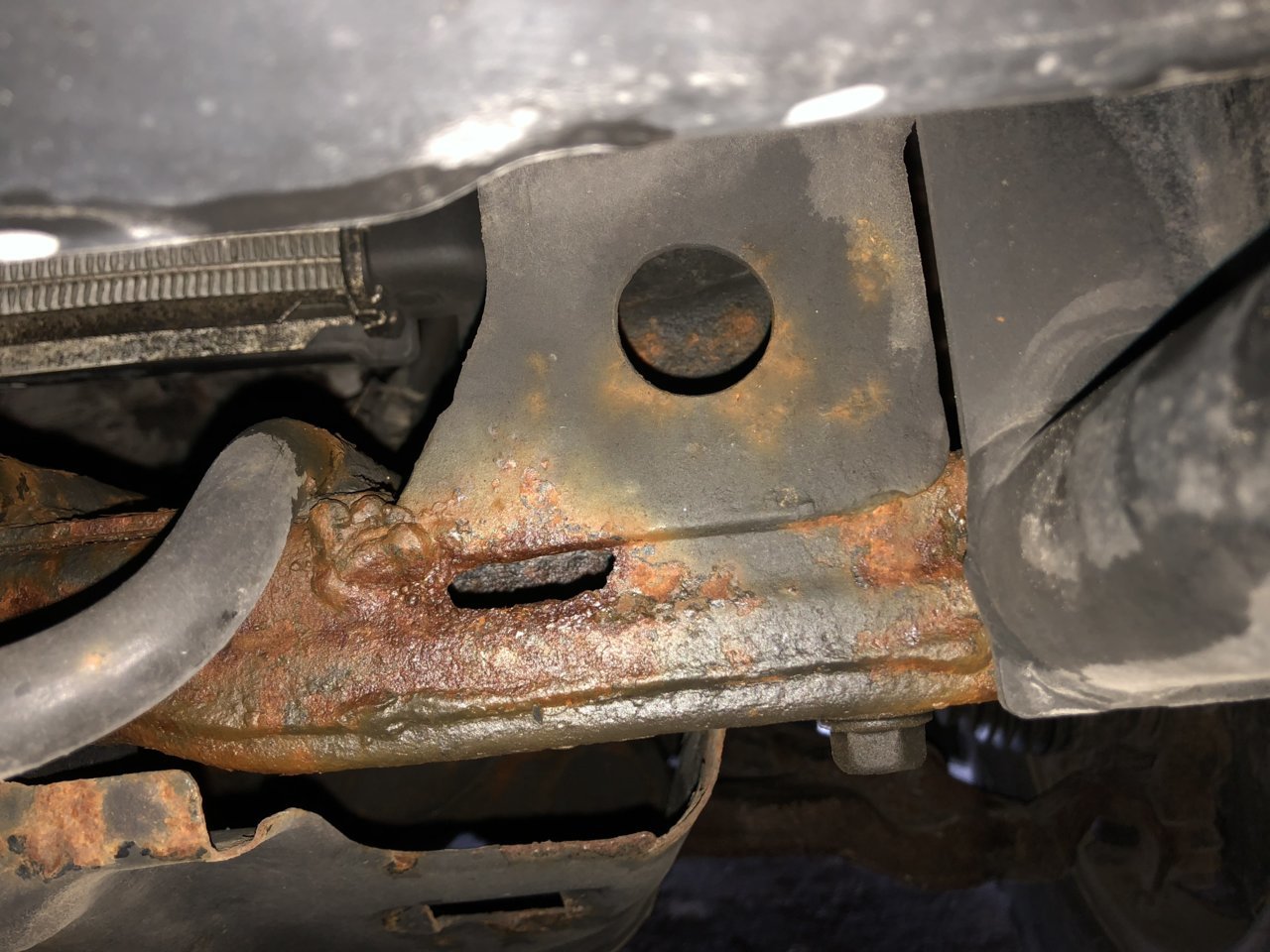

    Update-
    Just back from the inspection. They found a few holes in the frame that exceeded 10mm. New frame on order. They wouldn't let me drive it off the lot. I probably could have insisted but my head was spinning a bit. They gave me a new Tacoma, said it would be a couple of months to get the frame and install it. Would do new brake lines and anything else that wouldn't easily switch over. My warranty expired in May f this year, I feel like I dodged a bullet.
    Now that I'm home and have had a chance to collect my thoughts I'll have to figure out some kind of tarp to cover the bed as I work out of the truck. Also the loaner is a short bed but I'll accommodate it somehow. Beggars --->choosers and all.
    Here's one of the holes, just below the drivers side door and visible without it being on the lift. And this shows the general level of rust all over the frame that made me even think of getting it inspected.
