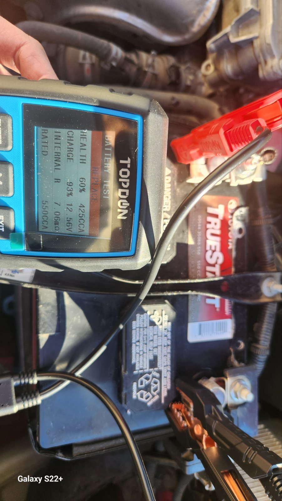

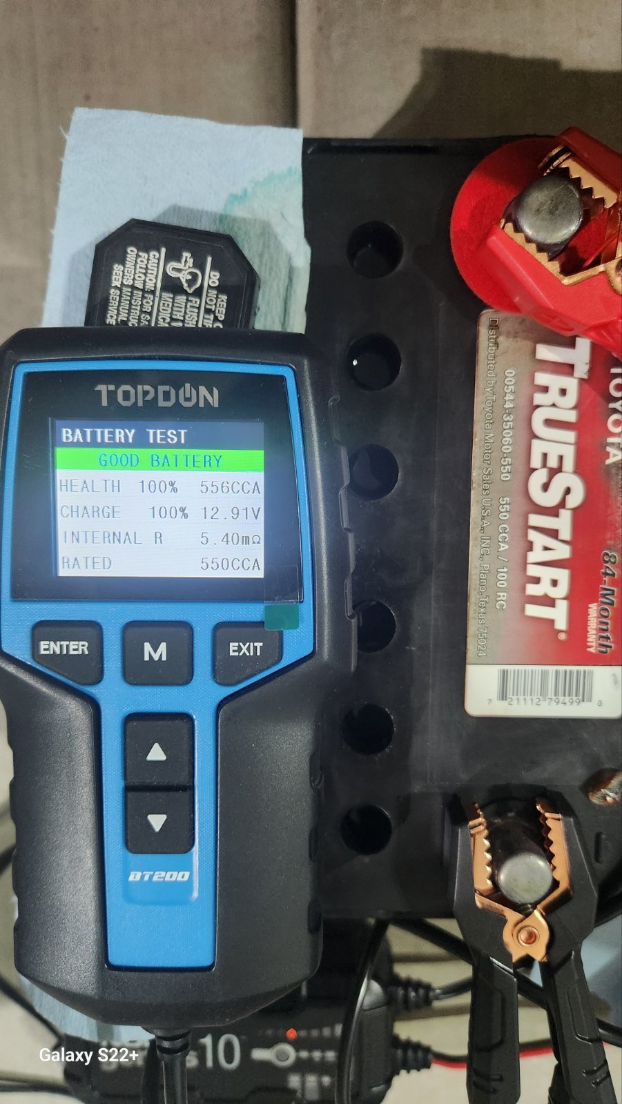

    Hi all, so my wife's Rav4's battery was getting weak during the winter so I just replaced it before things got worse and wife gets stranded.
    I tested the old battery and it was not completely bad, some cells were getting "dry" so I added distilled water and I tried doing a "repair" using my Noco 10.
    So far, health has been restored to 100%, but the internal resistance is more than 5mΩ.
    How do I go about reducing it to lower than 5mΩ?
    I have run the Noco 10 (repair mode) about 1 to 2x a day for more than a week now.
    Thank you

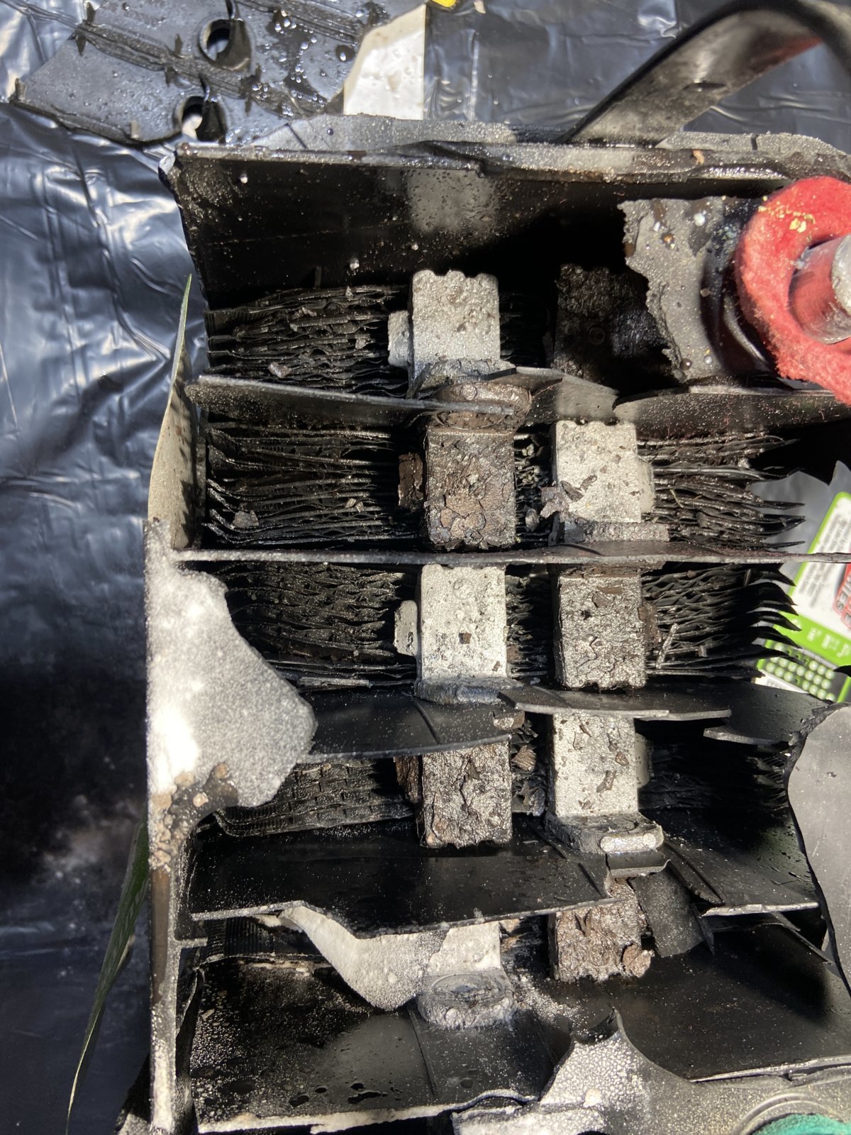

    I say go for it! If the battery gets fuckered who cares? I guarantee you a battery can't get more fucked than mine and the battery place took it as a core without question. (yeah that's the battery from my wife's car. if you look close you can see the build up on the plates. https://www.tacomaworld.com/threads/the-battery-just-exploded.822906/#post-29512469/ )

    Now to get the CCA out of them to start a modern engine they have tons of thin, frail lead wafers in them that don't do well with all of that attention. Plus if you rinse a battery out now, you will see how much lead comes out in that process. It's not really plates as much as it is a screen that's lead plated. Once those screens warp and start touching you lose capacity to hold a charge. Once they start sloughing lead off in the acid they start losing the ability to take a charge.
    I'll tell you this much. If you can do it in an environmentally responsible way... It is worth it to play with it and learn and try different things to see how close to original spec you can get it. Eventually rinse it clean and (USING EYE PRO) put an angle grinder on it and dissect it. But it is a tool for education now and not a tool for dependability.

    The first thing you should do is get a battery hydrometer and check the specific gravity of the electrolyte in all the cells. If one or two cells are way out of balance, then yeah, what everyone else here already said (lead sulfate most likely has shed from the plates in those cells, which cannot be recovered).
    If the cells all check out the same though (within a few hundredths of each other), then I'd say stick it in your own truck and run it (not the wife's car though, just in the off-chance something does go wrong with it). The fact that it's at 12.91V (assuming that's after leaving it sit overnight) says the battery's health is pretty good. 5mΩ also doesn't seem bad for (what I assume is) a 24F-size flooded-type battery.
