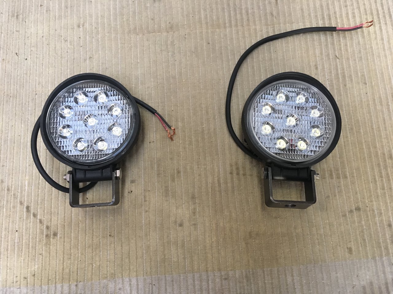

    I just mounted these lights on my light bar. They're wired up via relay with a switch, and are hooked up to only work with the high beams only. The relay only energizes if the high beams are on AND if the dash switch is on.
    The lights work well, but the radio goes to complete static when the lights are on. Does this make any sense? I don't have a pic with the new lights mounted, but they're just inboard from the KC's.
