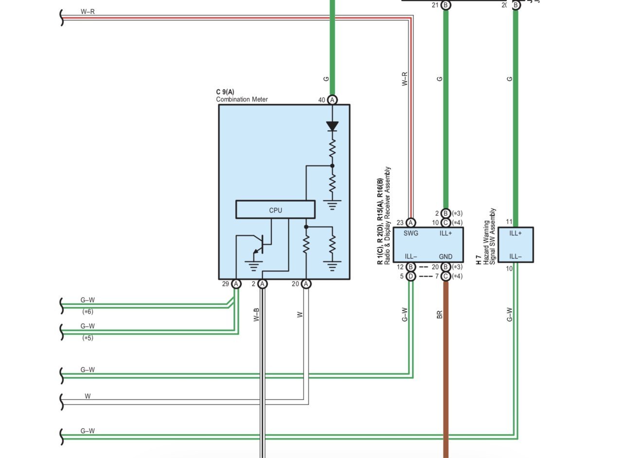

    The dash has its own ground.
    Maybe @Jimmyh or @Muddinfun will know if this will allow the dash lights to work with no dimmer plugged up?

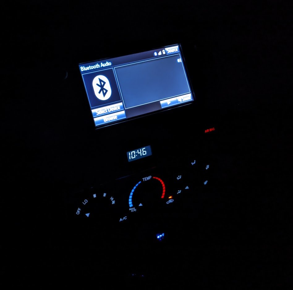

    Also now noticed that the radio dials and buttons do not illuminate. Possibly a problem connected with this?
    This is what I see in the dark with my lights turned on.Is this normal for a base Tacoma? Makes it nigh impossible to use the radio in the dark.
    Bought the truck just over a week ago. I'm taking it back to the dealership. I shouldn't have to deal with this.

    The Hazard lights operate off the dimmer.
    As do some of the the radio Controls.
    Look at the picture I posted above.

    The hazard works fine. It's just not backlit. Same for the radio controls. Just can't see 'em at night :)
    The dealership does not see a connection between the 3 issues.

    I was referring to the bulb in the switch and the radio controls.
    Not the actual lights themself.
    If the dealership can’t see a connection, I would find a new dealership.
    The connection between all the things you just listed are in the picture of post #22 above.
