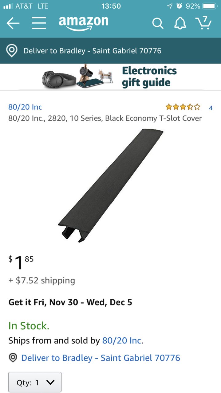

    What you think about this. This is for t-slots trim it’s 7/16” wide on the top and the clip in part at max width part is 5/16” wide. It comes in a 6” stick. I think this could work huh?

    The Rhino ditch track has a slot opening 9/16" and interior slot dimensions of 3/16" x 7/8". There's a second rib below the slot ~ 9/32" from the top surface to the bottom of the rib so I'd have to say it looks to be too small. If you find another trim 1" ( 25 mm) wide with ribs that are 1/2"(12mm) mm wide and the grab points are 5/8"(15mm) or more wide and at least 5/16"(~8mm) below the top cover then a solid maybe. Your other post made me think of the rubber strips which might be easier to find or even make. I definitely want something in there since my install of these doesn't leak at the car wash or in the rain but the topper tracks that came with the truck do.

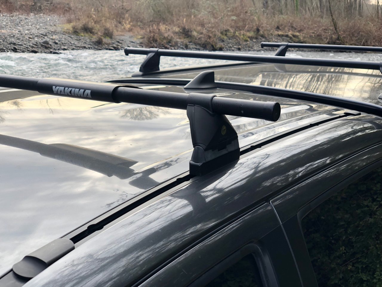

    Just piping up here to mention how awesome these ditch tracks are. Love flexibility of mounting, and the integrated look. I had them installed at rack attack here in portland.
    I added these so I could have a yakima round bar, or two, over the cab that were level with the round bars on the canopy. To make them level, since the top of the cab has an arched curvature, I used yakima landing pad 1s with some solid blocks of black plastic (cut down on a table saw) with longer bolts to reach the plate in the track.

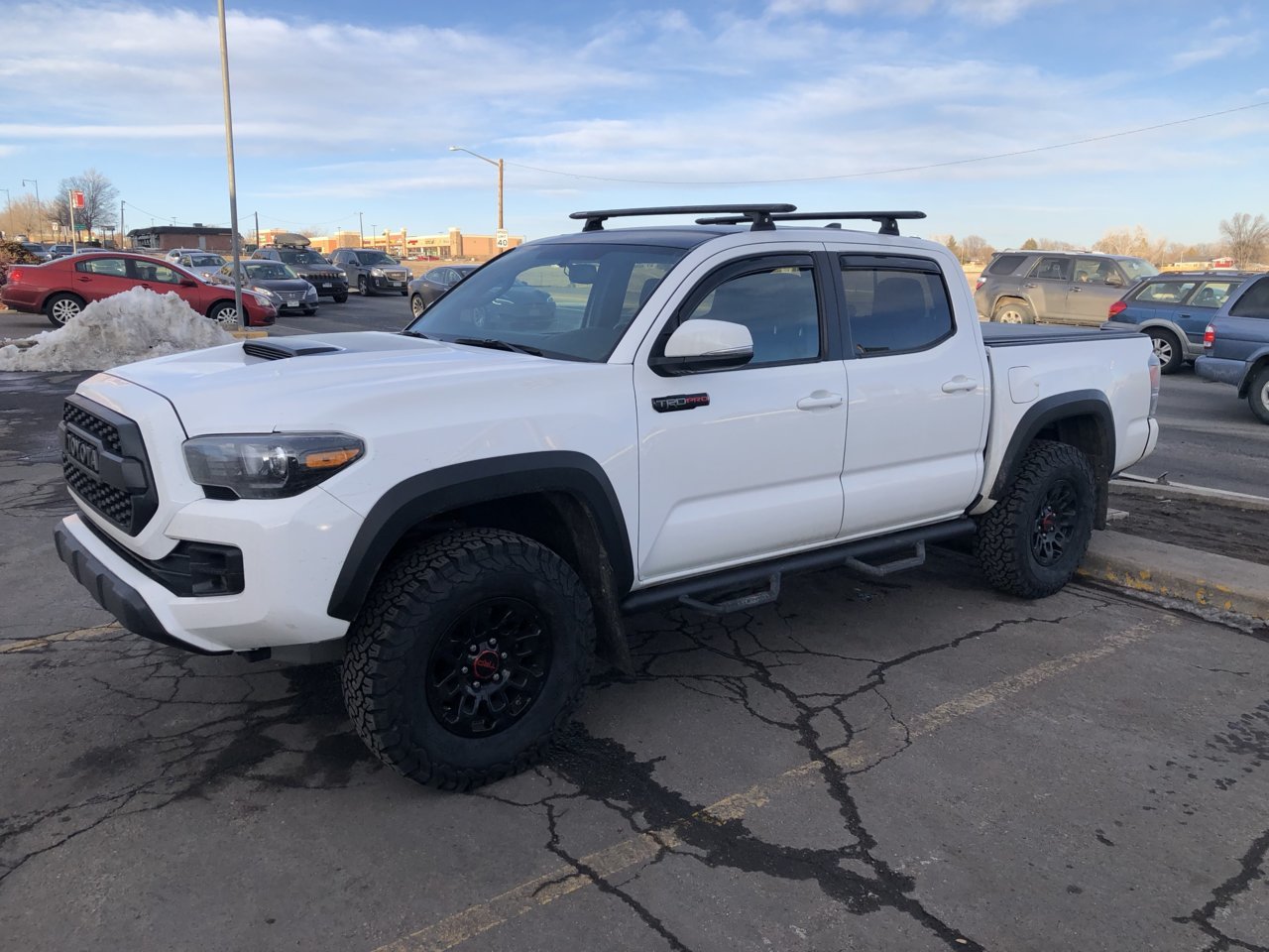

    Jan 22, 2019
    #280232
    229
    Denver
    2017 Tacoma TRD Pro
    BFRT_King Ranch likes this.
