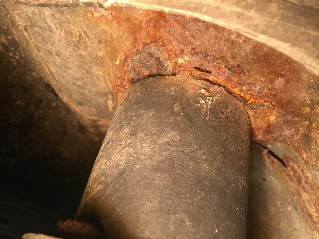

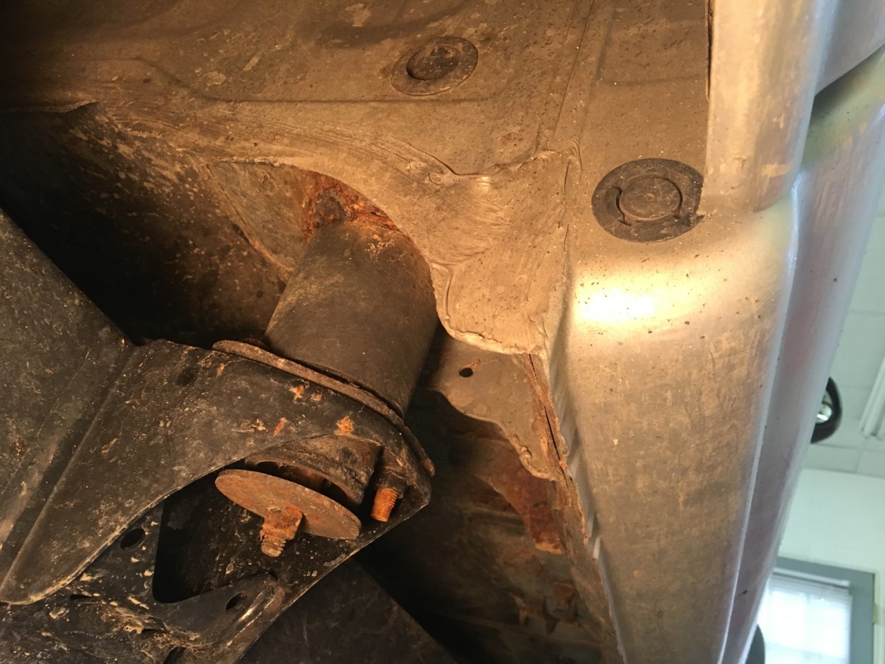

    I only took one picture of the worst one, but they’re all similar. 6 cab mounts in total. I took it further away for perspective and then closer up. The front two (close to the bumper on the same support as the hood latch) don’t seem bad at all, probably just need the surface rust cleaned. The 4 which look similar to the picture are pretty crusty. The one pictured has a small hole in the metal itself so it’s only a matter of time.
    The mounts look like sheet metal formed to accept the cab mounts and then just spot welded to the body. There is currently a 3” body lift on the truck that I want to remove once the rust is sorted since it provides more access.

    Wow, I would just por15 those and do some body filler if you dont plan on holding in to it. The fab guy I use, would do the CAB MOUNTS not the body portion.

    Yeah, the frame is new like I said so I’m hoping to get more out of the truck. Mechanically it’s fine. Be a shame just to ditch it over what doesn’t seem like that big of an ordeal. Cheaper to fix it than buy a newer truck at least.

    Fair enough - they cut out the rusted area and welding in metal for mine (easy to know using the magnet test)
