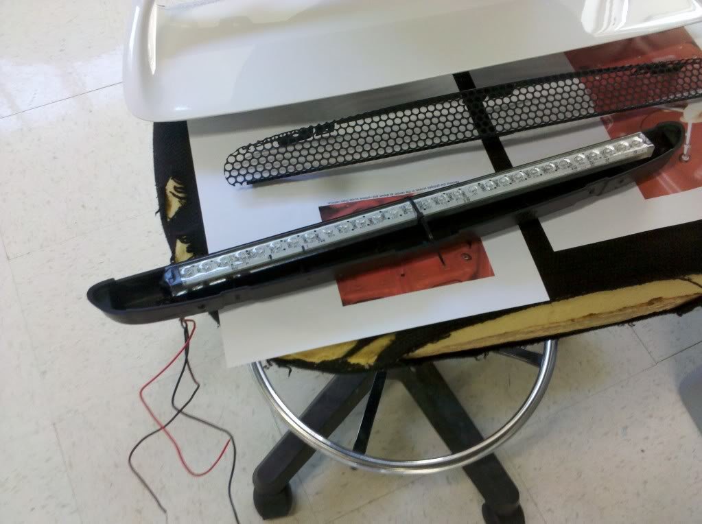

    So Friday I hooked up my LED scanner bar in my Hoodscoop. Saturday I wired it into the cab. I took some pics just in case it helps some folks who need to get thru the firewall and people who are looking for some awesome rockers for their open spots on their panel. I searched and searched on here and got some good ideas getting thru the firewall but I didn’t want to cut into the boot or force a hanger thru. I found a kickass opening that worked perfect.

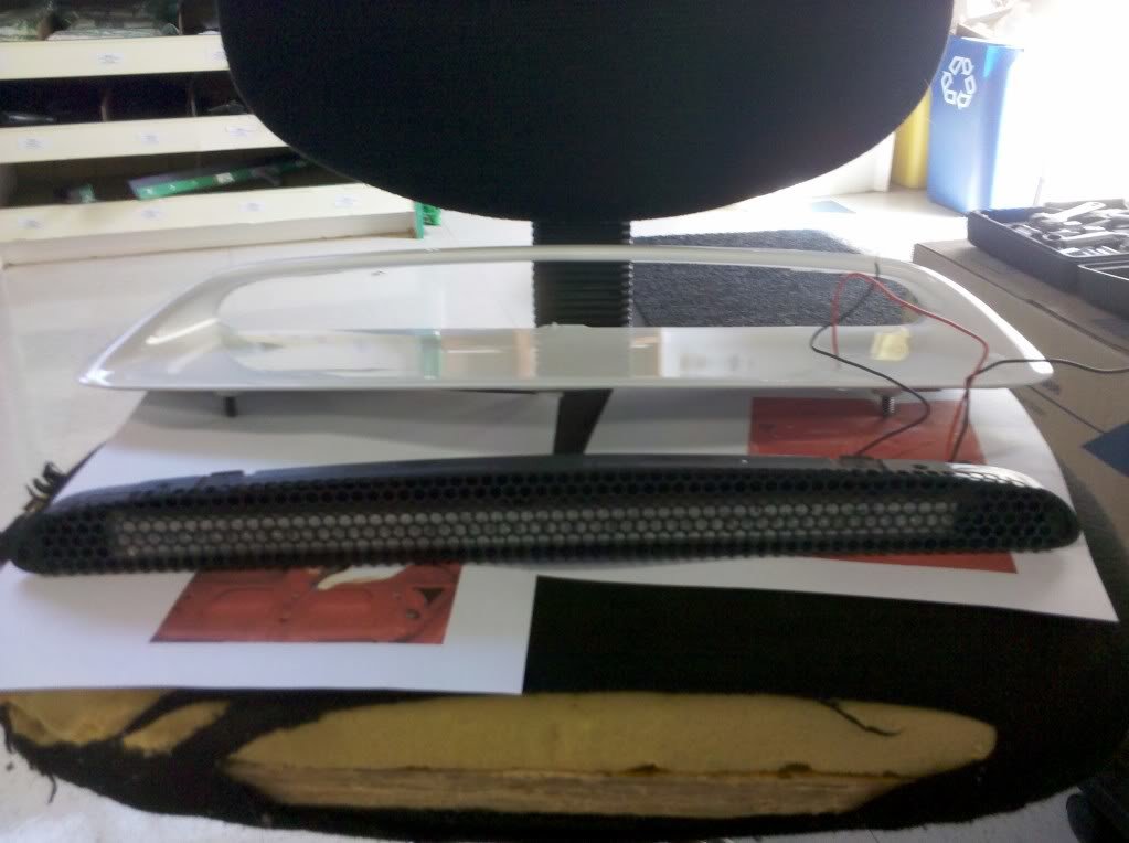

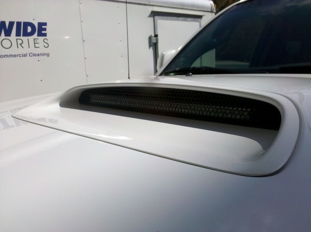

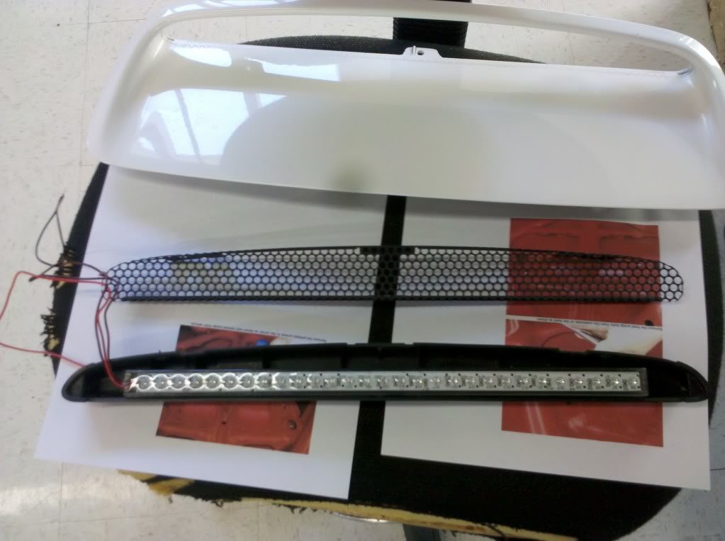

    Took the hoodscoop apart:

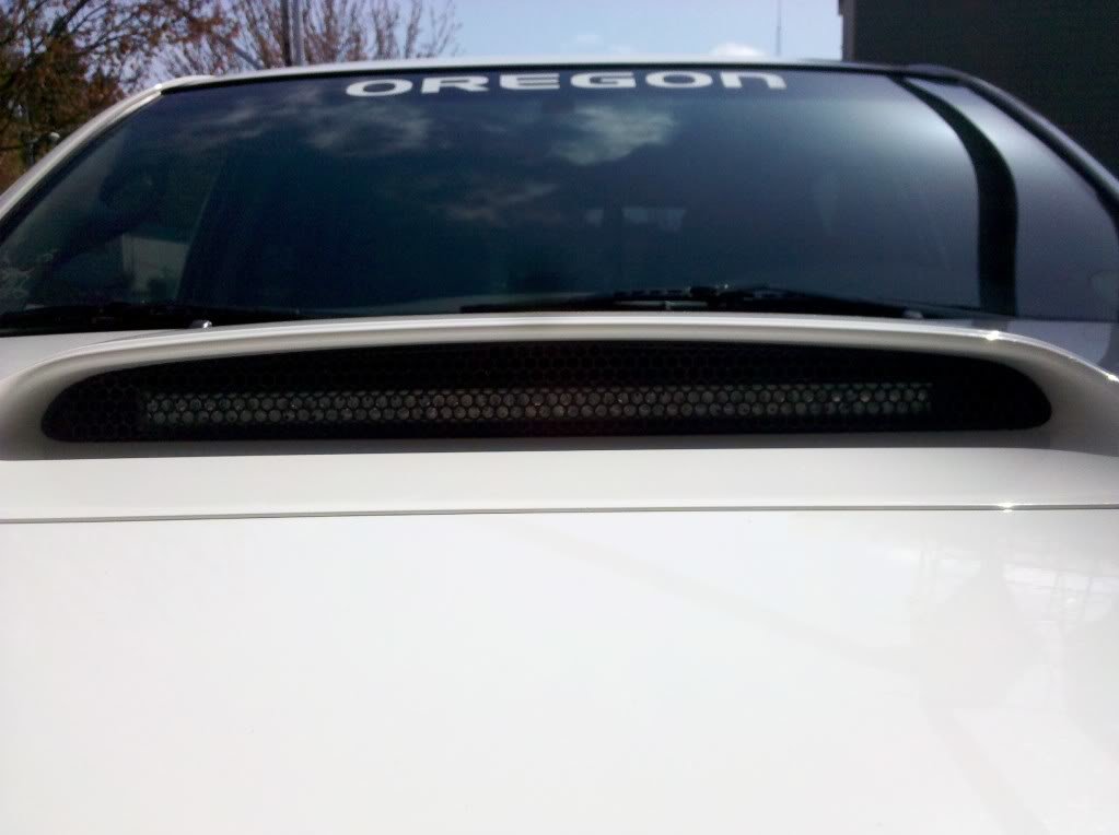

    Got light put in and got the scoop back on the truck:

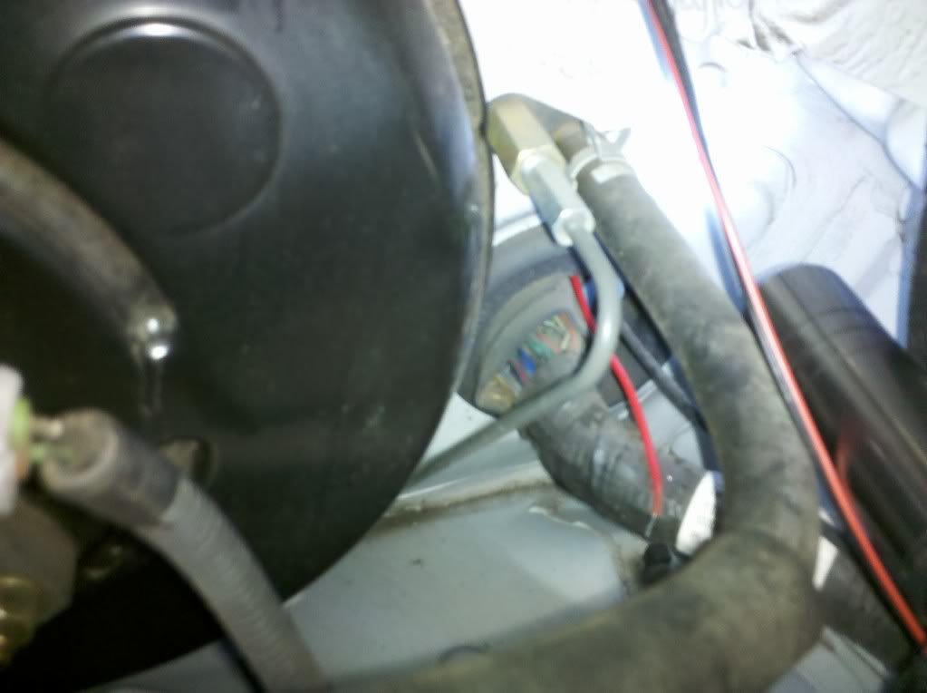

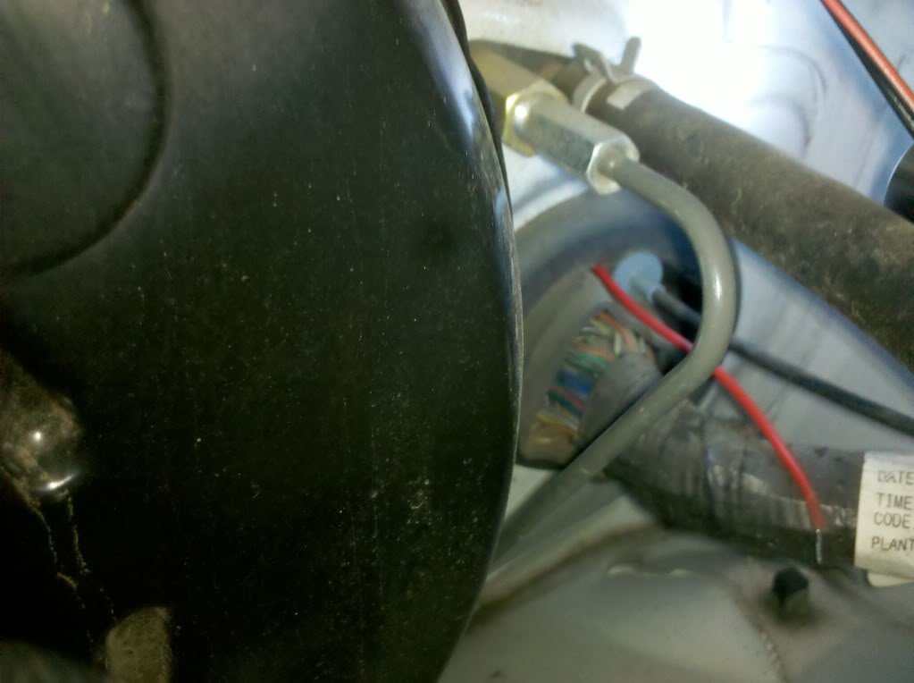

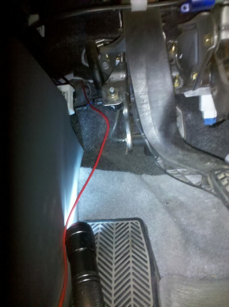

    To find an opening without cutting or poking, I put an LED flashlight in the engine bay pointed at the boot, then I got inside the truck and saw the light shining thru a small opening. I pushed the wire thru and it was perfect! I taped other wires to the red power wire and drug them thru with no problems or hangups.

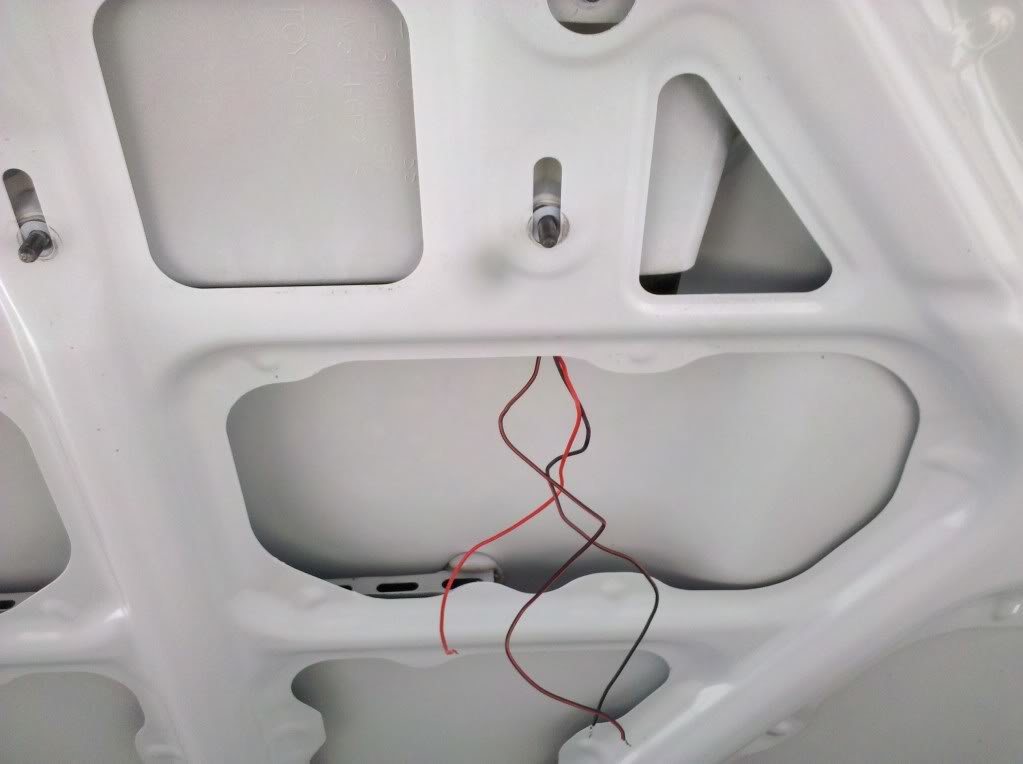

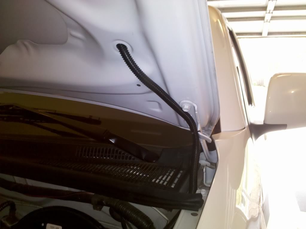

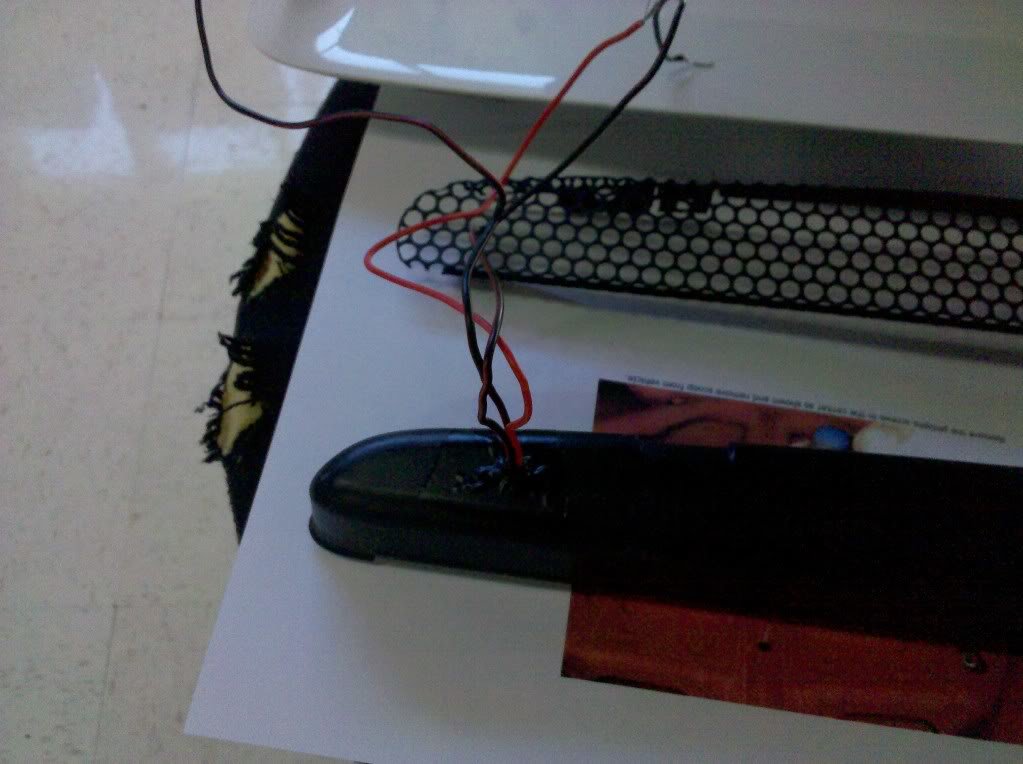

    Ran wires from hoodscoop thru the hood down into some wireloom:

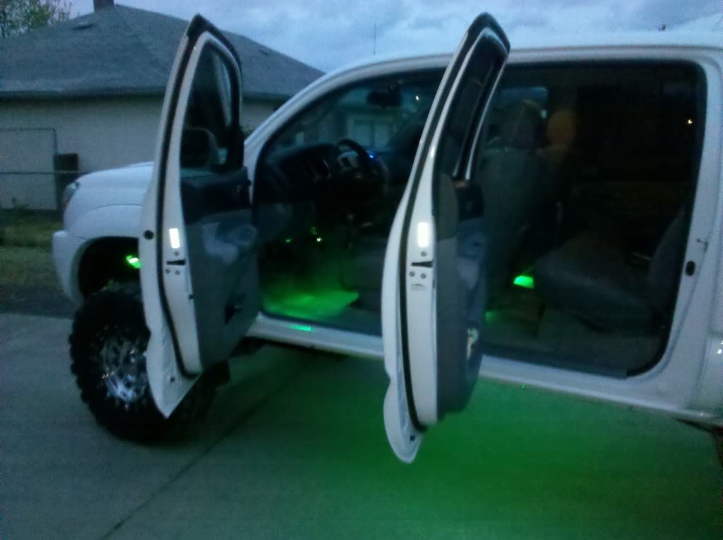

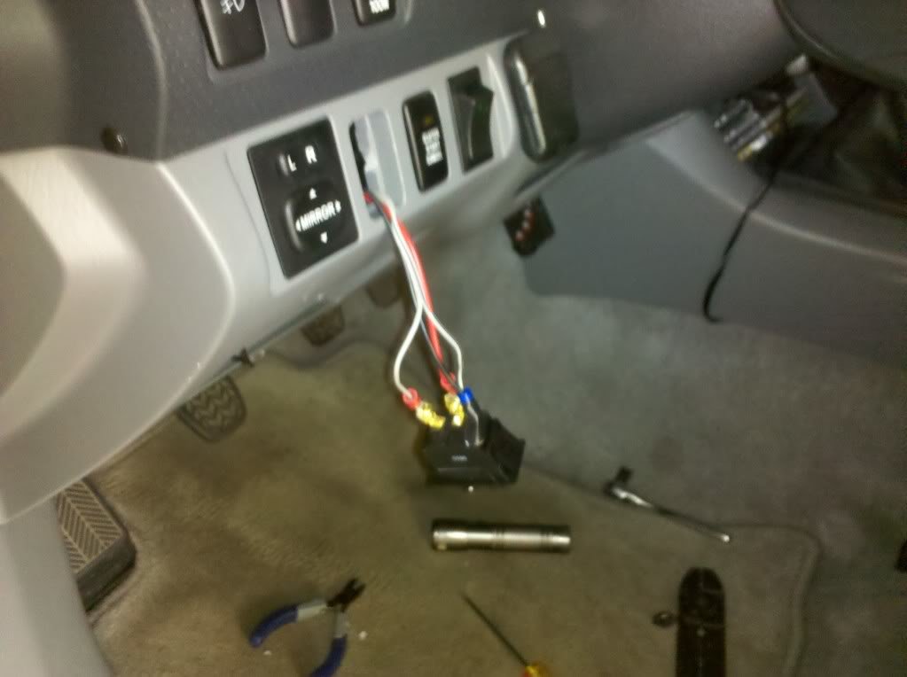

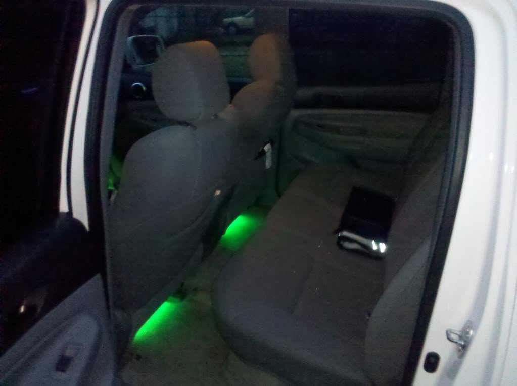

    Bought 2 of these http://www.oznium.com/scion-switch-led

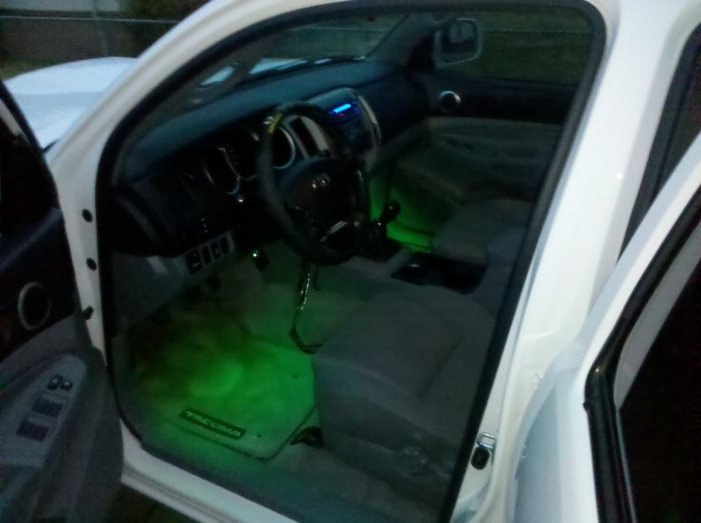

    1 for the scanner and the other one for the LED's under my foot wells and under both seats.

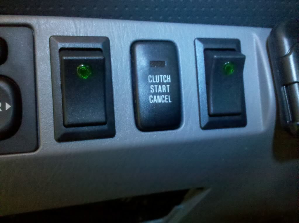

    They are for a Scion but they fit AMAZING and look factory. I had to take a razor blade and shave off the left side plastic in the hole. Then they went in perfect.

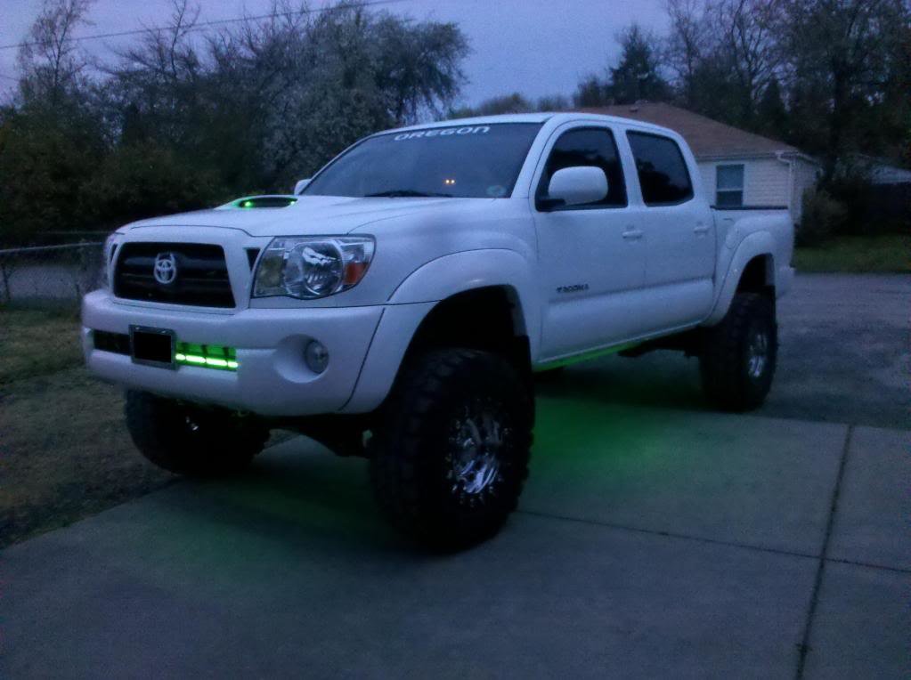

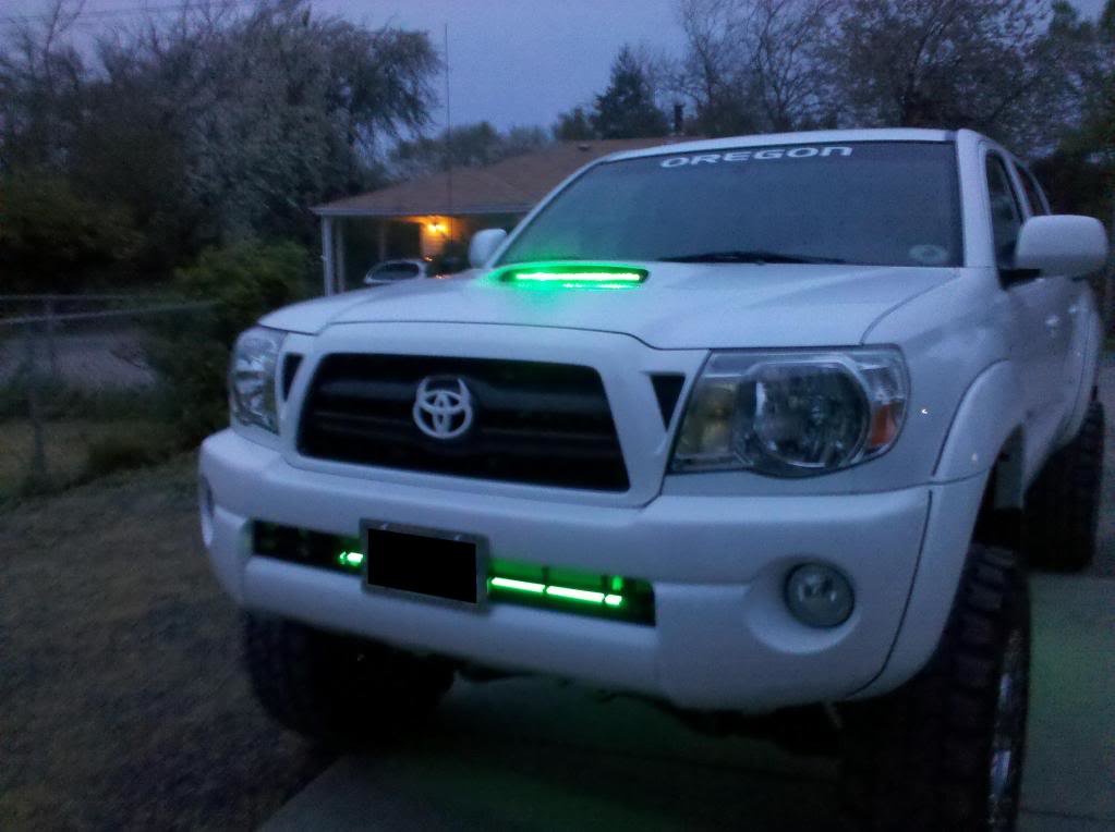

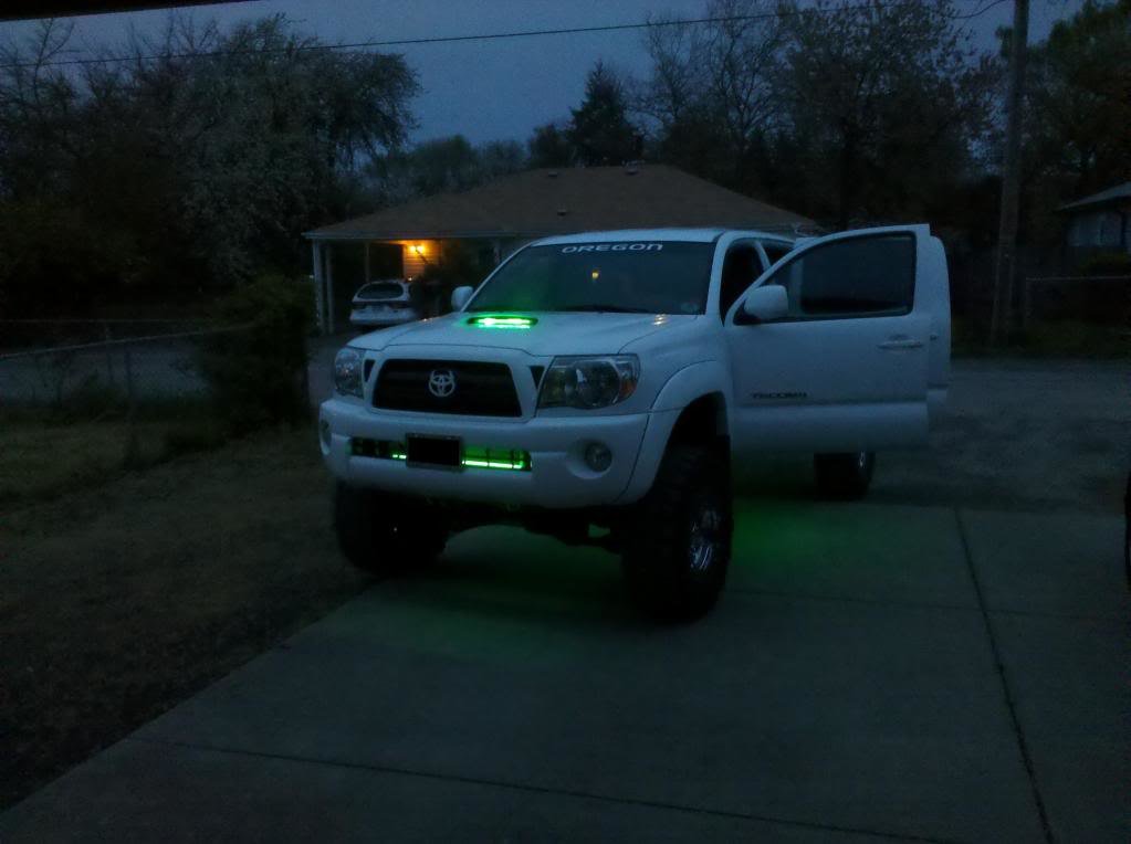

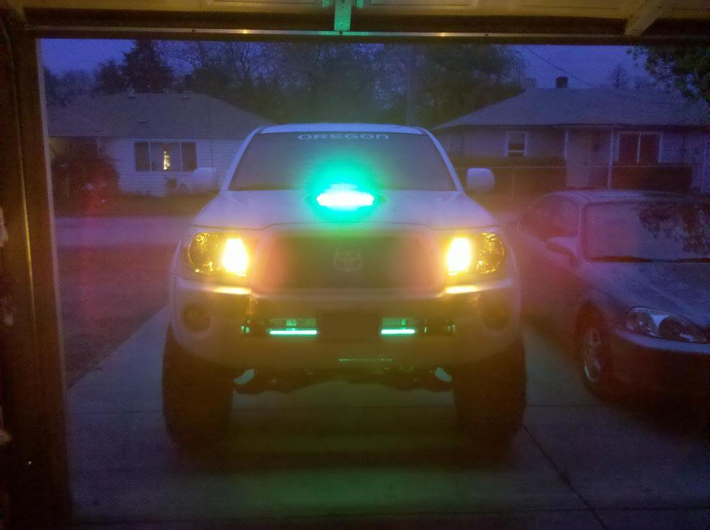

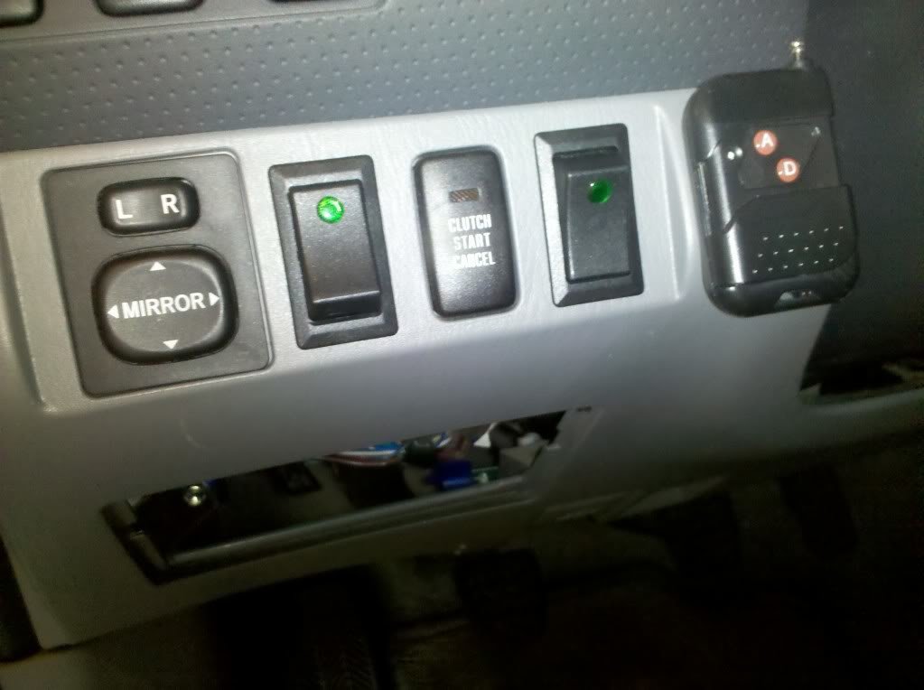

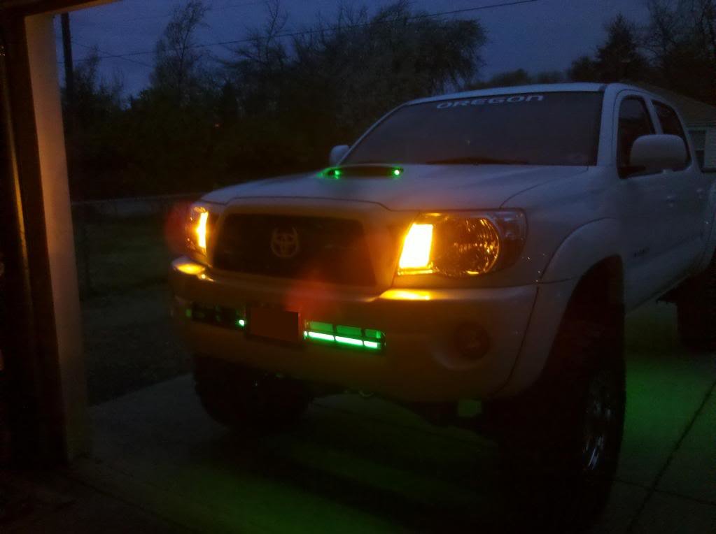

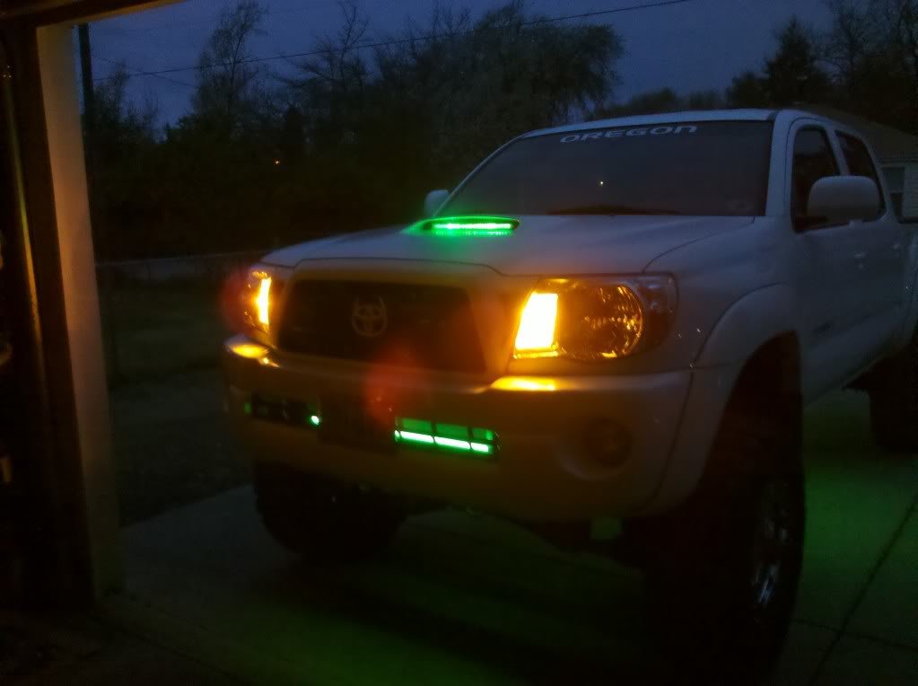

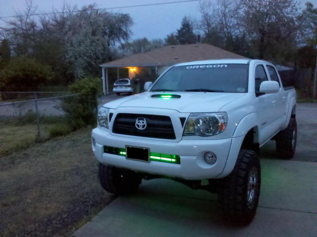

    DONE! Now for the finished "RICE":

    It is a scanner. Same stuff as the HOFF and KITT...LOL...!!! If you look at a few of the pics you can see the bar all lit up and in other pics u can only see a light or 2 because it's always scanning back n forth.
