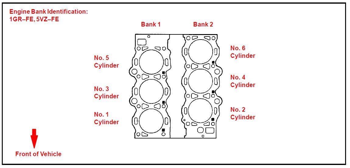

    Which side is bank 2 again? Passenger or driver?

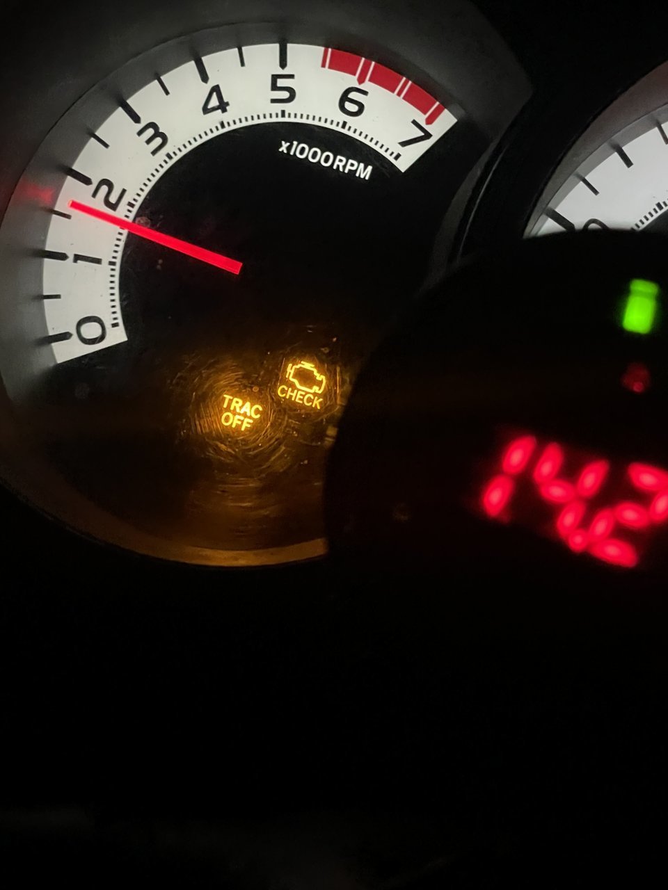

    Attached is a picture of the CEL and Trac off light. Whenever the truck throws a code the trac light comes on as well, weird. Sometimes I need to delete the codes in order to use cruise control.
    Again I can give you guys the full run down tomorrow. But I can leave this with you for now. What do you thinks going on? Maybe an unmetered air leak.

    Thanks for the diagram, I’m gonna check the Maf, make sure it’s oriented correctly and not dirty. Maybe even swap the up stream o2’s and see if the code switches from a p2198 to p2196.

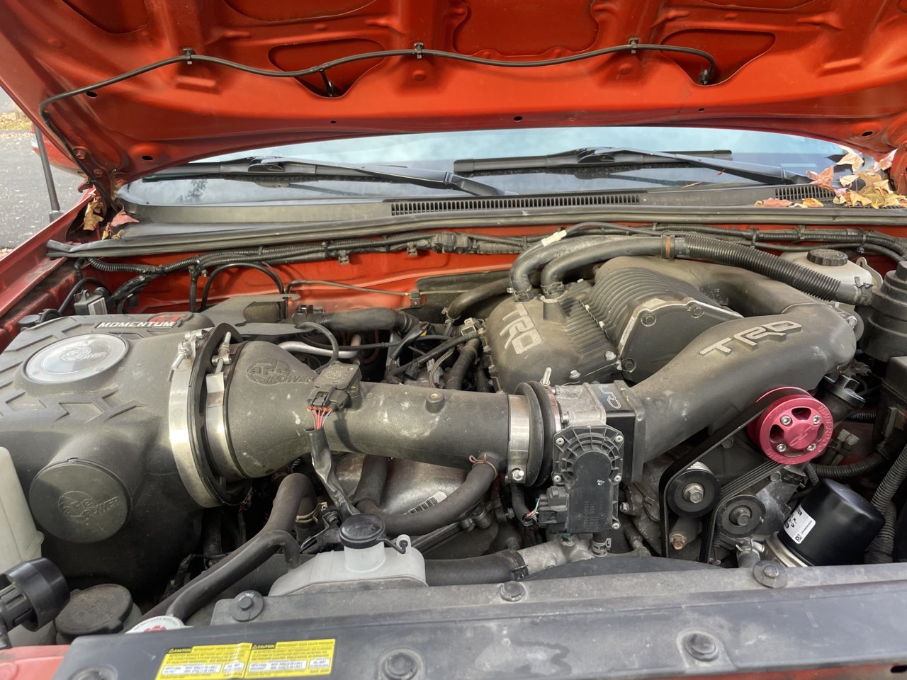

    I’m using a Momentum GT made by aFe, no K&N here. Stock intake gone (good riddance). No air filter oils either, not a fan of those. Picture below of the set up. Also using an aftermarket computer sold by URDUSA.com, forgot the full name but it’s a v-2 something. Just trying to give as much information as possible for you guys.

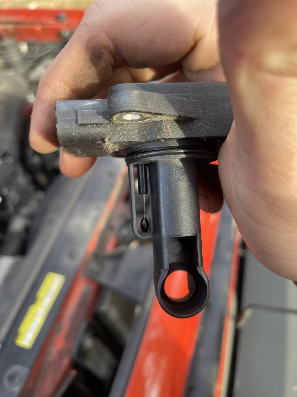

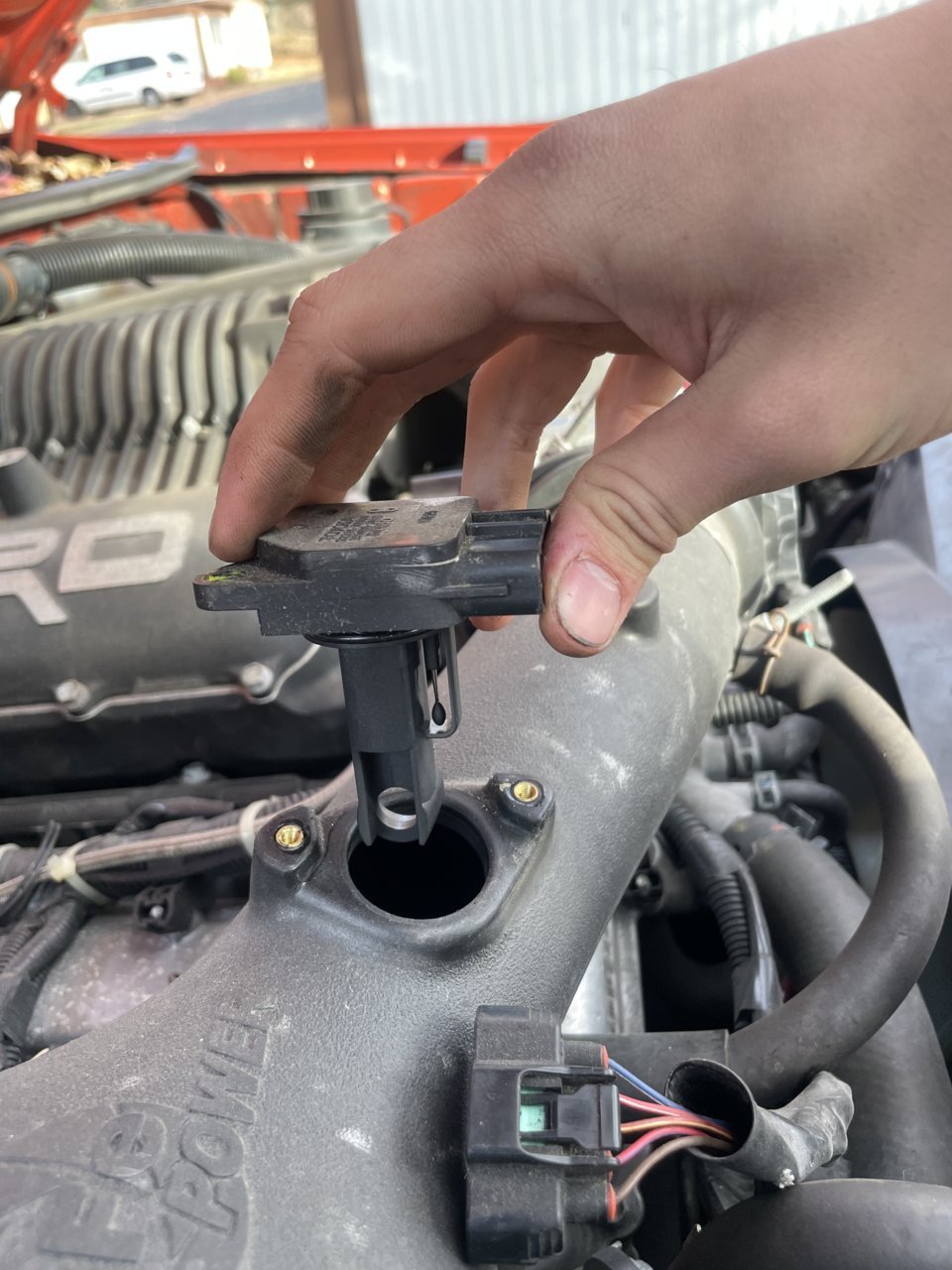

    Pulled the maf. Definitely dirty, Gina give it a clean, here’s some pictures for you. Wondering if it’s possible to put theses in backwards? Like if an aftermarket mount for the existing maf was oriented incorrectly putting the maf in wrong cause some issue for the sensor? Here’s 2 photos of the maf. First photo is the sensors orientation in the intake tube. It is pretty dirty… haha

    They definitely can be installed incorrectly and will not work properly if installed incorrectly.

    Interesting. First post, picture shows my AFR gauge. So I can run that diagnostic

    Picture is not the best, my apologies. So where is the gauge reading from? Can it read both banks? Most likely your issues are coming from the ucon.

    The gauge only reads bank 2. I wanted to run it on both banks but I don’t remember if the AFR gauge (AEM) can support two wideband 02’s into one gauge. I think you would need two, or a special AFR gauge with two readouts. I believe the issues with these codes began prior to the UCON install, I’m waiting on my dad to call me back and give me the full run down. Then I’ll post a long response on how the taco got here.
