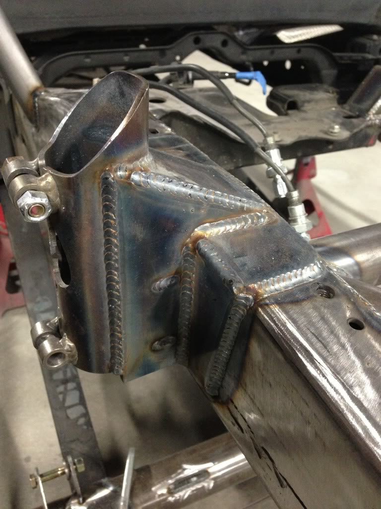

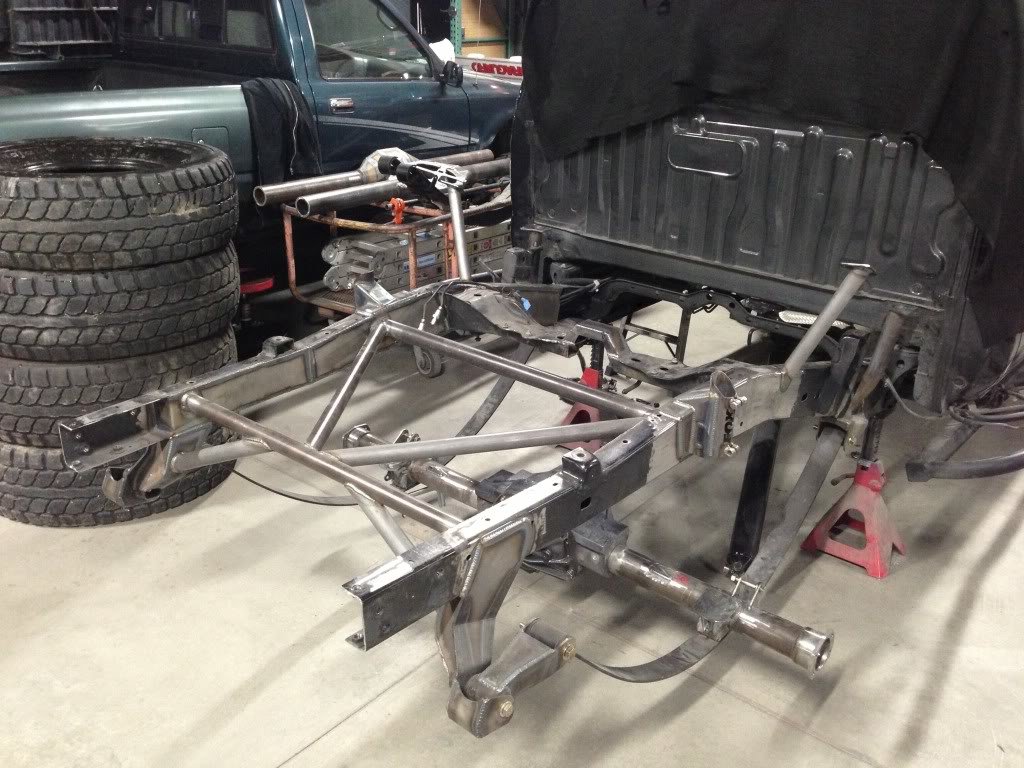

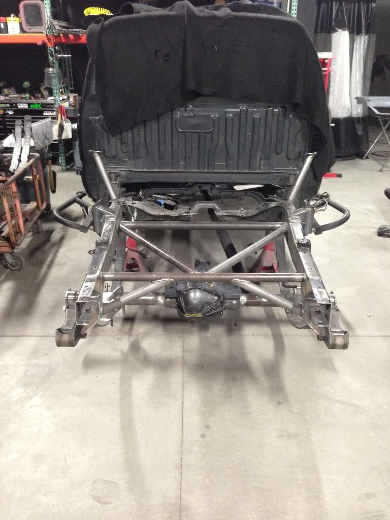

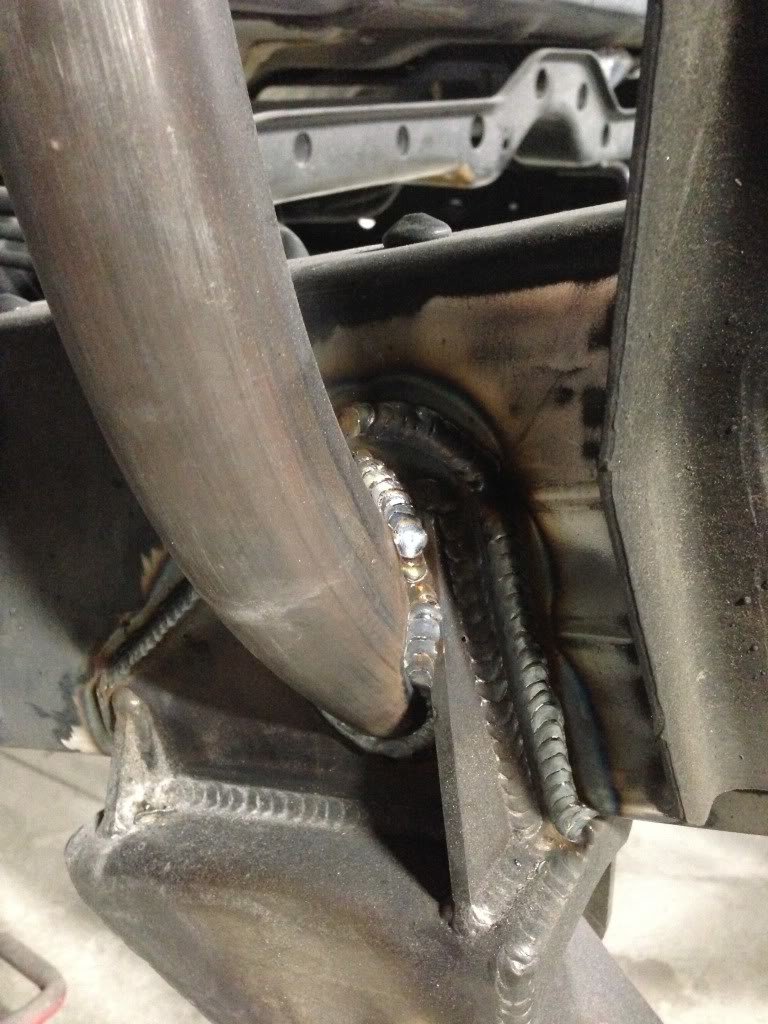

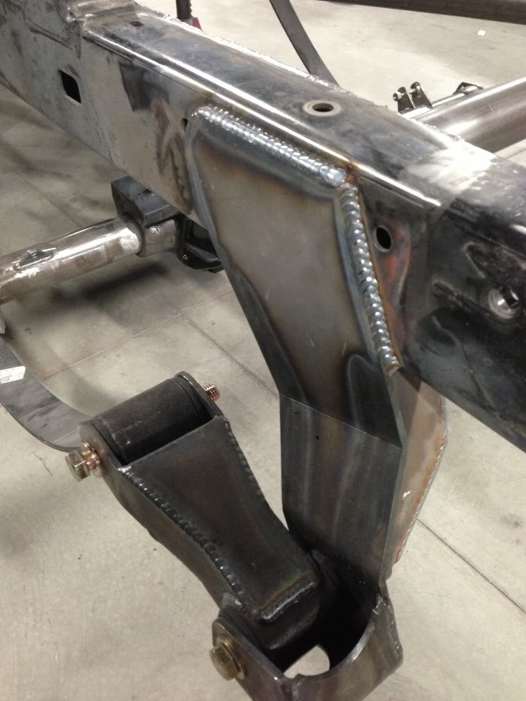

    Ok, updates!
    We took the opportunity while I was on vacation to make a few changes. Originally I had 16" x 2.5" Fox triple bypasses. We upgraded those to 3" bypasses.
    The extra size necessitated a few changes to the bed cage.
    The drive shaft was also shortened a smidge.
    That has finally been sorted out and the suspension was cycled and retacked. I was gone while this happened so no pics unfortunately.
    Currently the cage is off to powder, bedsides are going to paint, the frame & rear end are being readied for paint as well. The pics below are of some of the final welding.
