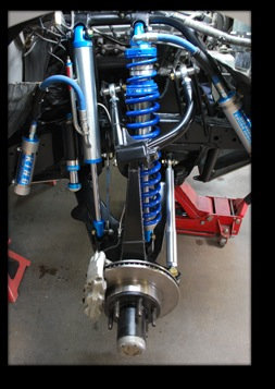

    It's been a while since I did an update on this project.

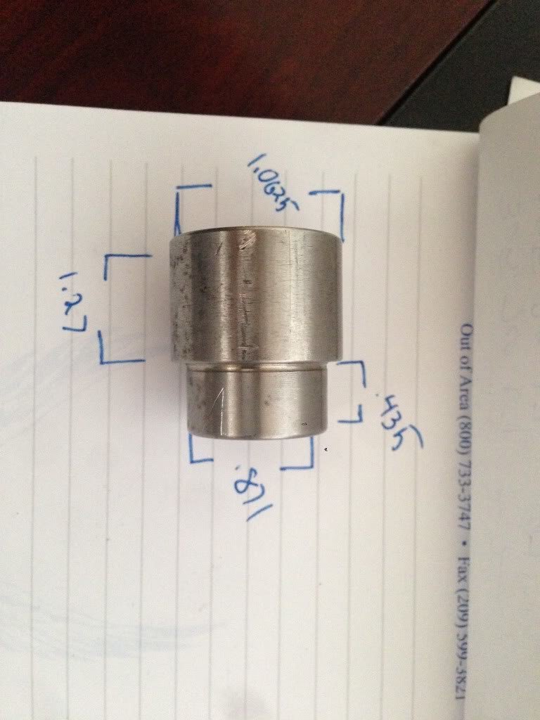

    As we began to assemble the front Solo kit, several things became apparent.
    First of all, the Misalignment spacers were completely wrong and do not fit into the stock location as they should.
    6DF381CF-D1D9-4B8F-B689-239F23CDEAAE-304_e0b5da407f87fba6300d23dc761212f028c3c5b8.jpg
    The inside is not long enough
    3580A4B4-DAF7-4D59-8316-195B436C3141-304_fe4dd18b00b6723cc1f3fca8f523f6e030b68a96.jpg
    The outside is too long
    19F1E8D7-E587-46B6-B486-04ABC395EDEC-304_611856dffcfe18bd8dcf826b2ff0a1be4cb1e4b8.jpg
  4. Jun 12, 2013 at 10:13 PM
    #204
    Zlagger
    Zlagger [OP] Well-Known Member
    Aug 29, 2011
    #62542
    444
    Rich
    Santa Cruz
    2010 DBCab TRD Long Bed
    AllPro LT front -w- Fox 2.5 COs, rear AllPro 3" springs -w- King 2.0 shocks

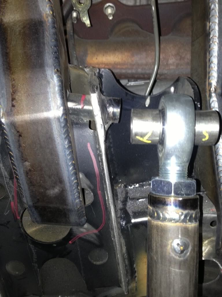

    Solo is obviously using some kind of custom towers with two bolts going through it to hold the UCA in place and they are not using the factory location. This can be seen on Solo's pic here
    The next thing was the factory tower/coilbucket is supposed to be removed as the cross tube (where long bolt holds UCA) completely blocks the 10" Coilover springs from moving freely. This is something we were not expecting.
    So we have made custom misalignment spacers and will be giving feedback to Solo as we go along.
    CC3546FE-402E-42E9-A7E4-A8834BB920B5-304_ca3b5b64bcbabf98cec36954bc3078725b6dac4f.jpg
    Of course Murphy's Law struck again when we found the hubs didn't fit in the spindles. We had to machine the hub housings down a bit so they wouldn't bind.

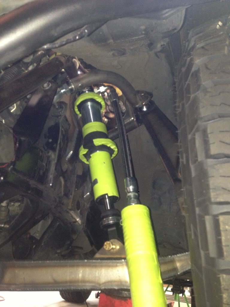

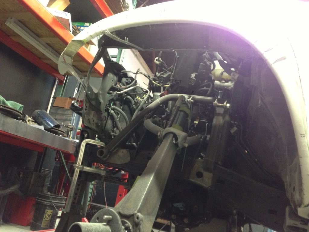

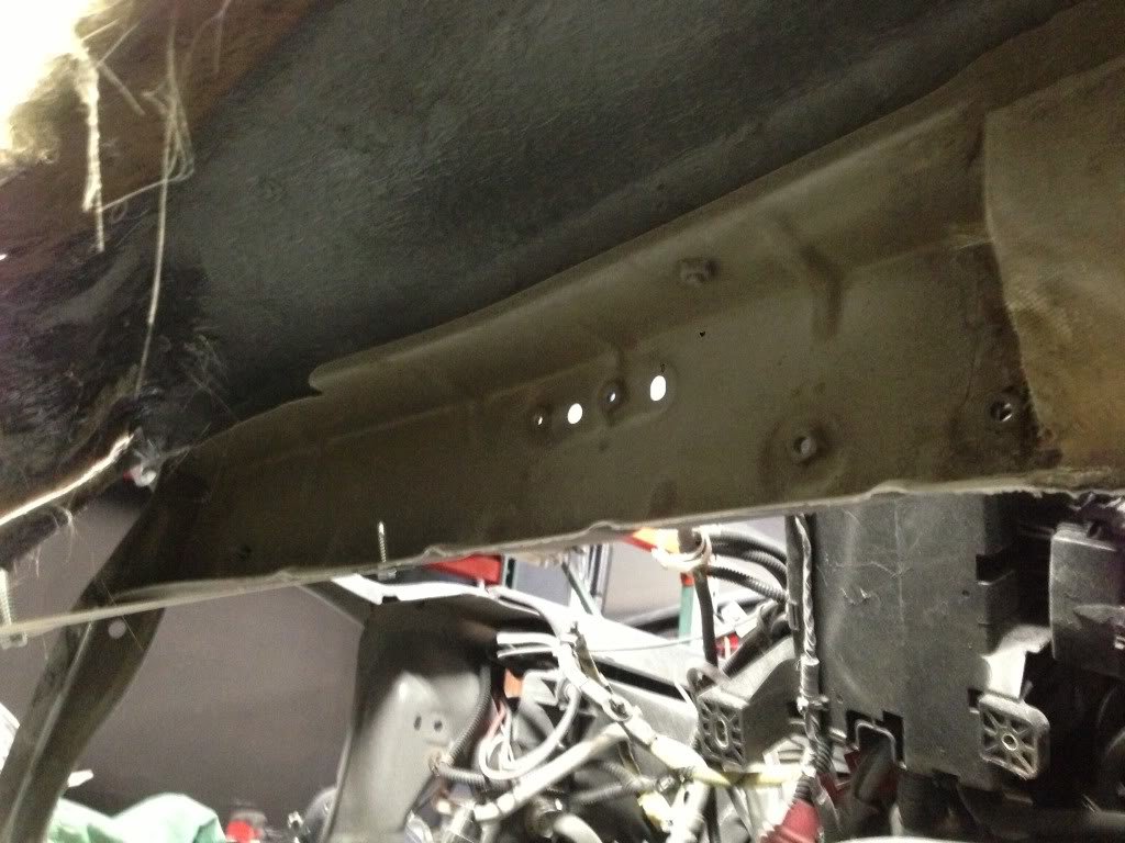

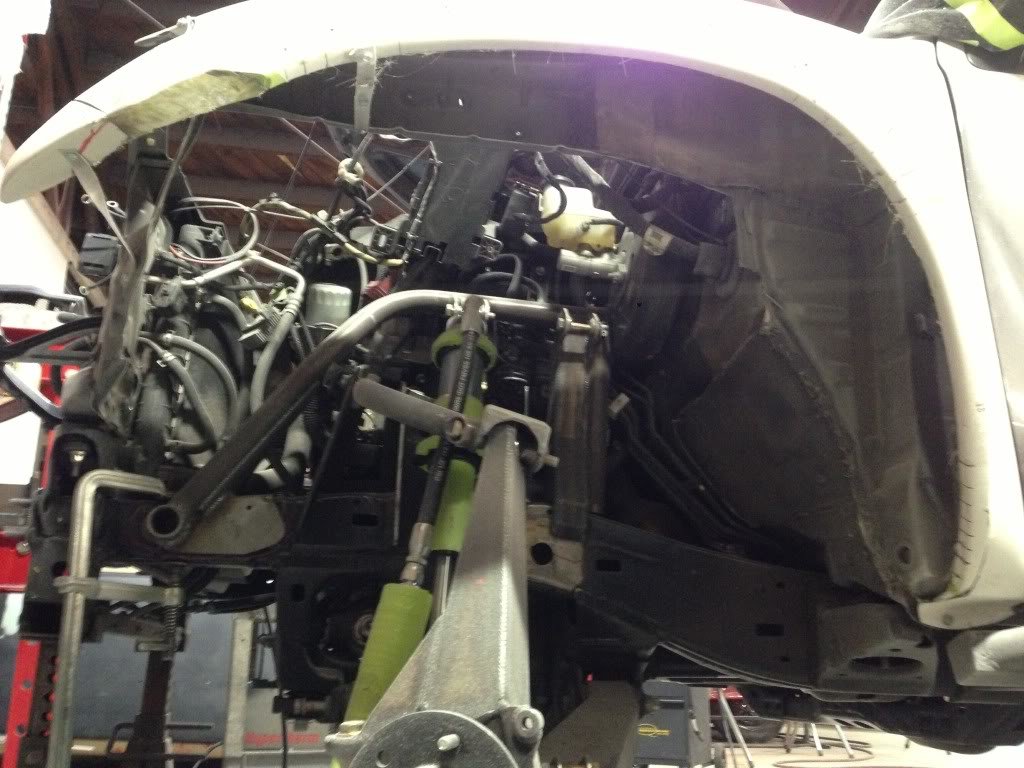

    Once we had the arms in, we started checking the cycling of the suspension
    4933972C-D04B-4649-8778-9392545B6DC9-304_0ac96688e2f2ff0af2495e133f5571477f064980.jpg
    The upper arm hits the sheet metal and will need relief trimming
    419B16D8-1BB5-4D50-95FE-D4A1761B3CB2-304_ba59f5934ba9ee78434a81a0527fa5f385877da0.jpg
    E15561D7-6F9A-478B-8669-37328B8536A1-304_198a2dcd18a5cc2be393abd5a8136e351773e24d.jpg

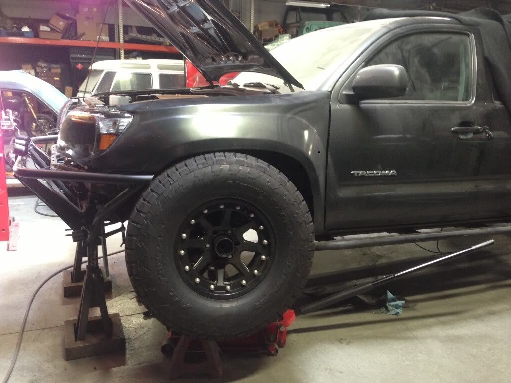

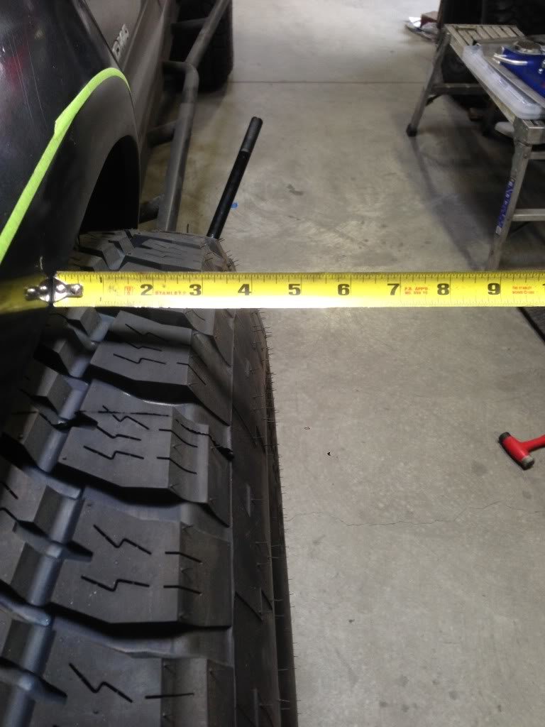

    The next limiting factor to up-travel was the fenders and even bumper
    C0927C73-5DEF-40A6-B365-DC8BFBFC9788-304_0e340e578081599041f8f239c1c1a7f8518daf92.jpg
    Even with my fiberglass fenders, I still have over 4" of tire hanging past. That's a lot of impact area.
    75F90685-057C-422A-965F-ADC478E91D26-304_7930230d7b8df7b5a1c886cb1b49c820fd6af4df.jpg

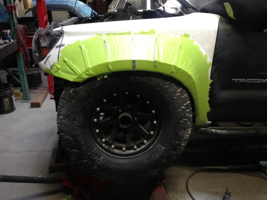

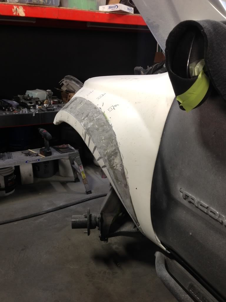

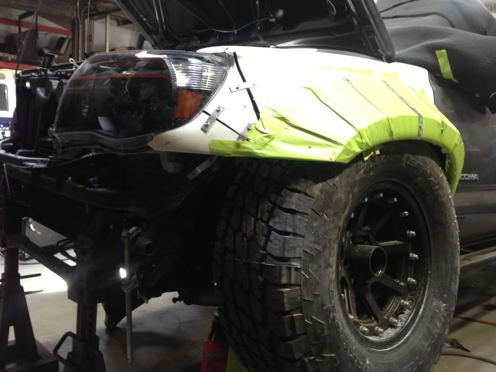

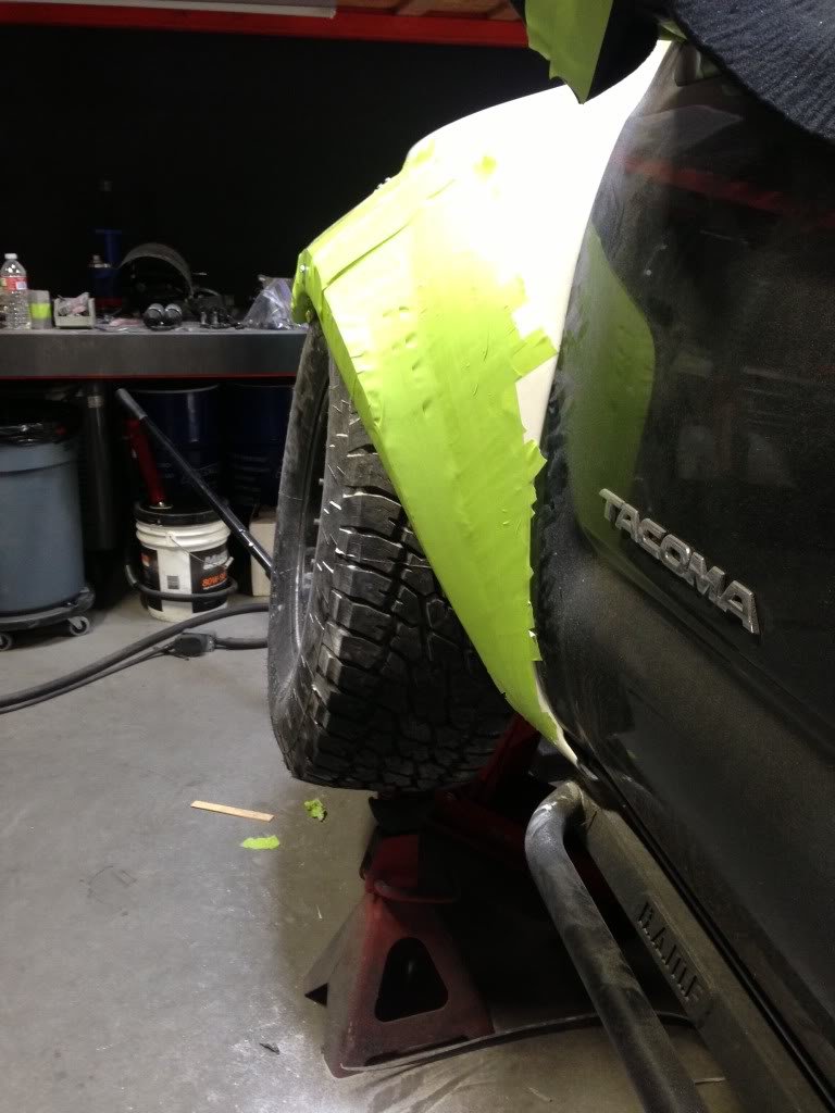

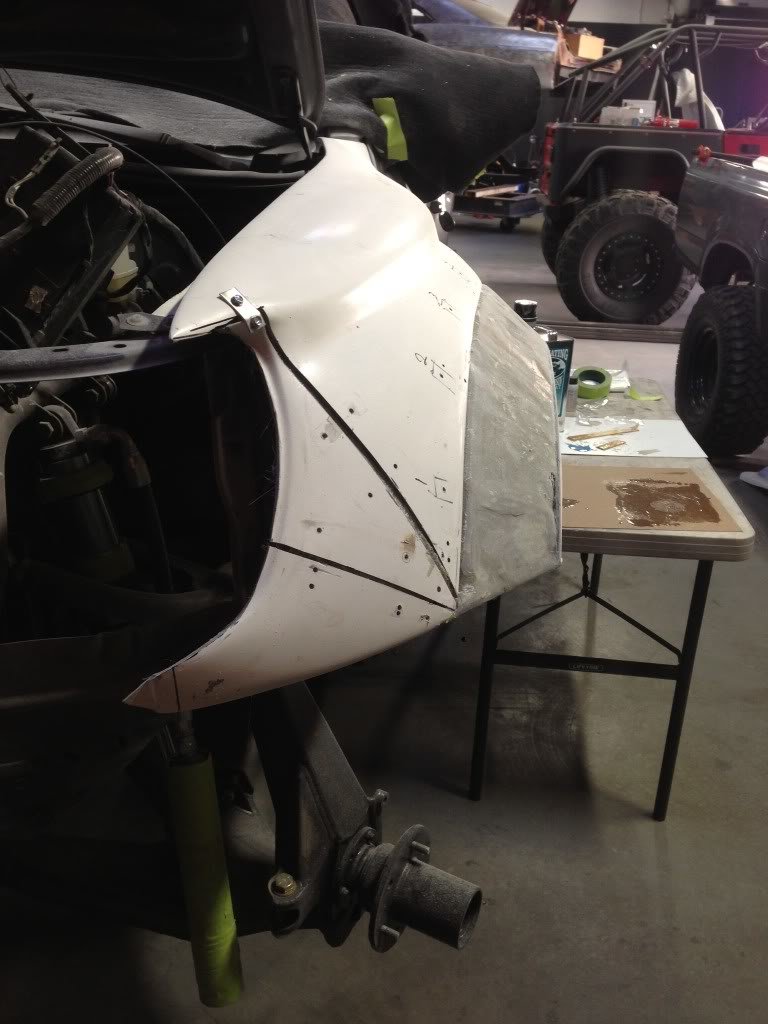

    To solve the fender issue, we had two choices. Buy 6" flared fenders and trim them or go fully custom.
    Of course we went custom to make sure we could fully tuck these 35s.
    07EC2D1C-7FFE-4DB9-9407-E55D8C8A134E-304_be96962a29d3ed9da3c2901dd65d71a28a4ec550.jpg
    Almost done with rough work

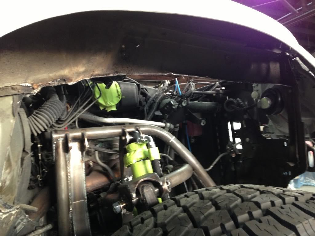

    We started with selective sheet metal trimming & then just found more areas to remove...
    There will need to be some sheet metal work in here at some point if I want to keep the engine bay sand blasting under control.

    Nice to good documentation of all the work required to get this kit to fit properly for future installs etc.
    True, but also I'm being a bit of a guinea pig on this one. Since we are the first non in-house install. We are finding several areas that make this less than bolt on. Hopefully they fix the issues before sending out more kits.

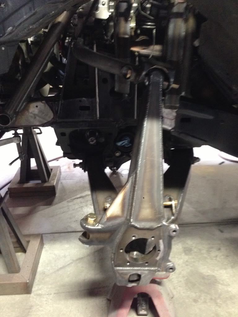

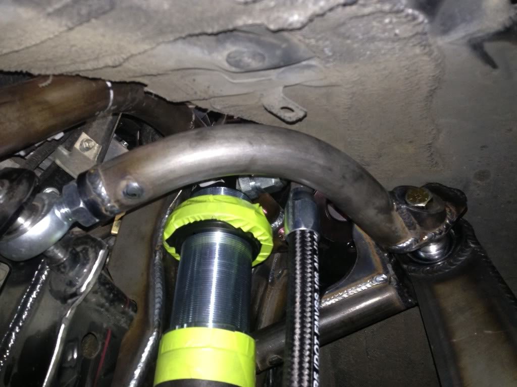

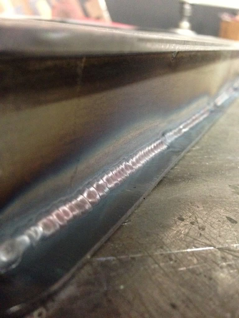

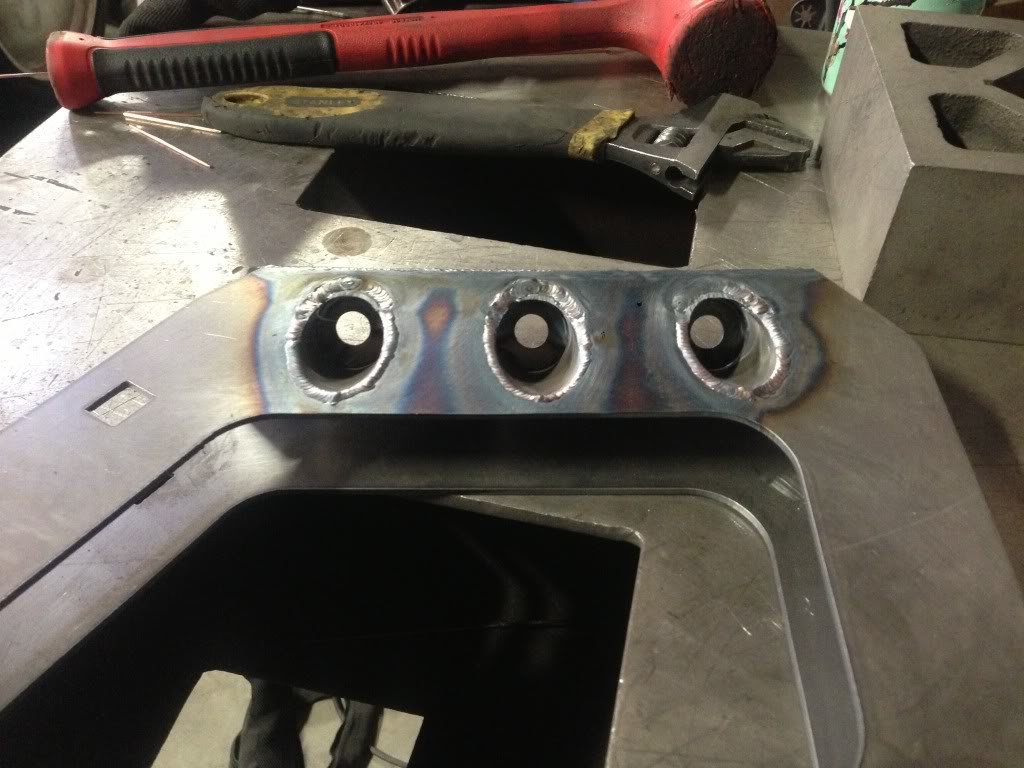

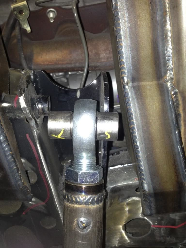

    LCA gussets

    Did someone say trimming?

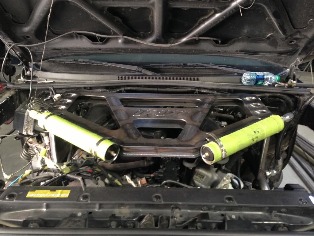

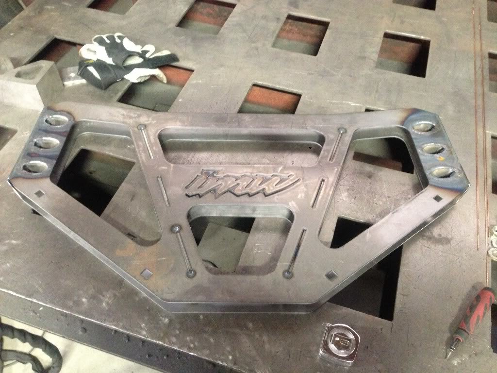

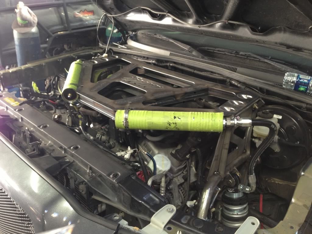

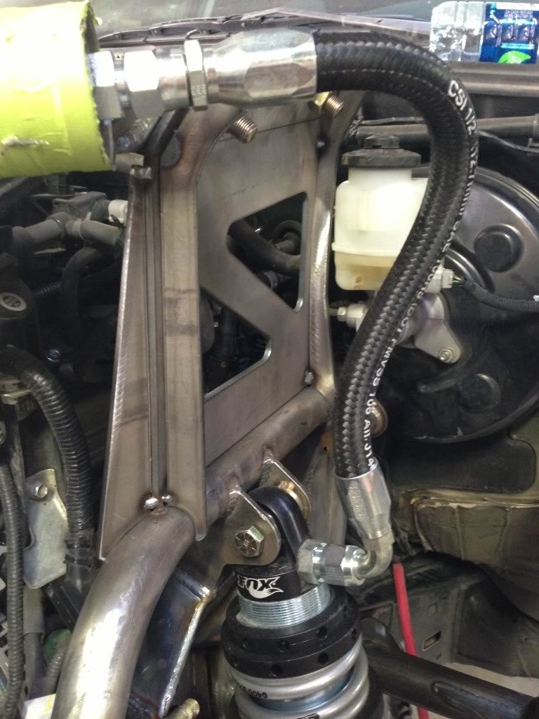

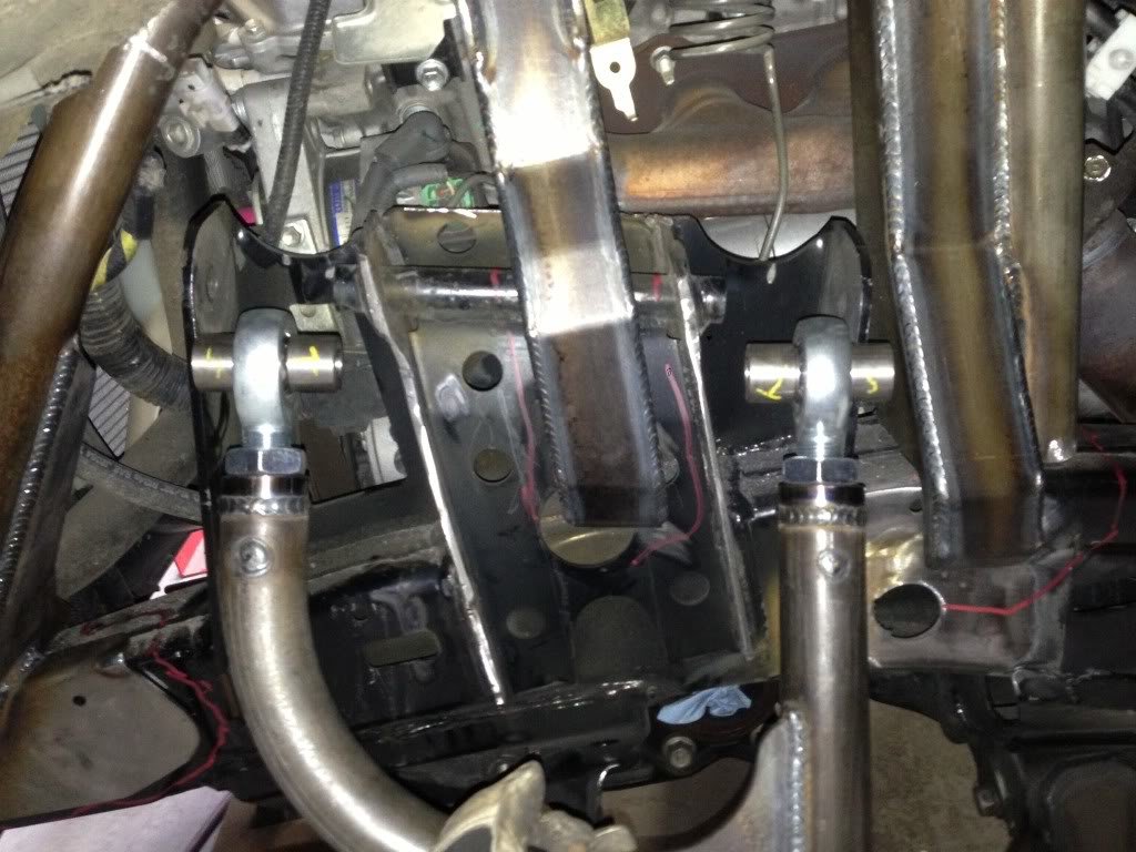

    Engine brace / cage

    That looks great man. Only thing id like to point out is solid mounting the lower still leaves the inside of the lower pivots with a oval hole and could eat away the bushing more.
