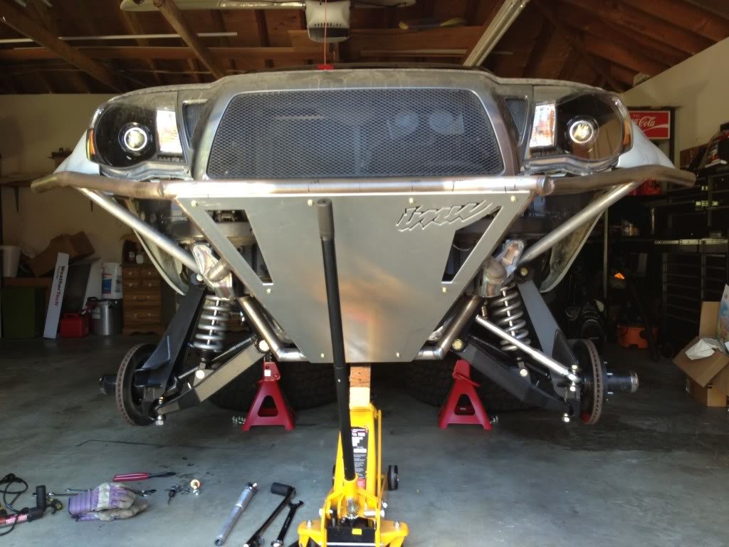

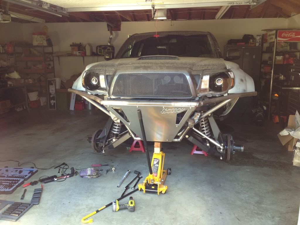

    Suspension for days!
    Disassembly started
    Next up the Dana 44 U-Joints
  12. Aug 30, 2013 at 2:58 PM

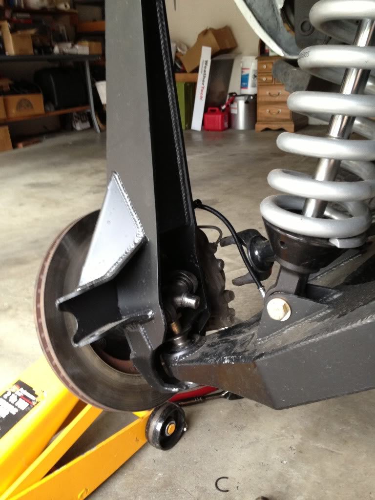

    Well, I can tell you that axle removal sucks...
    Had to remove the axle since the lower spindle ball is double sheer with the bolt needing to lift up through where the axle is.
    So it's either remove the hubs and take the axle in one piece or break the axle u-joint.
    The design is strong, but I would hate to do this on the trail.
