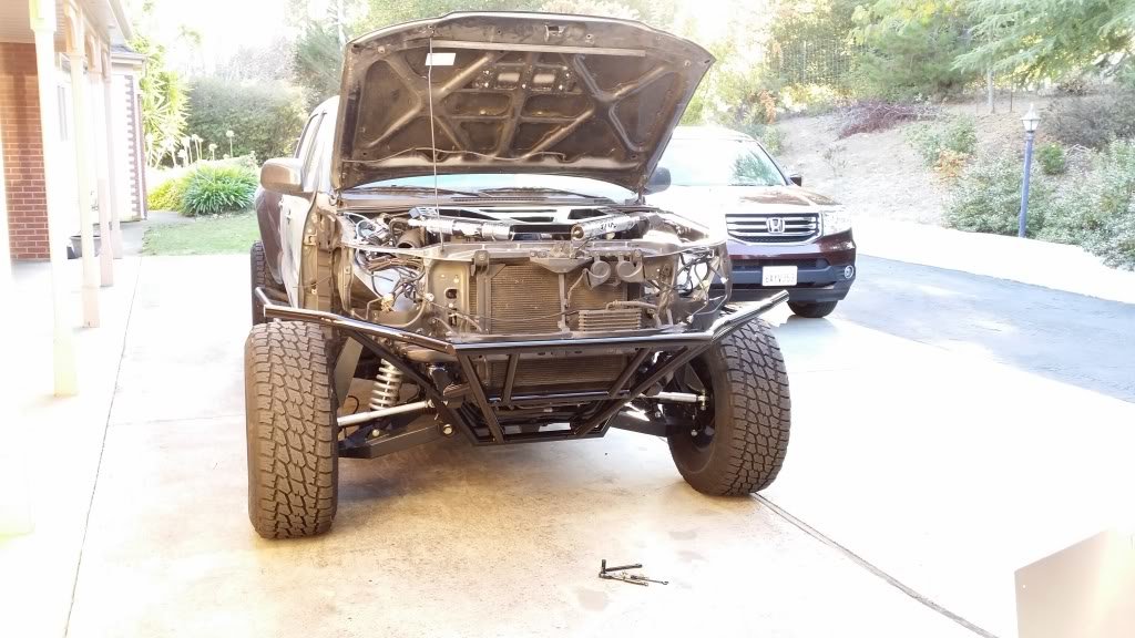

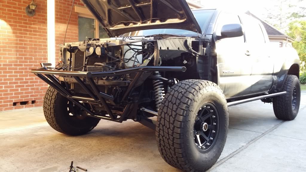

    Every time I look at something I find it incomplete. I was so frustrated over the thanksgiving break that I didn't touch it. The fenders are mounted with half the factory bolts so they are loose as shit. There needs to be more fiberglass work to make tabs work.
    The ARB locker was supposed to be done. The compressor doesn't turn on.
    The wiring from the cab needs to be wrapped and sealed to keep out water.
    Intake system needs completing, as does the exhaust.
    Wiper fluid resevoir and pump was moved to other side of engine bay. Wire and hose needs to be modified to work.

    Took off the front plate and painted the steel bumper tubing.

    As far as the truck goes, the things that remain to complete are:
    - Fenders need a little fiberglass work to bolt by the door
    - Paint fenders
    - Rear fenders need couple support brackets to stop shake near wheels were there is no mounts.
    - transfer case needs one gear installed to finish speedo, currently using GPS speedo
    - install front bypasses
    - Mob the desert!!
