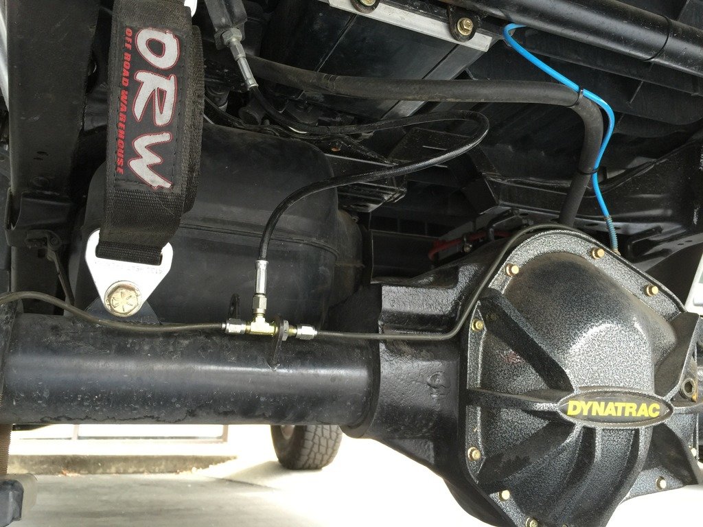

    Next on the list was brakes...
    This one item really is what had the truck grounded for the last 1/2 year.
    After doing all the mods, the wheel speed sensors are all removed. This means no ABS which I am fine with. Unfortunately the rear willwood brakes need more fluid than the stock drums, and the ABS unit was still plumbed in the lines, but doing nothing.
    This lead to a system that was super unsafe. The ABS unit can't be bled without the factory diagnostic tool, and even when bled it seems to create a squishy peddle. Since the rear disk brakes need more fluid as well, the brake system was crap.
    The peddle was mush unless pumped twice. So I never took it anywhere but work for the last year.
  16. Jul 8, 2015 at 3:30 PM
    #376
    Zlagger
    Zlagger [OP] Well-Known Member
    Aug 29, 2011
    #62542
    444
    Rich
    Santa Cruz
    2010 DBCab TRD Long Bed
    AllPro LT front -w- Fox 2.5 COs, rear AllPro 3" springs -w- King 2.0 shocks
    So we removed the ABS unit from the loop, and ran new brake lines.
    There is now just a single hard line running to the rear end where it T's to each caliper.
  17. Jul 8, 2015 at 3:33 PM
