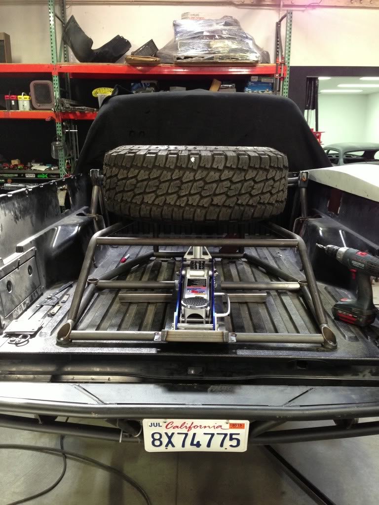

    Joey, at Infamous Metal Works is busting the work out now.
    Today he mocked up the removable spare tire carrier. It uses factory bed mount bolts and will accommodate 2 tires. One goes on top, and the other angles to the tail of the bed.
    Jack /skid are mounted, but there is more space for aux fuel cell or batteries.
  15. May 1, 2013 at 9:53 PM
    #175
    Zlagger
    Zlagger [OP] Well-Known Member
    Aug 29, 2011
    #62542
    444
    Rich
    Santa Cruz
    2010 DBCab TRD Long Bed
    AllPro LT front -w- Fox 2.5 COs, rear AllPro 3" springs -w- King 2.0 shocks
    It should be 1" to 1.5" wider up front
