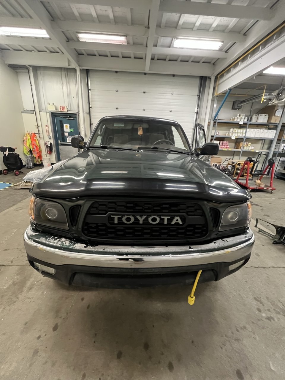

    Here’s the truck when I first got it!

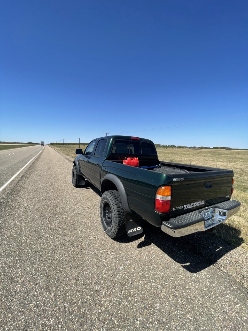

    Somewhere in Saskatchewan - 2500kms till home!

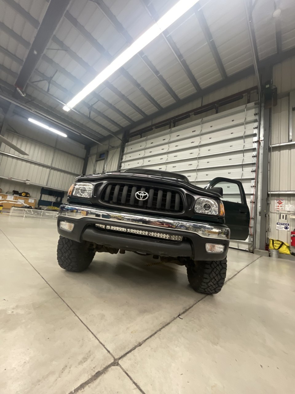

    First mod: get rid of the chrome grille!

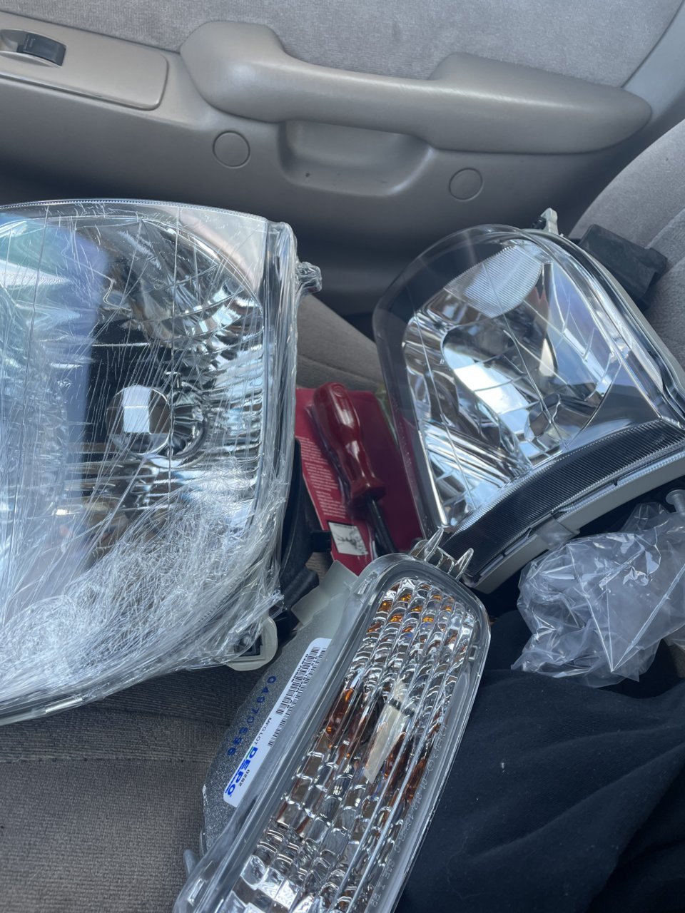

    Some shiny new headlight housings and “blinker” housings

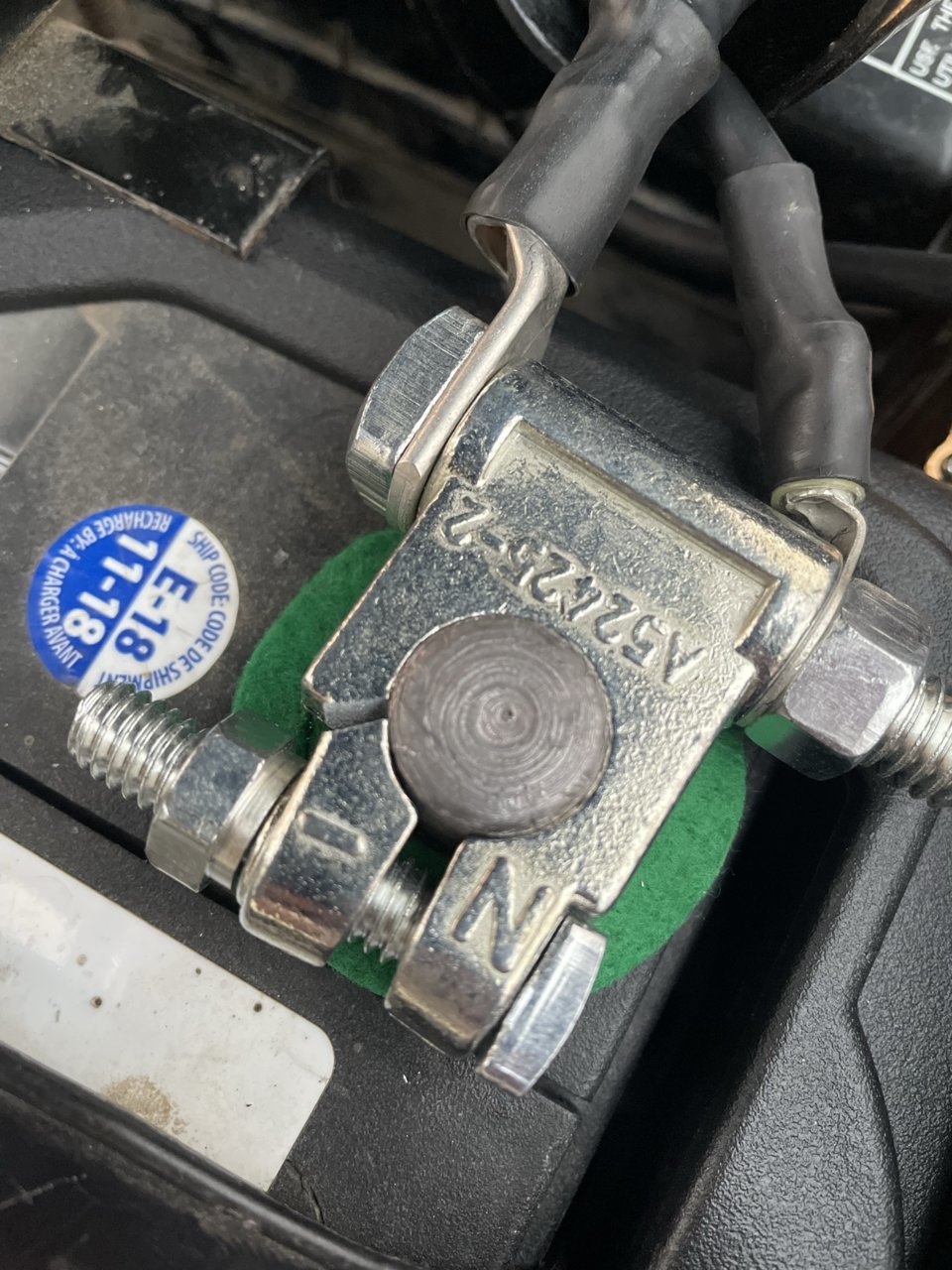

    During my drive home I replaced a battery terminal and somehow broke another, I went ahead and ordered SDHQ Billet Terminal Leads and plan on doing “the big three” battery wiring upgrade in the future
    The new headlight housings really brightened up the truck!

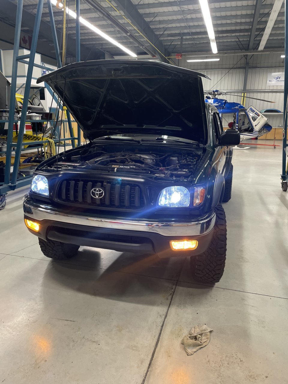

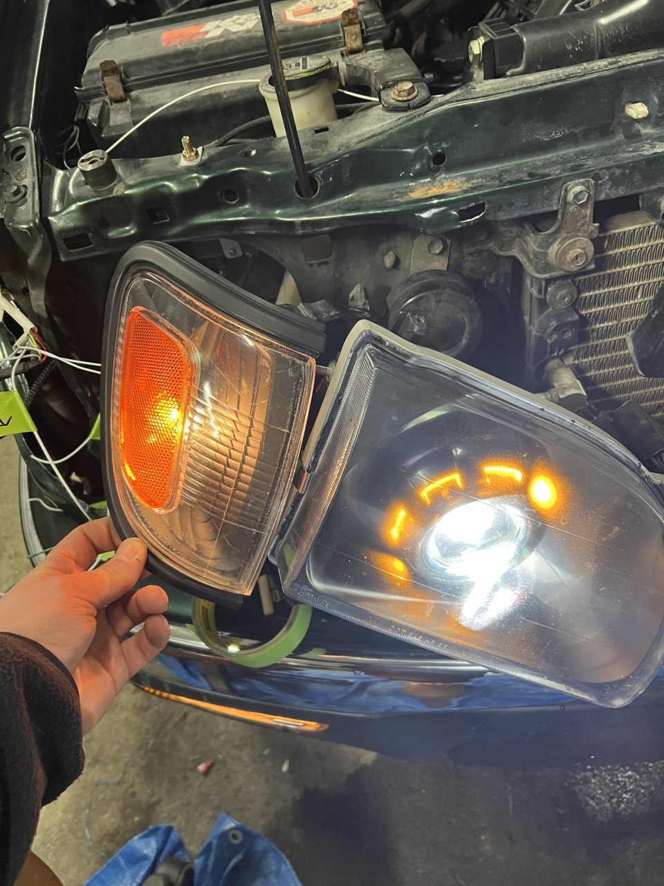

    Got some Bi-xenon ACME H1 Universal Projectors from Theretrofitsource!
    What an upgrade, my headlight output is brighter, and further than current model tacoma’s, for the price of doing this it is worth it’s weight in gold. (6000k bulbs here but eventually moved to 5000k)

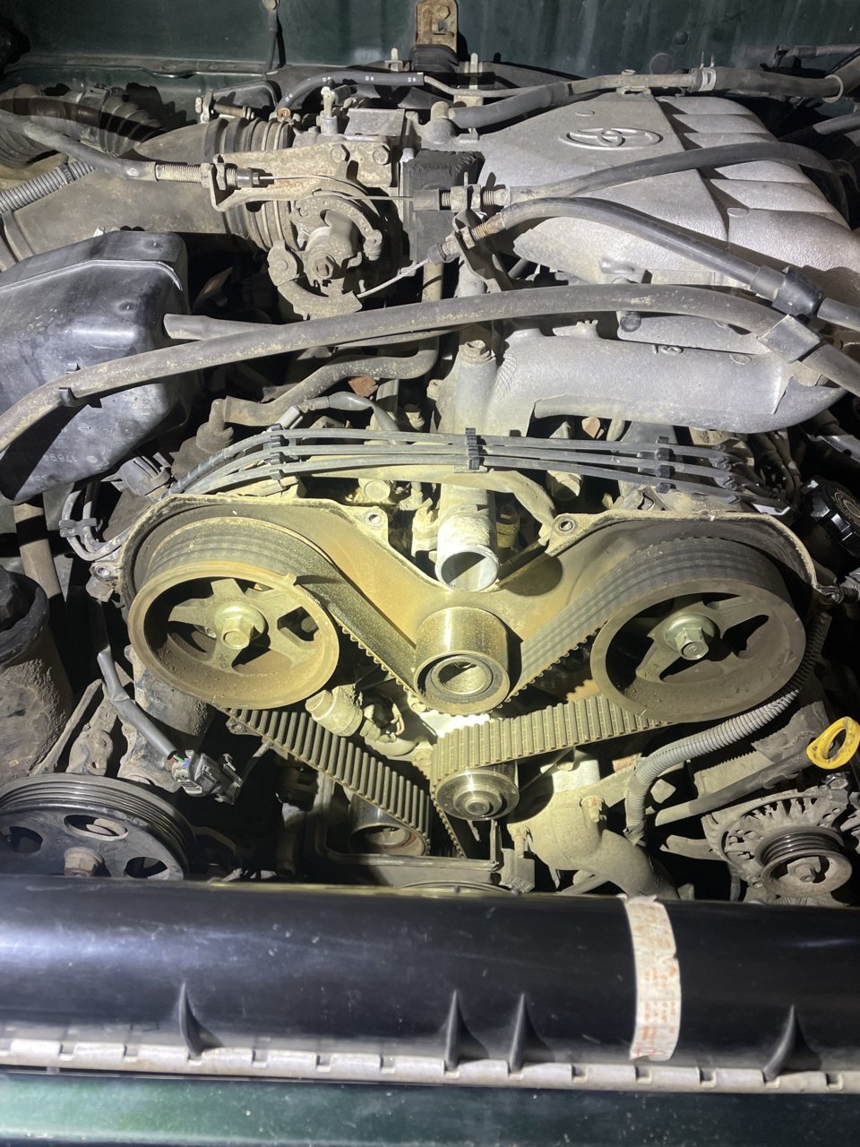

    Some maintenance: All drive belts, timing belt, water pump, front cam shaft and crank shaft seals!
    She’s alive after all that work!

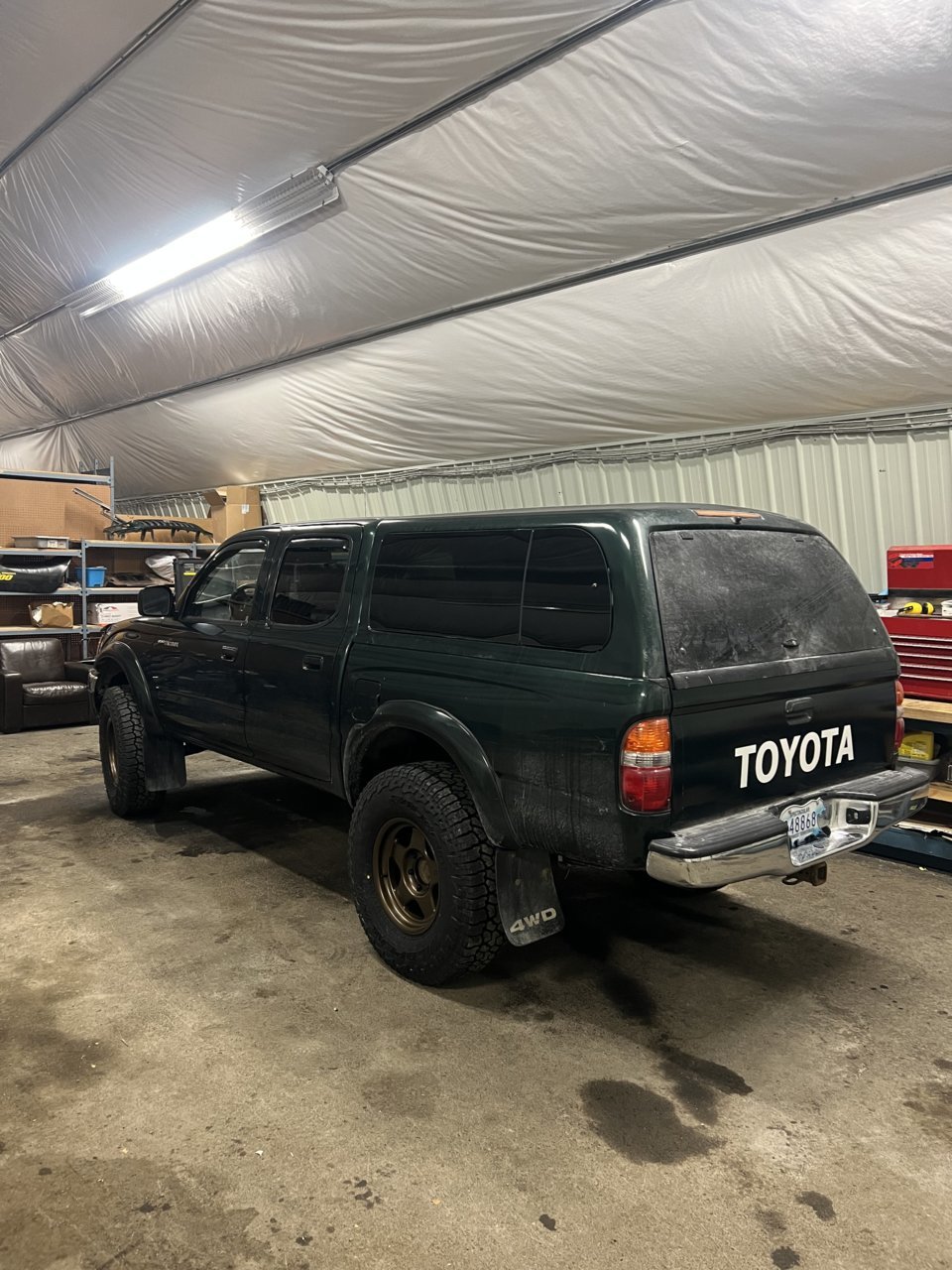

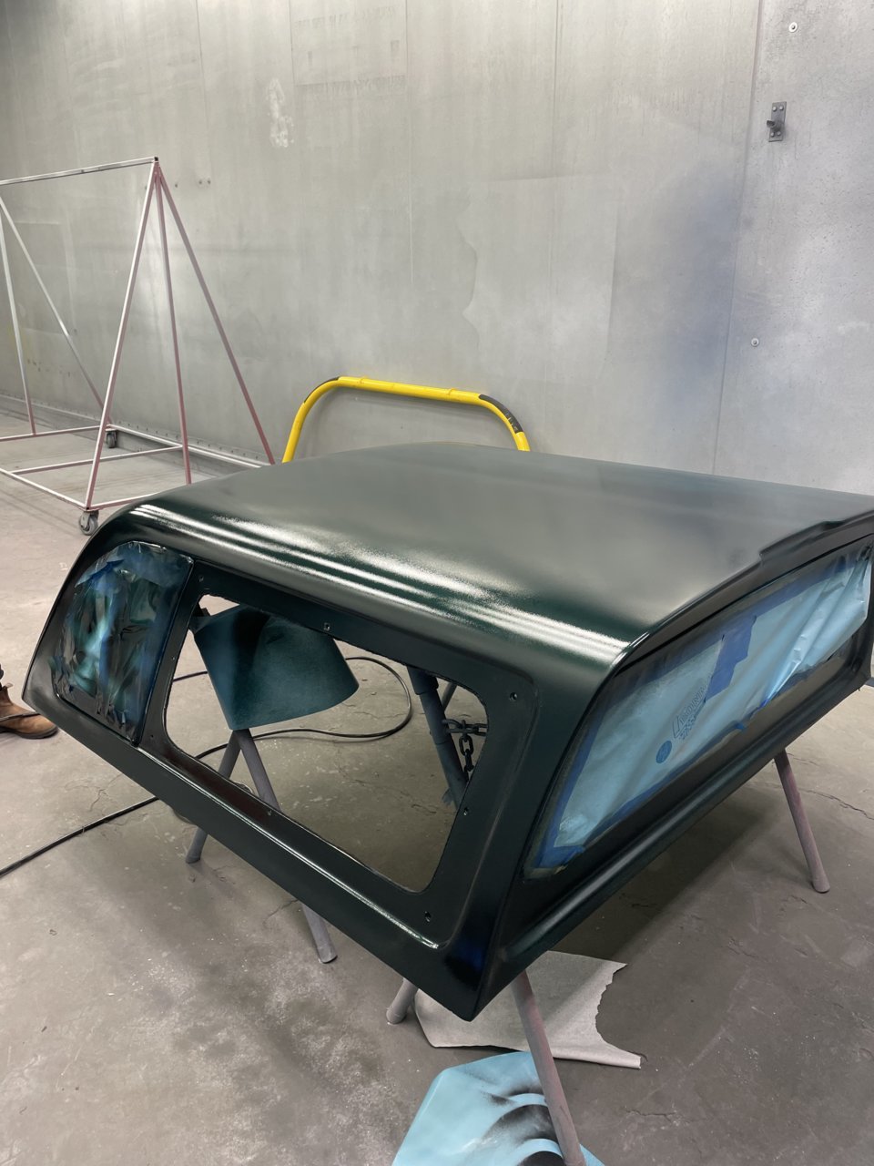

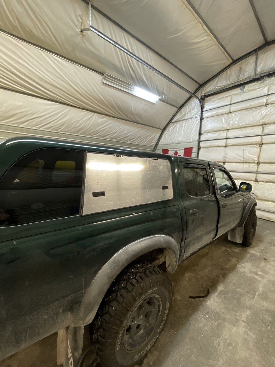

    I managed to get my hands on a Snugtop Canopy - I had a buddy down in Calgary go have a look at it, the day before someone broke in and smashed the side window, I got it for $400+$250 for freight shipping to Yellowknife, add in paint and I have a canopy for under $1000! (I love orange peel)

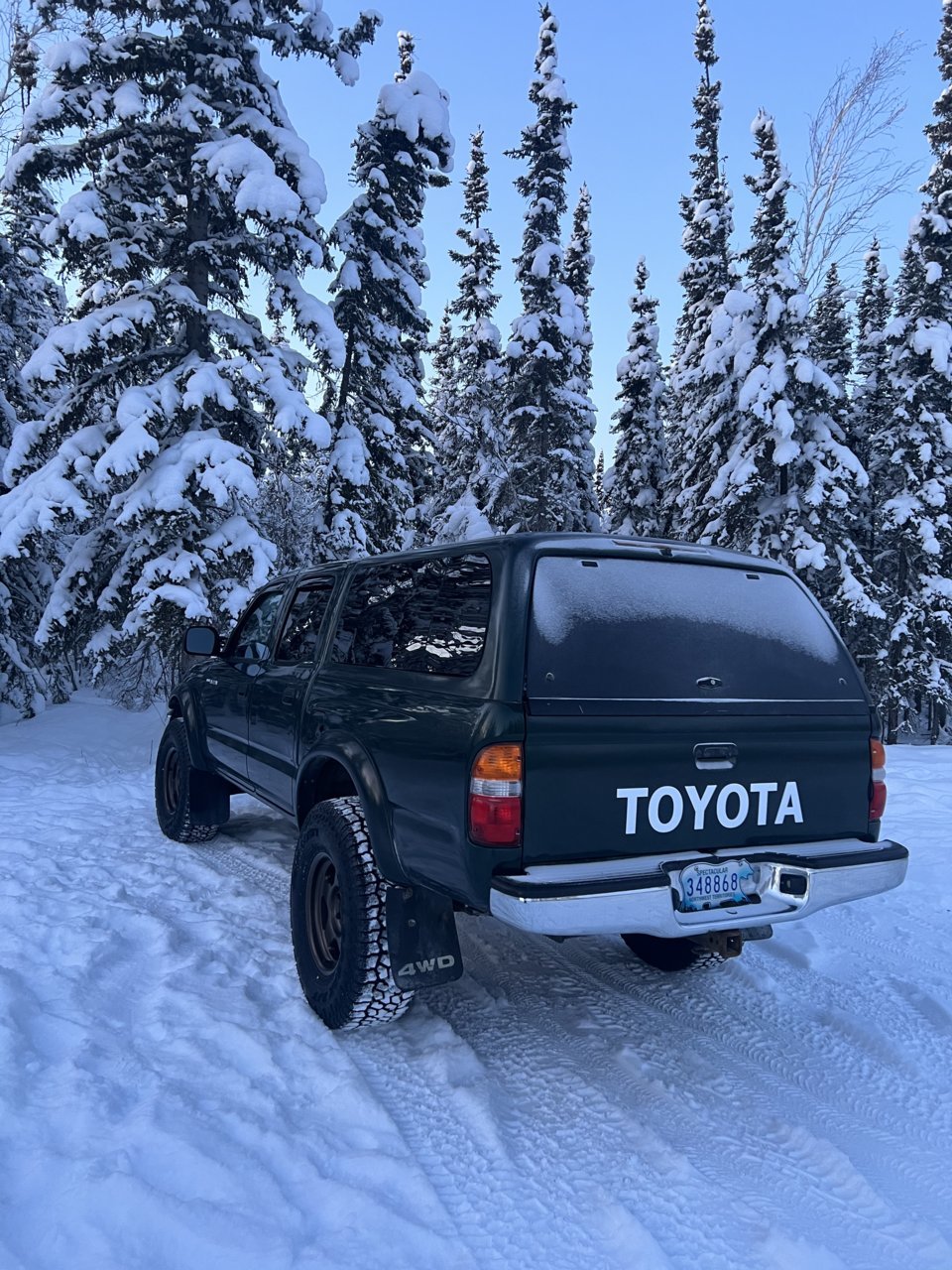

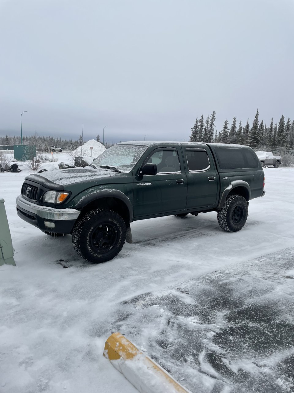

    Mounted just in time for the winter, I went with the canopy for a couple reasons; keep snow out of the bed and to have more storage in the truck, I made a custom “gull-wing” style window, I have plans of re-doing this with a different style hinge and reinforcing the window frame on the canopy!

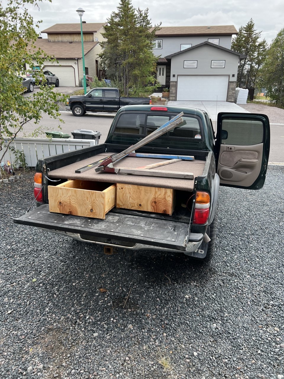

    Now since I have the boat, I needed more storage in the truck bed for boat things!

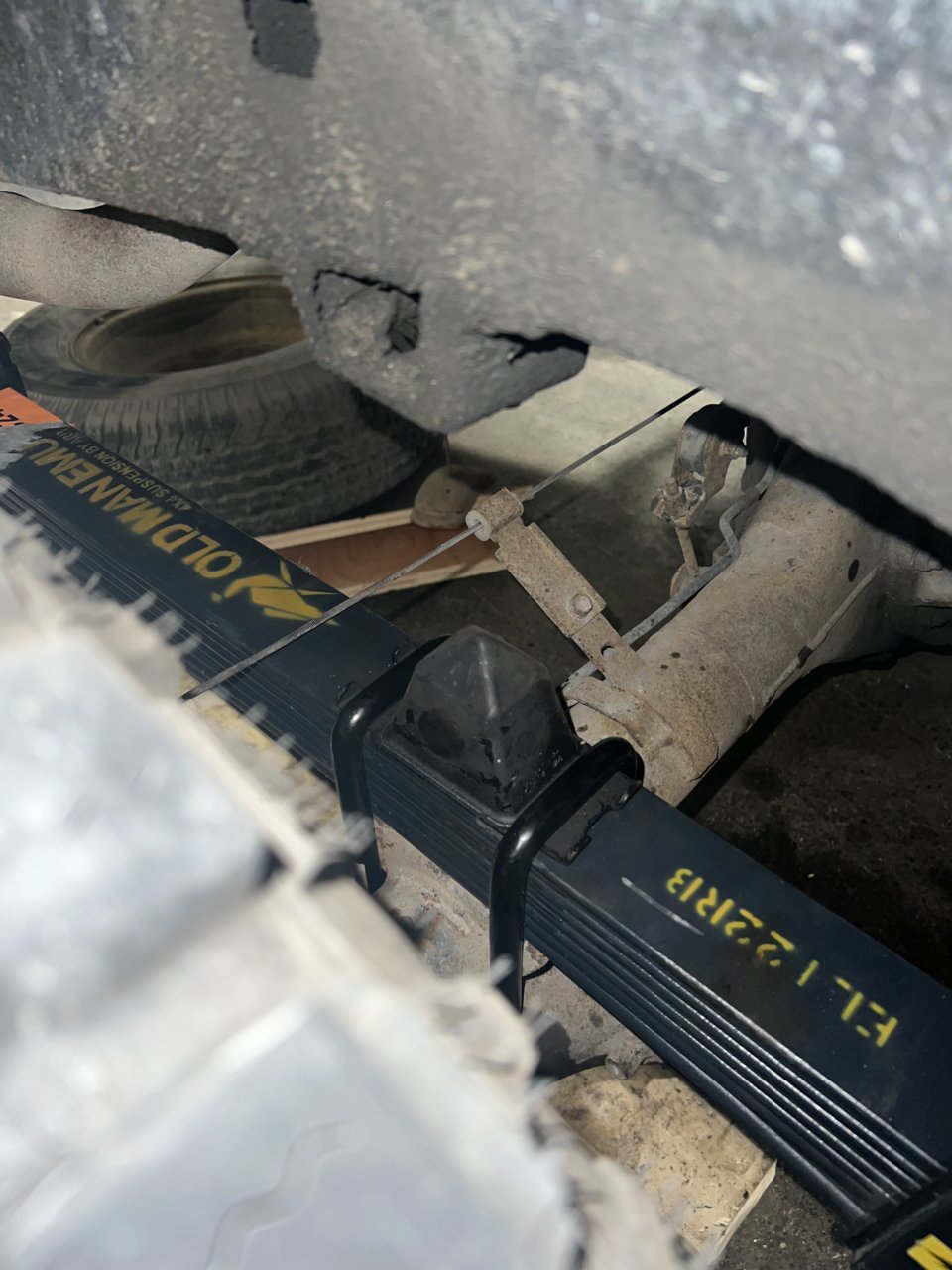

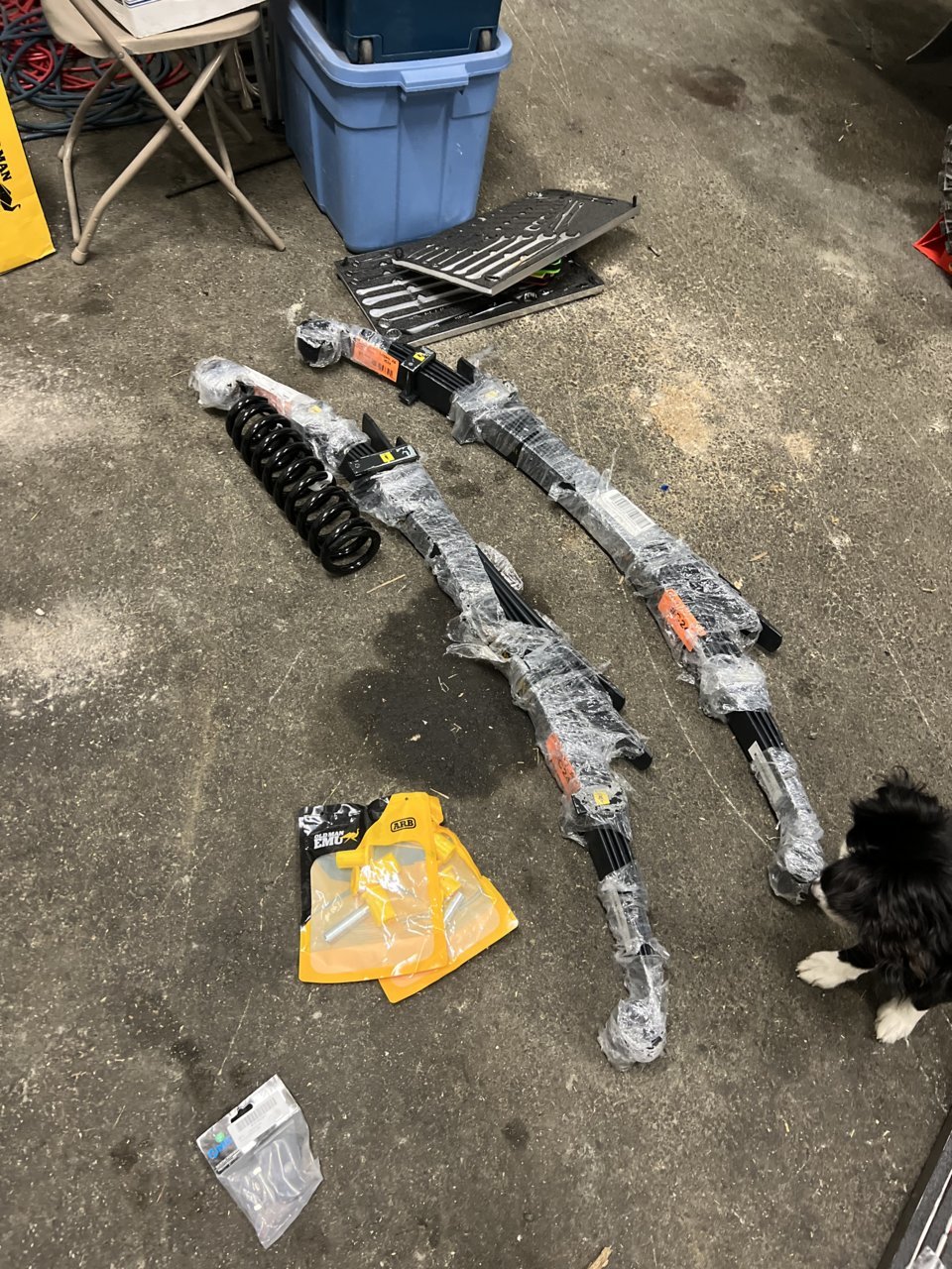

    Testing out the new suspension! I went with a OME kit from 4wheelparts, they had good customer service but “covid delays” took about 5 months to receive the kit and I was sent the wrong leaf springs bushings and no bushings for the rear struts :( A quick email changed that but still unfortunate!

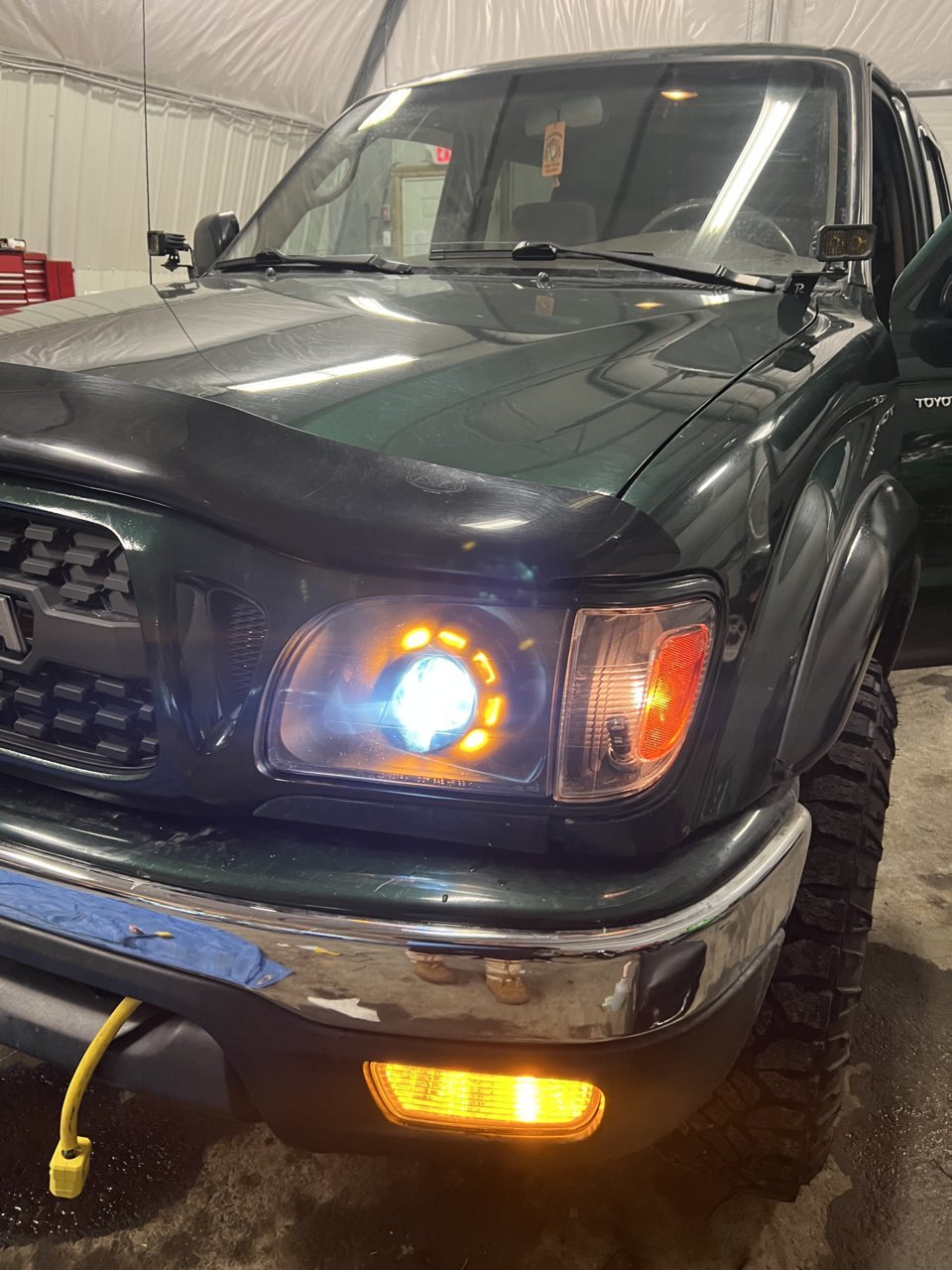

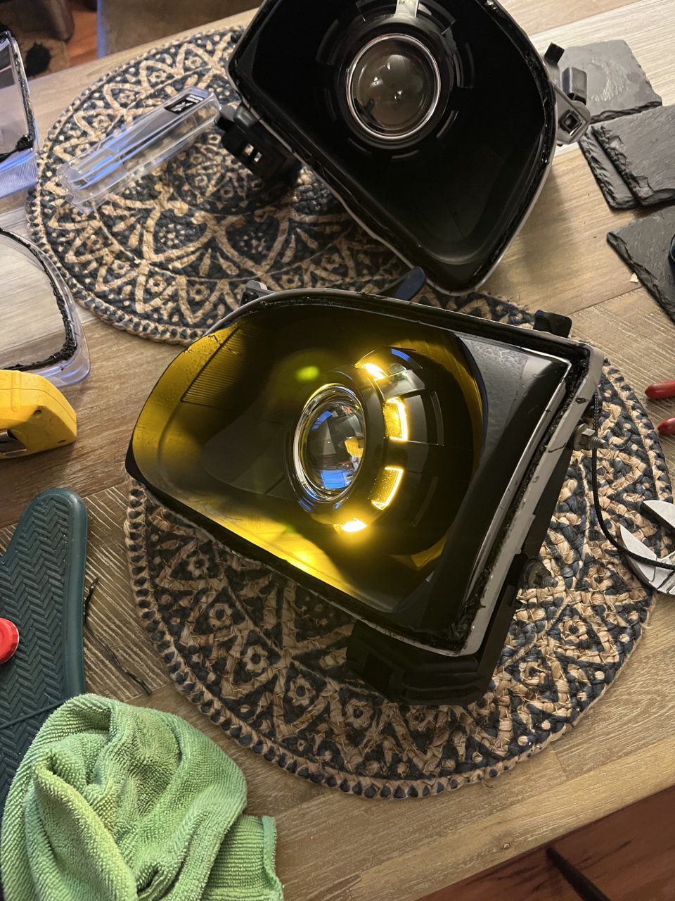

    Decided to update the headlights, went with some black Apollo 3.0 housings amber diode dynamics halos (110mm). I managed to custom mount them onto my old shrouds (mini gatling guns) so i retained a unique chrome ring inside of the new shroud, looks pretty mean. I plan on re-wiring these so I can turn on the halo and the headlights independently, I just haven’t gotten to it yet!

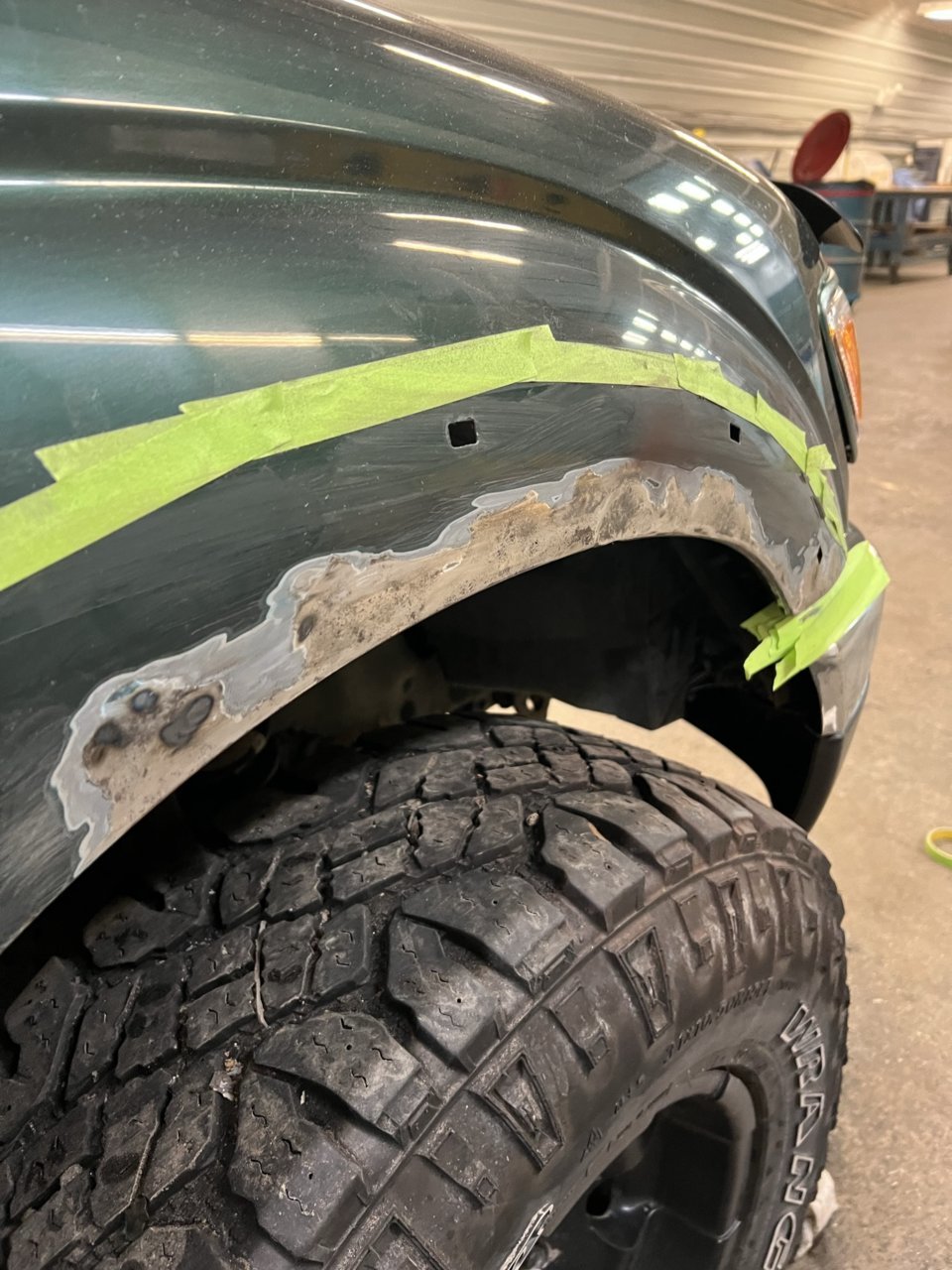

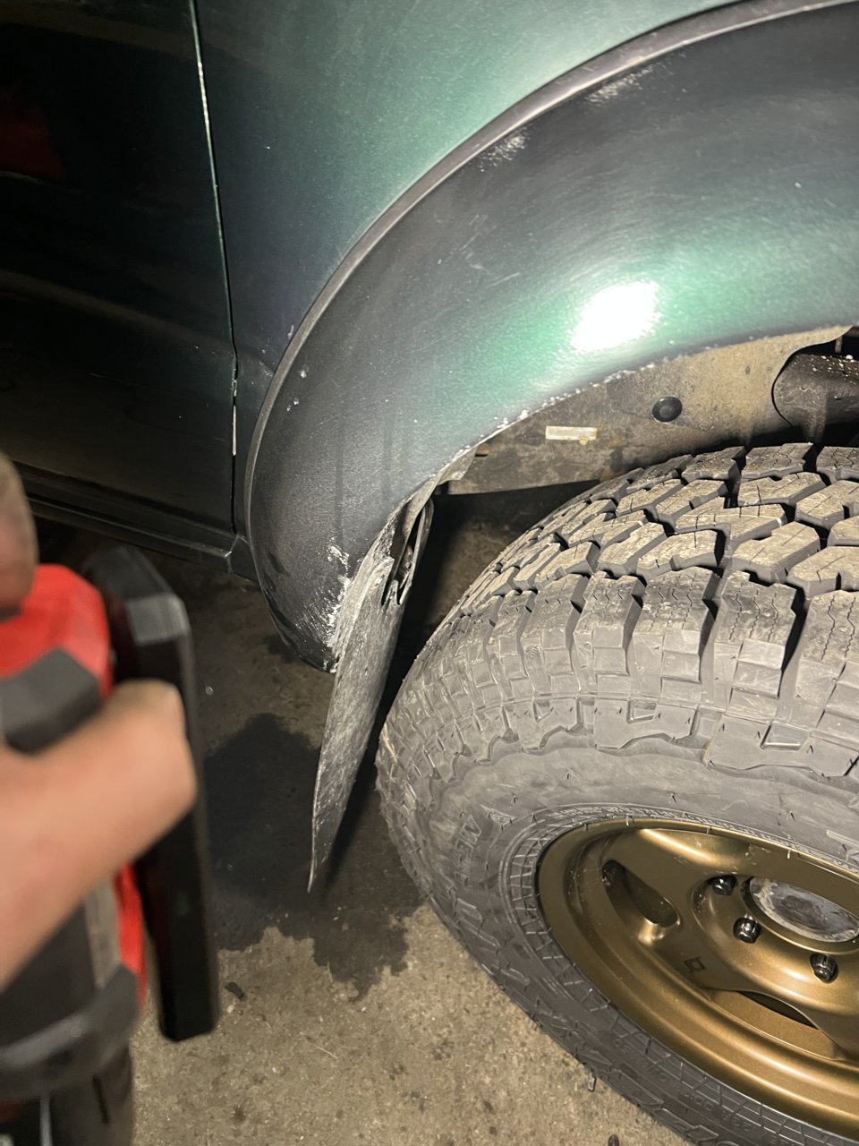

    Decided to paint match the fender flares and was surprised to find some rust under the flares, I mean it’s probably been 10 years since anyone removed them so there was some build up but nothing a grinder can’t handle and very little of it was through the actual metal

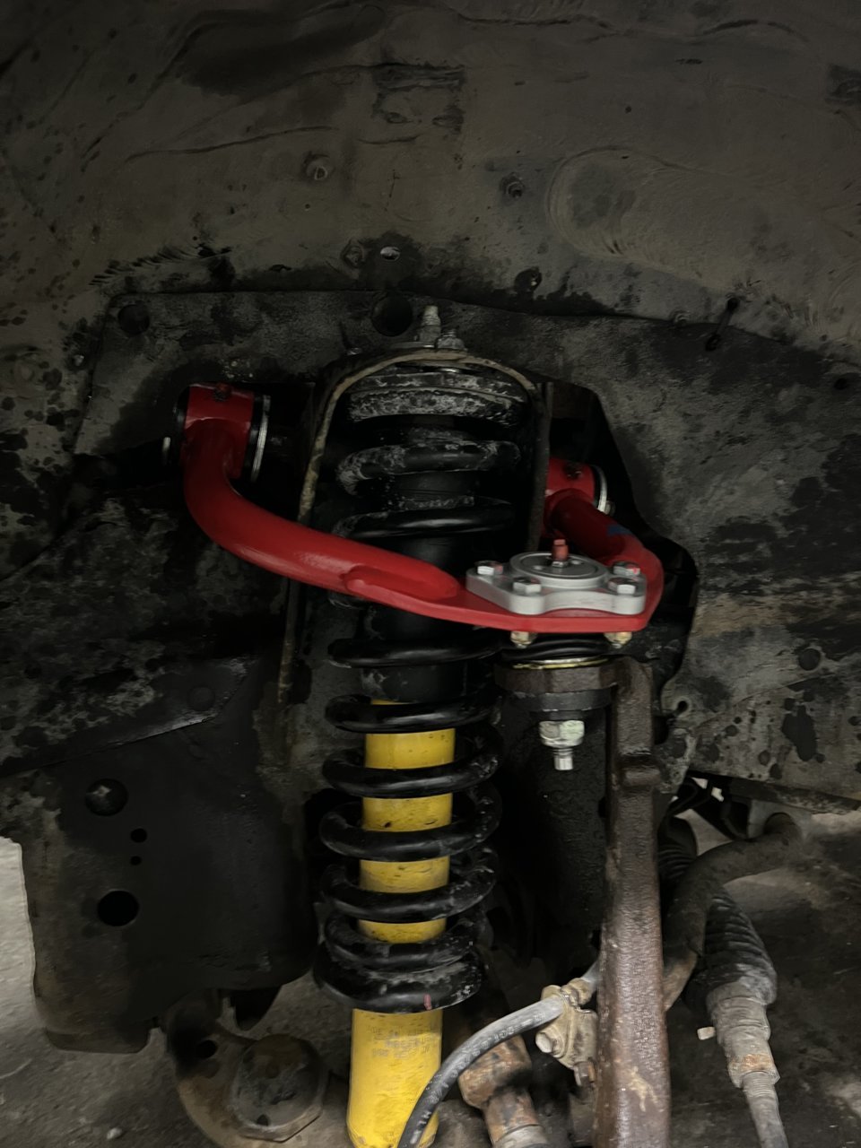

    Some photos of the suspension, I ended up getting JBA UCAs after reading endless posts about lifting these trucks and dealing with OEM UCAs and not being able to get the caster to where it needs to be, also was planning on bumping up from a 31” to a 285/75r16 Falken Wildpeak AT3w (33.4”) so I really needed to be able to push the wheel forward in the wheel well so I pulled the trigger!
    The old suspension was completely shot, someone at sometime had custom mounted 98’ GMC 1/2 ton leaf springs to the truck and the front mounting bracket hung down so low below the truck, I also just really didn’t like how it was custom mounted on, oh and the truck didn’t have any rear bump stops so i picked up some OEM ones for now, I have plans to go to a 2-3” lift rear bump stop in the future, haven’t made my mind on what setup yet especially since they seem to be a lot of $$$

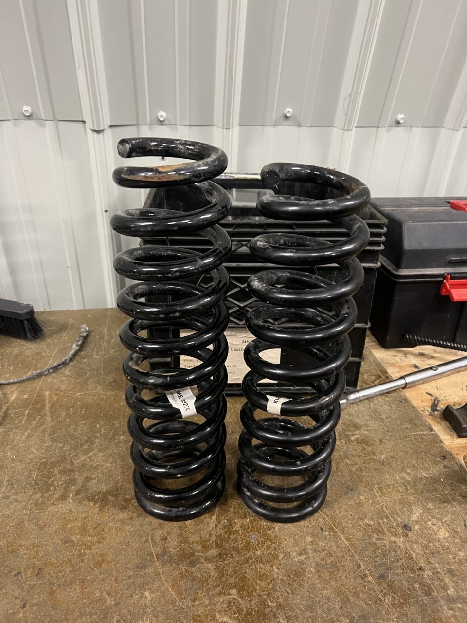

    Now to fit the new wheels, difference between OME 881 and 882 springs!

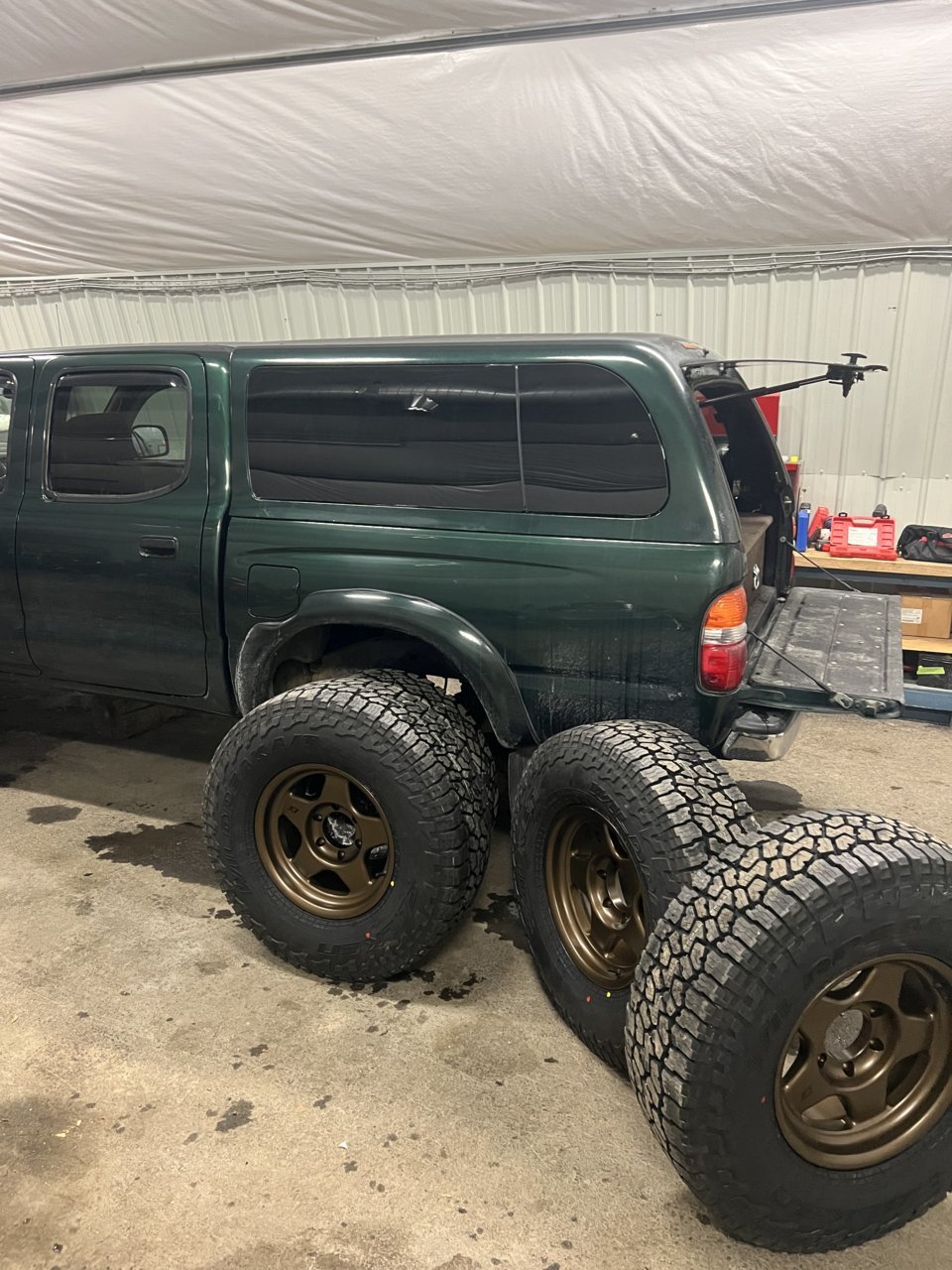

    I got the new rubber mounted on the wheels, I was so pumped I took the rest of the workday off to get them onto the truck!
    Front clearance check after getting the new springs on, still needed to get aligned but after a quick smashing of the pinch weld and reforming of the fender liner, she was barely rubbing

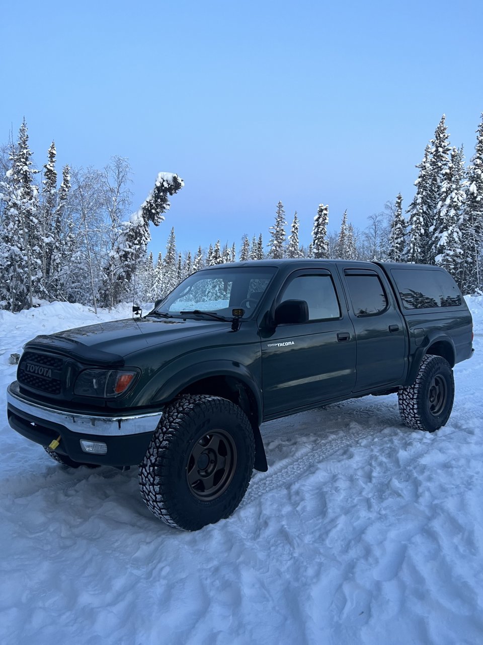

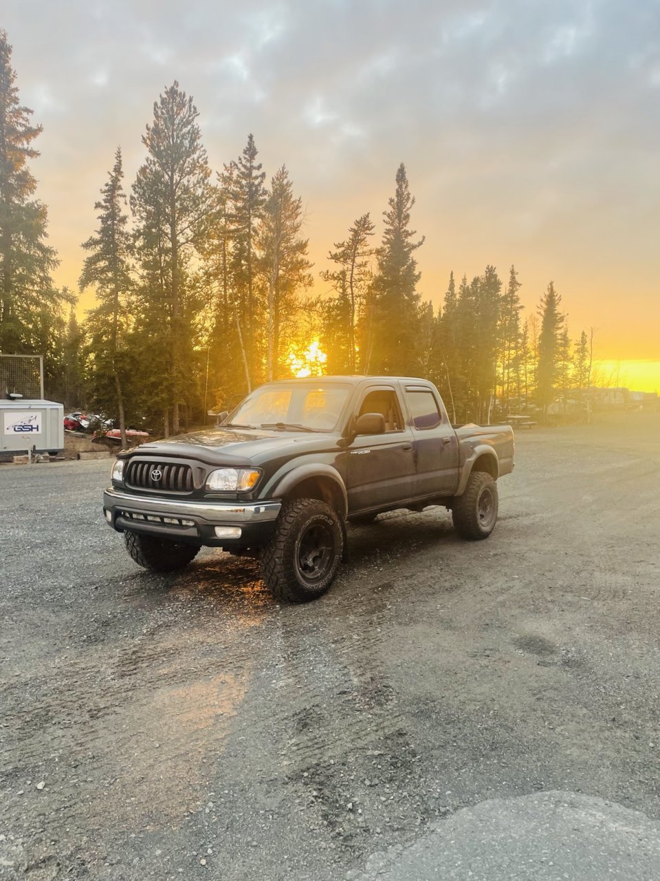

    Wow what an upgrade, been over two years in the building of this truck and this is my favourite upgrade yet, what a difference!

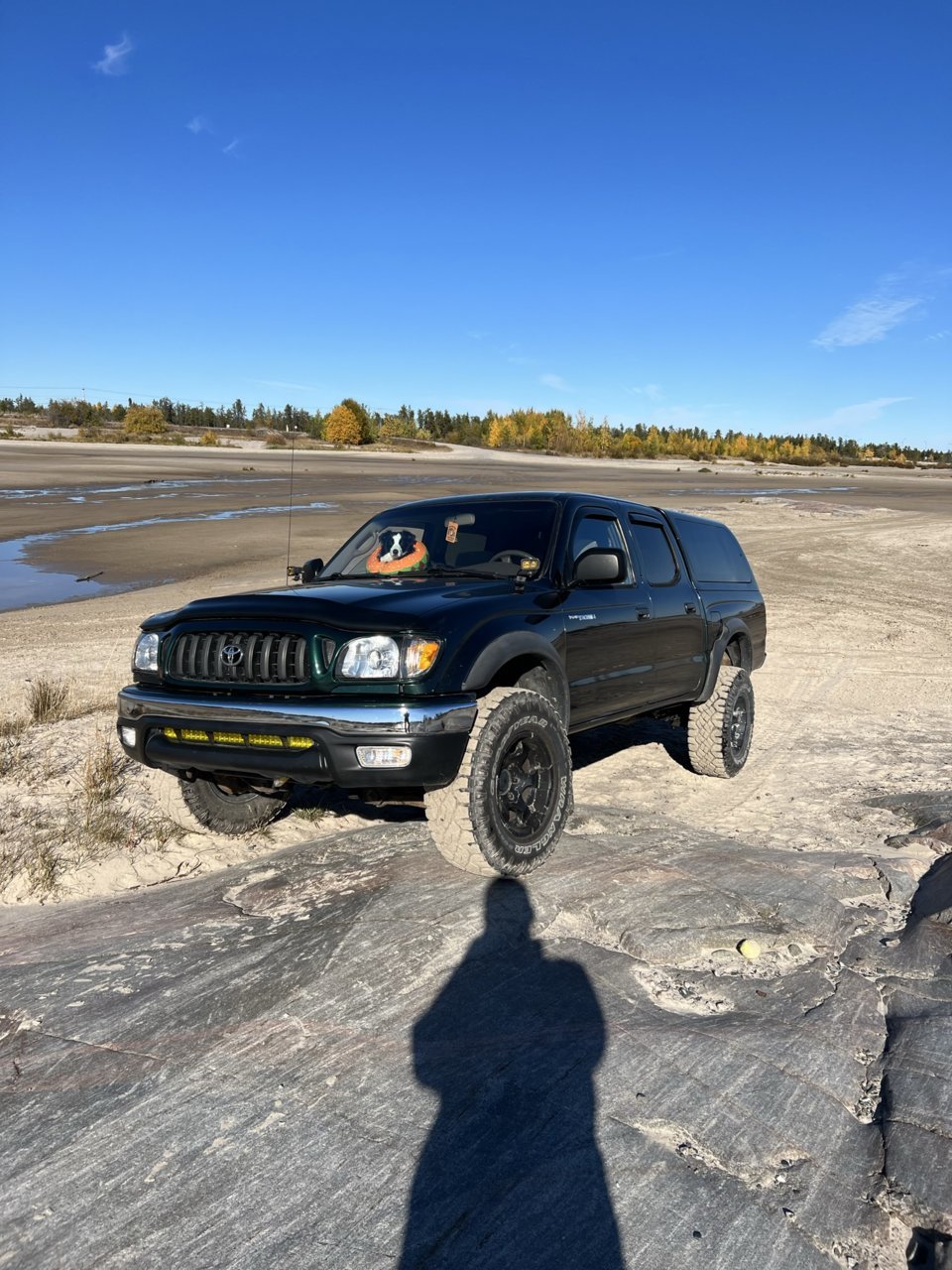

    And he’s some of the latest photos of the truck, I’ll be trying to update this as time goes on but I still have lots of plans for the truck, i’ll try to update regular maintenance items as well as future plans for the truck!

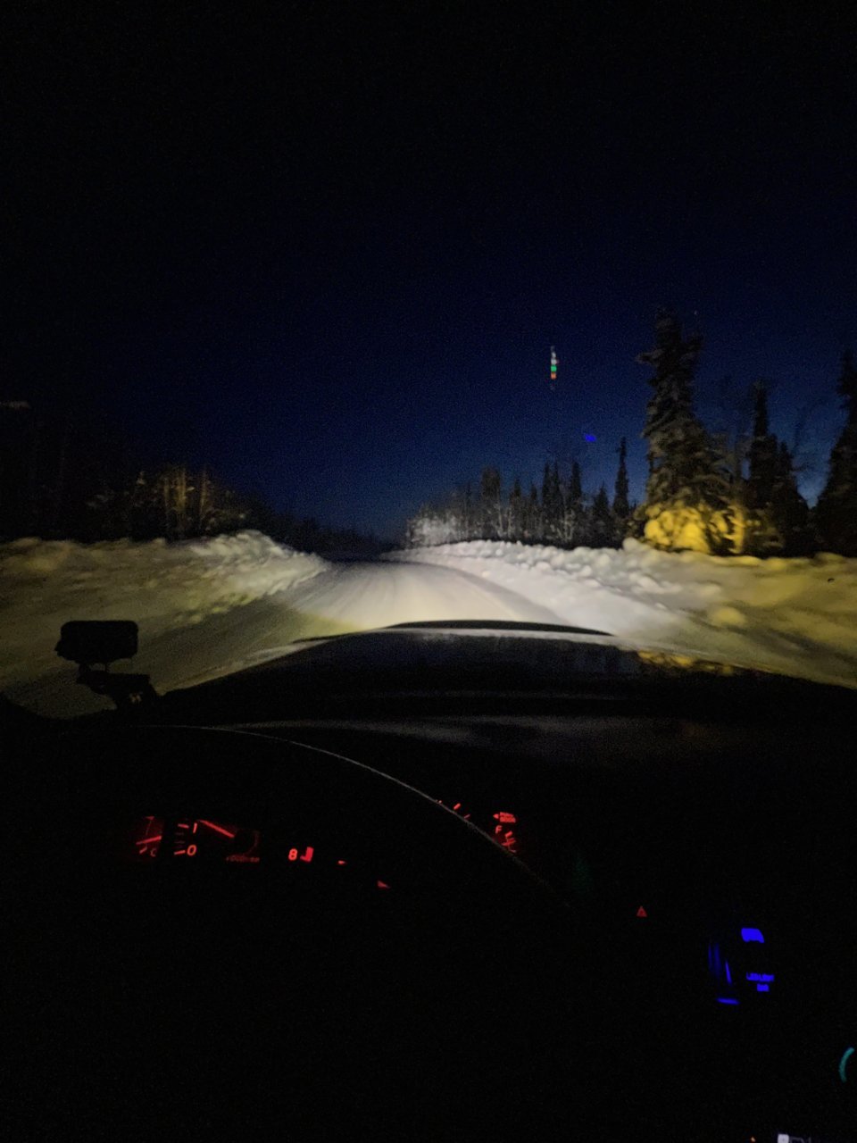

    A photo of the light output from the headlights, ditchlights, this was before aiming the ditch lights after I lifted the vehicle, hence the direction being above the snowbanks haha
