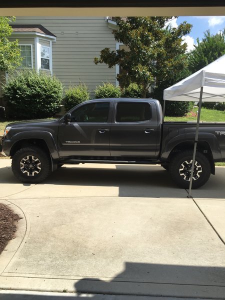

    I have Dakar leafs, Icon 2.0 w/ resi, custom build for Dakar from Headstrong Off road.
    I did not want much lift- so I removed the top overload on that Dakars. Smooth ride; rides like a Caddy on the interstate; smooth off road.
    With some weight in the back, the ride is very plush; no sag so far.

    How much lift did you get by removing the top overload? I want to get the Dakar's but I don't really want to lift the rear 3 inches or over.

    2.5" lift.
    The removed top overload is 1/2" thick. My OEM hub to fender measurement was just under 21.5". After settling in for a few months, my rear is now 24"- hub to fender, with top overload removed from the Dakars. (was slightly higher after install.)
