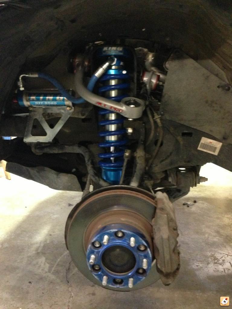

  17. Sep 11, 2013 at 10:06 AM
    #17
    SpaceBalls
    SpaceBalls Active Member
    Apr 14, 2011
    #54915
    29
    Vancouver Canada
    08 Taco trd
    3" block lift 33" BFG's AT
    Have you checked how much drop travel you have? When I installed my kings they said you should have a 1" min drop. I have 2". Also what size tires are you running? Mine are 285/75 r16
    And I'm running 3" all poo springs in the rear.
    I put as little preload on the springs as possible with out the tires rubbing. Also to level the front because of the driver side gas tank I needed to add more to the driver side! Did you? There for the front sits a little bit lower then the rear. But I would rather have that then more preload! [​IMG]
