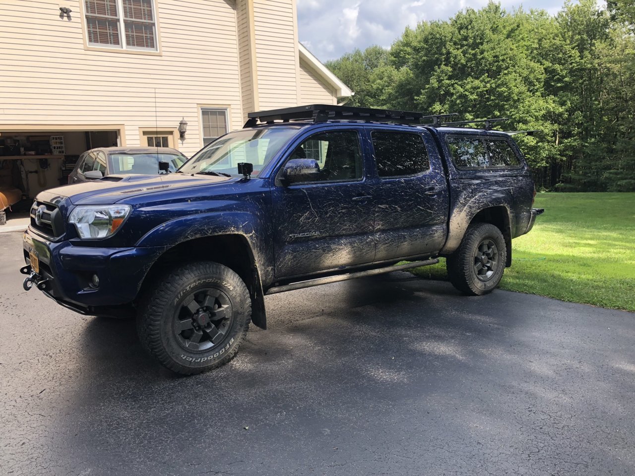

    29C9B0B0-CACE-41D5-9BDC-9542DF800D7E.jpg As helpful as this site is, it can overwhelm a person with information/opinions and sometimes its hard to tell the two appart.
    I have a double cab shortbed sport with 5100s all around, Eibach 620lb springs set for 2.5" on the 5100s, and a US Offroad Stealth bumper (steel) with a Warn VR-8 Synthetic winch. I find this to be appropriate height and stiff enough so the nose dive during breaking is not problematic.
