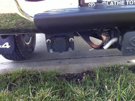

    I got the air bags for my truck to a) give it a slight lift in the rear to match my Billies up front and b) in the winter to level the truck with the sled in the back. Works great. And the ride is really good as well. I'm glad I didn't go with the AALs...REALLY glad I didn't!

    @Terry: No load I have them at 12-15psi and the ride is as good as stock imo. The bags are pretty soft at that psi. With the sled I have them at 60psi and its a soft ride, but firm. Unloaded at 60psi and it rides rough.
    @95SLE: Thanks. I just got them at a truck parts store. They were around $350+tax if I recall. A RV shop had the same set for over $600...rip off! lol

    Tubes are run out to the back bumper... on each side of the license plate... It takes just seconds to change the pressure.

    On each side of the 7-pin connector is a good place for the schrader valves.

    $350 here in Canada was a good price...I did my homework first, believe me.
    At 15psi, I get about 1" lift which levels it with the Billies @ 2.5"
    I was debating the compressor but they are not cheap and not sure their reliability in the winter.
    @p-hill: I wish I had thought of that location. Mine is on either side of the bumper, underneath it.

    Sorry, but that is a terrible place, as is that power connection for trailers... First serious off road dip you cross and it gets smashed right off. I unbolted mine and zip tied it up by the spare (I don't need it)... Just think if you dropped off a ledge and smashed that, both air bags would go flat as the air rushed out!
    Drill holes on each side of the license plate for the fill valves.

    BTDT with accidentally tearing the plug-in off---twice. I finally bit the bullet and drilled the bumper to the left of the license plate and mounted the plug-in there. Works much better!
