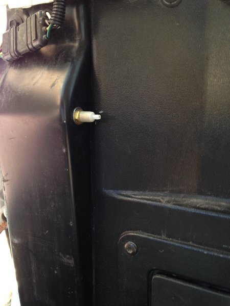

    Well I didn't like the gauges mounted inside that small storage box. I removed them for now and am looking for a better spot. I did find a place for the schrader valves. Here's a pic of the drivers side.IMG_1848.jpg

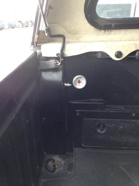

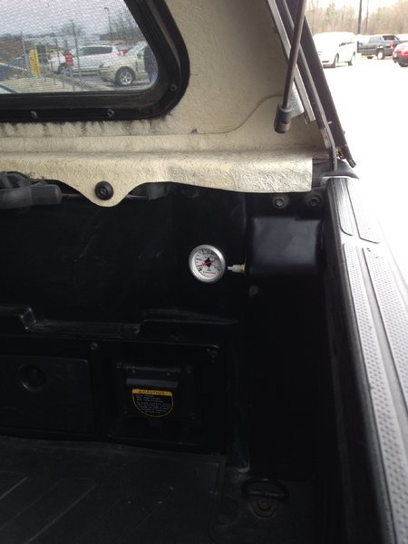

    This is where I mounted the gauges. I tapped into the parking lights for illumination as I was already using that circuit for the cap's dome light. Used a two inch hole saw to cut into the bed. Now I can reach the inflation valves by just opening the rear window of the cap. At night the light from the gauges shines on the valves.IMG_1849.jpg
