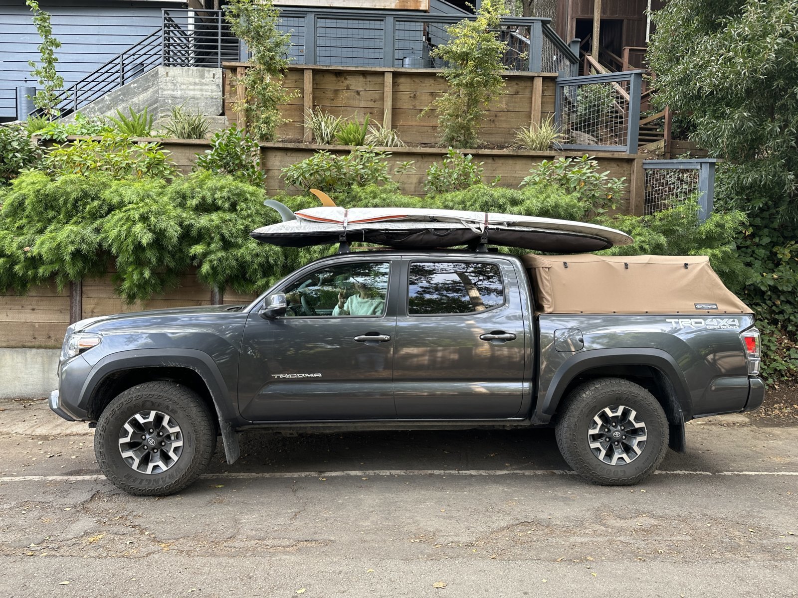

    Hey guys new taco owner here (23 TRD OR DCSB). I just put 2100 of my first 5000 miles on the truck through Baja and found myself 1) needing to carry a bunch of water, gas, camping gear, toys like surfboards and 2) off-road into spots where trails were mild but wanting to do more, and felt like I shouldn’t with how squatted the truck was under that weight. Felt like this was a pretty minimal setup (soft topper, ground tent, lean water budget, etc) and the truck is still riding low and heavy. Photo attached.
    Planning to do a lot more of this as well as truck stuff like hauling gravel, dirt, lumber for home projects.
    I was planning to keep it stock for a while but I’m guessing the answer here is a lift and leaf pack?
    Tentatively planning on 6112/5160 bilstein lift and 255/85r16.
    Medium Dakar leaf pack? Will that screw up my ride quality when the truck is empty?
    Considering Firestone airbags for hauling, Sensible? Overkill?
    Do others on here offroad while loaded up this heavy? Should I just grab aluminum skid plates and skip the lift?
    sense check me please!

    Looking at the pic, the truck looks fairly level. It's supposed to squat a bit with weight in it, that is why it has rake from the factory. You don't appear to be nose high, so I don't know that I'd be to worried.

    Level but low! I was stashing stuff all over the place to even out the weight, Slamming off the bump stops even on the freeway. Will a 2” lift help here or just adding more squish? How do those trucks with 1000lbs of bolt-ons still manage off road?

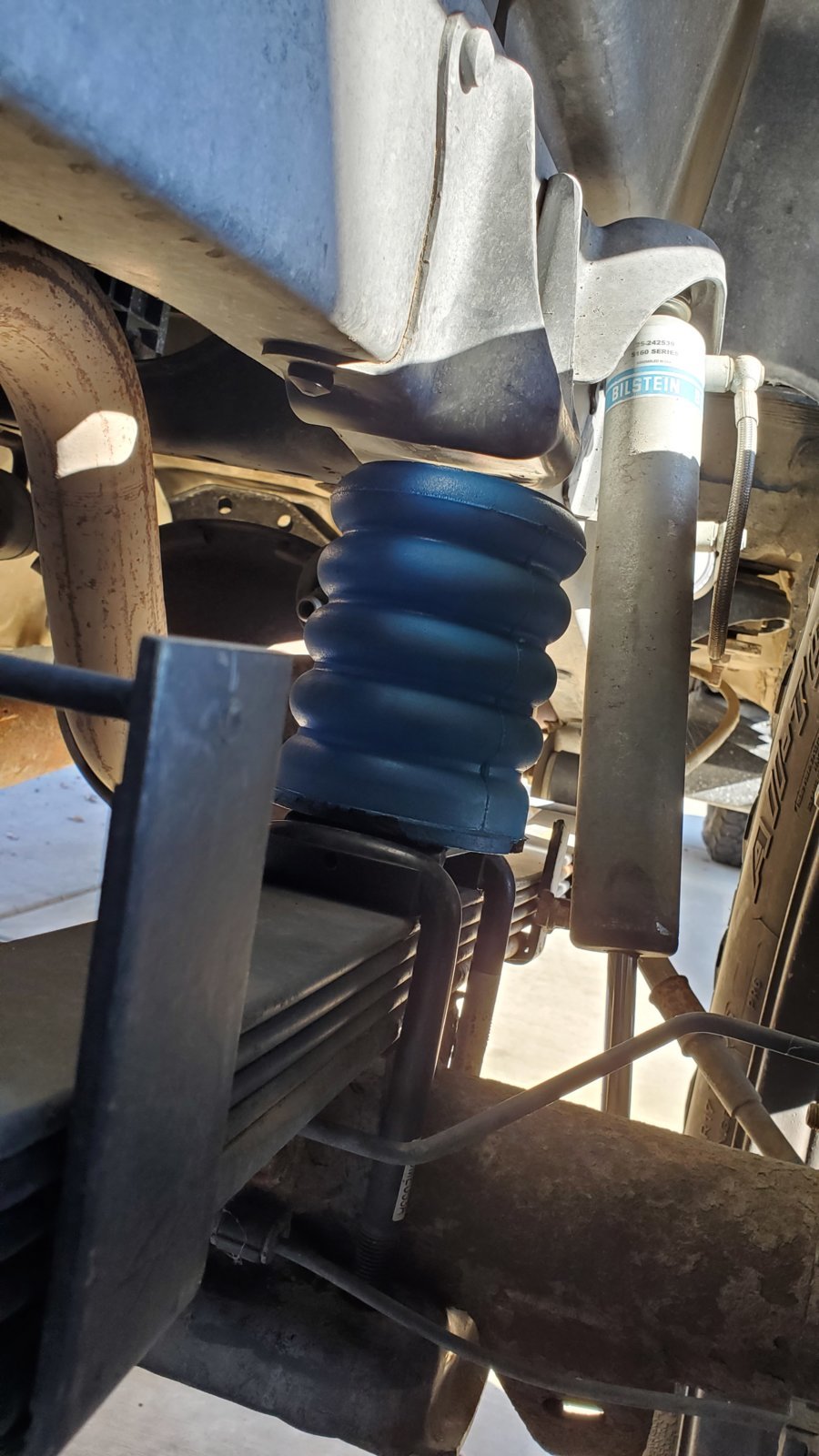

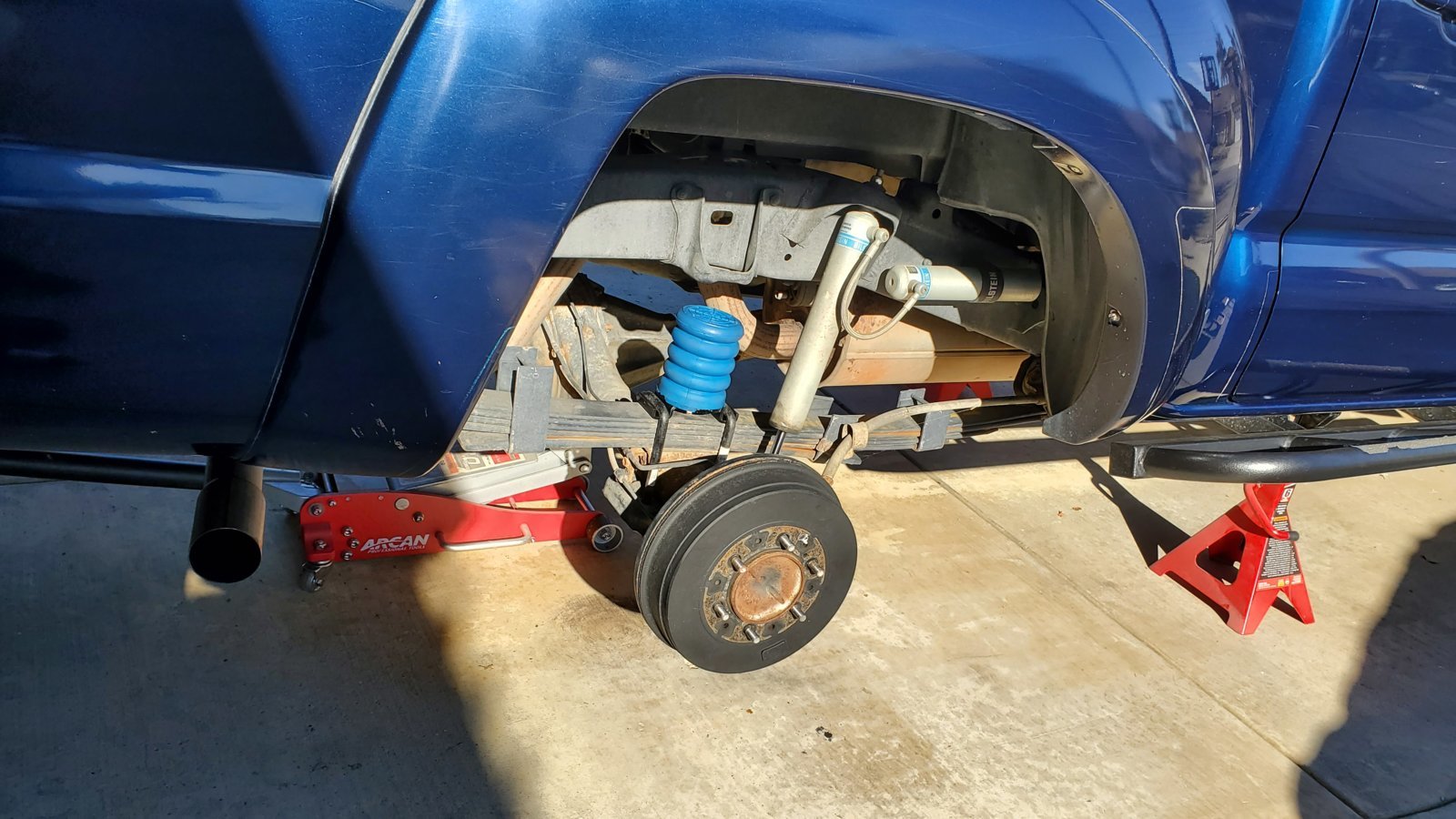

    I had medium Dakars on mine to compensate for topper and the gear permanently on my truck. Worked great off road, but would still slam the bump stops when on highway/freeway. My solution was Sumo Springs to replace the factory bumpstops. They addressed the freeway slam and would engage to reduce squat when I was loaded for travel. The first image is installed and the axle unloaded. The second is the truck on the ground showing the air gap before the super bump engages in travel. Very progressive engagement.
