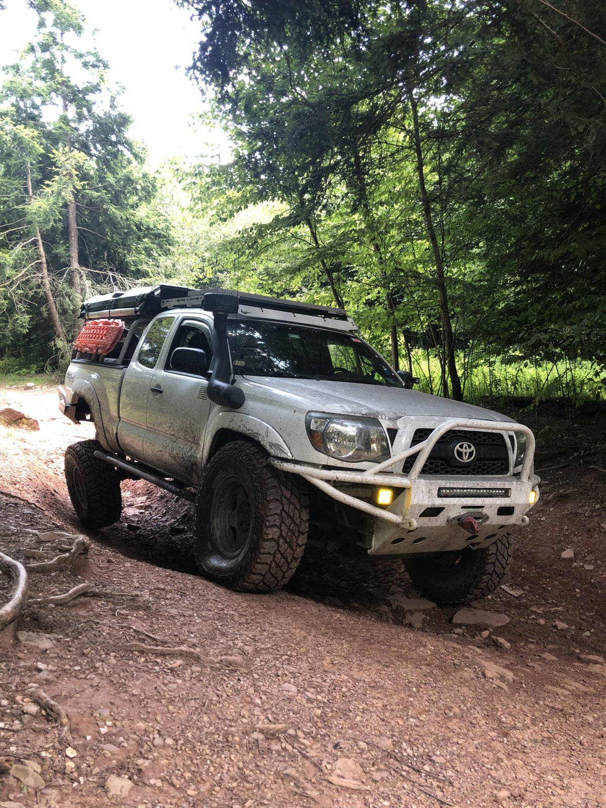

    2010 TRD OR Access Cab
    I don't think I had thousands of pounds of bolt ons. Still can handle myself offroad.
