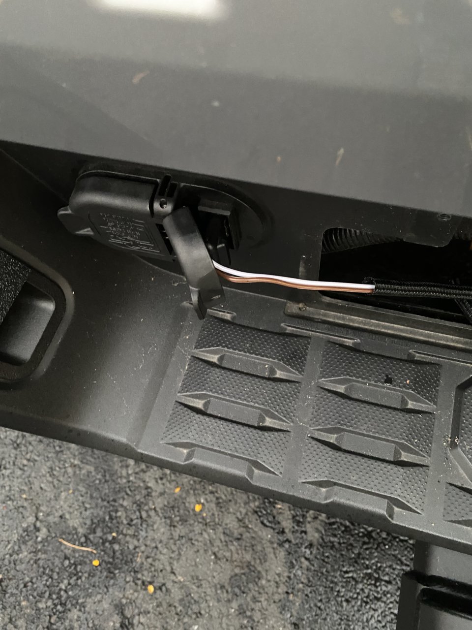

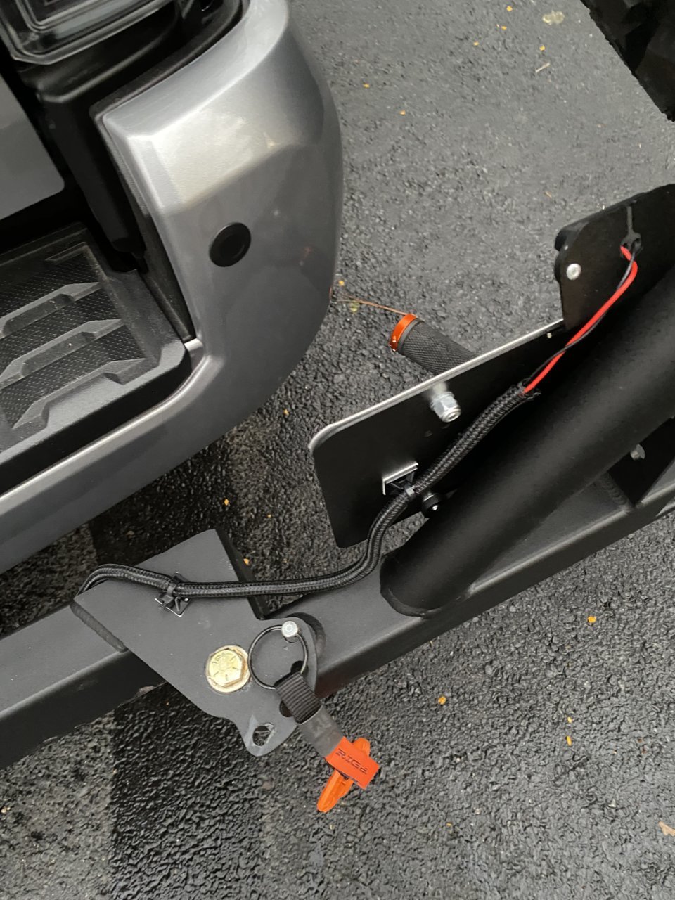

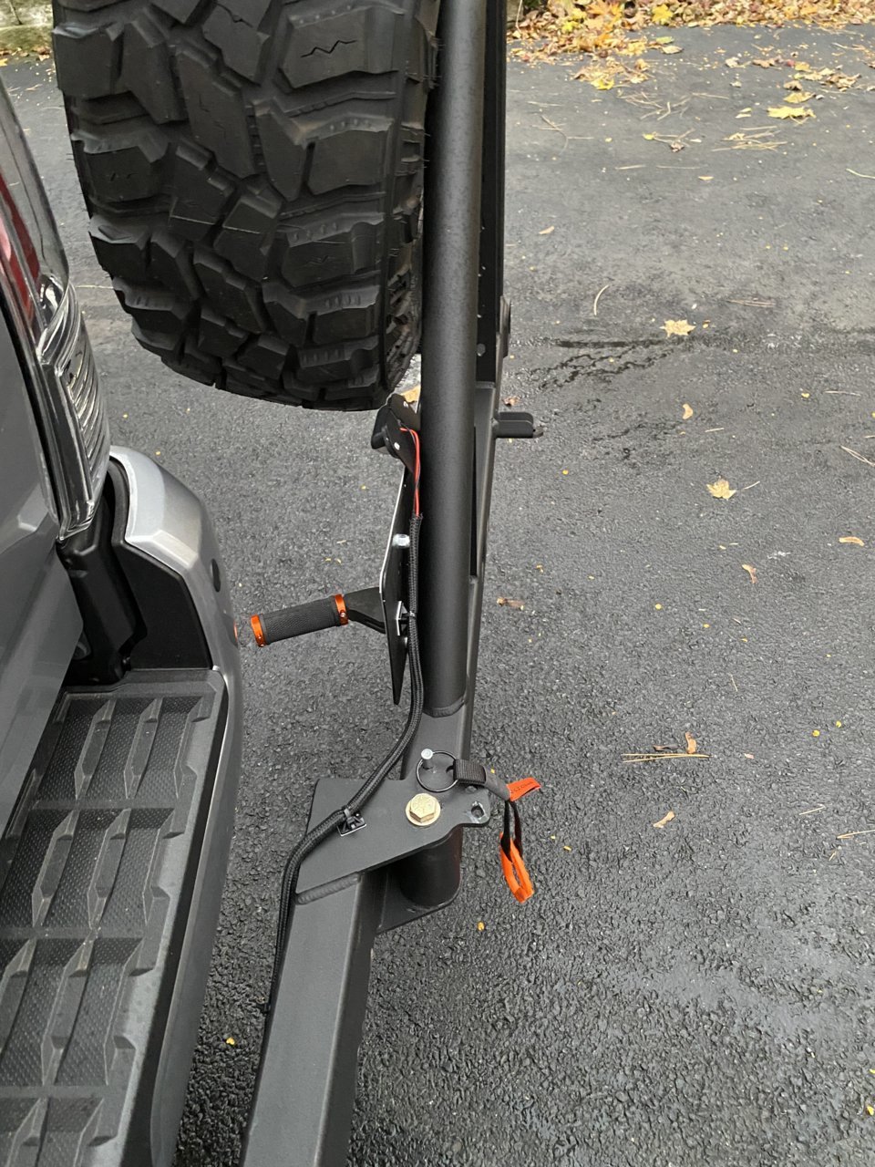

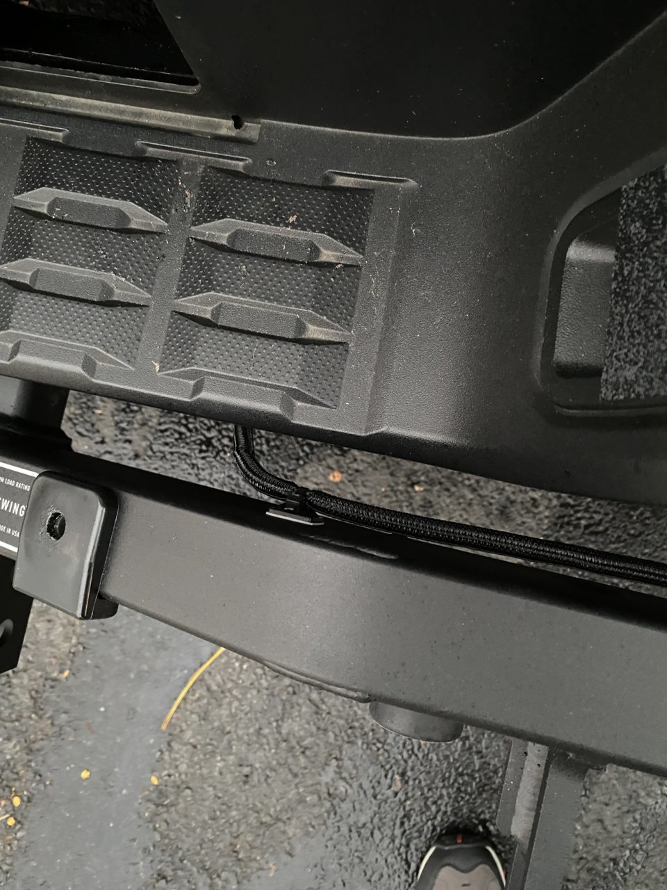

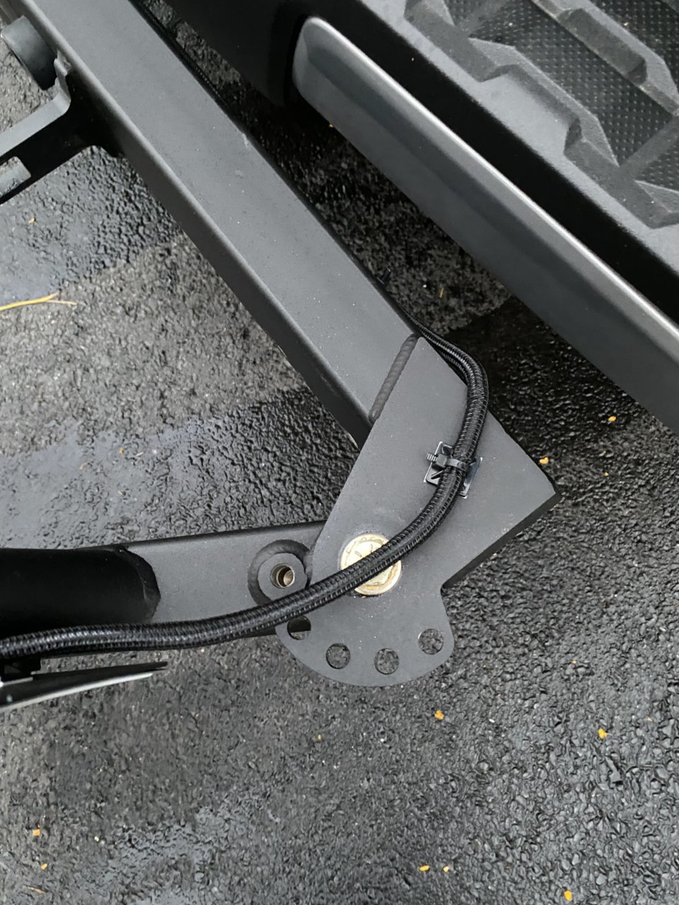

    Ran the wires for the LED License Plate Light. Opens up nicely.

    I've used those cable mounts before and they never stay on long enough for me. I'd recommend buying some automotive 3M tape and replacing the tape on the brackets with it. They will stick until you need to pry them off down the road.

    Yep…they’re complete garbage. Zip ties are really the only thing that will work directly.

    Yeah I am going to peel them off and use some Gorilla Tape that shit is beast.
