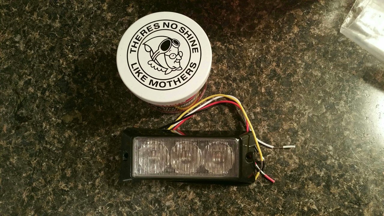

    Enough of that though, I'm a contractor on state highway job and private quarry expansion projects so I have amber/white strobes around my work truck like crazy. My personal truck however- my tacoma- is getting them added on. But I want the to now be seen easily unless they are on because people drive like grandma's when they see lights on vehicles.
    I've been racking my brain for two weeks now on how to mount my two small strobes on my rear headrests and have them rock solid. I don't want brackets in my personal truck so this seems the best option.
    The strobe lights are small and I'll post pics of them but I need some creative thinking here so they don't turn out like crap? 7be4a24d7b2b50949267721116552ef6_11264cebcedbc39e53ec4eabddaeba73ec781d30.jpg

    Strobe lights have 4 wires: ground, hot, delay and sync so if your lights don't have this then you need to buy something to hook up to them to force the patterns to them. I think Show-Me makes some good ones, I know they make good headlight kits. But the switch I have has two switches for my front and rear lights then a momentary delay to change the pattern of my lights through its 14 different patterns.

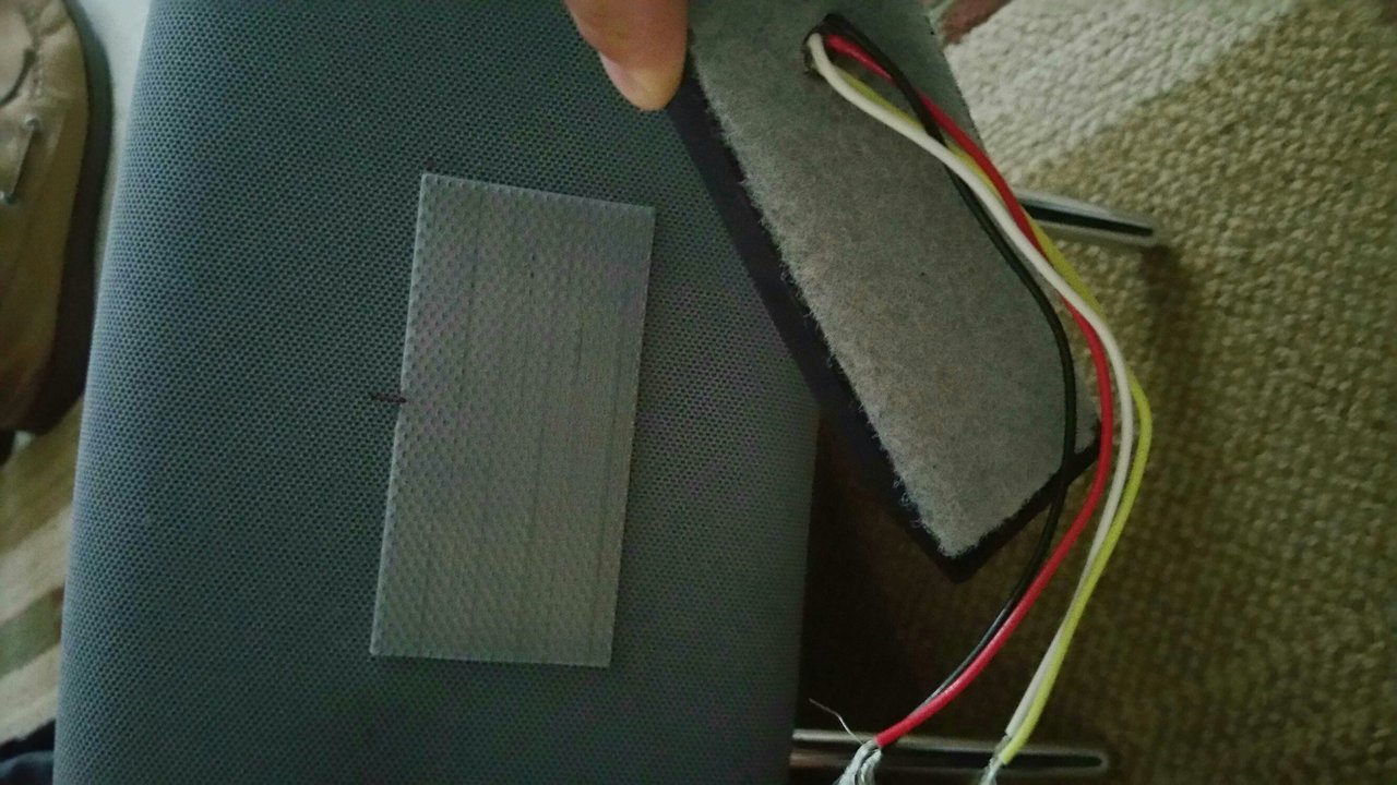

    Well got everything going and one of the lights wasn't marked correctly so it's red rather than amber so I'll have to send it back. At least I tested them before I began working on the lights.
    I took the faceplate off, and on the metal backing measured where the wires came out, cut a hole in the fuzzy vecro to match up to it and then put the vecro on and rolled the extra vecro around the corners of the light. Then I put super glue on the inside of the faceplate, and fit it back onto the light and made sure the rolled over vecro slid up into the face plate.
    This was everything is clean and flush and I don't need screws to hold the face plate down. Came out better than I thought. And then the adhesive on the "industrial extreme" velcro is hardcore attached to the fabric so it's not going anywhere.
