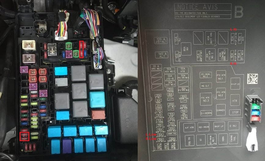

    My right headlight wouldn’t turn on, then I swapped the bulbs and it still won’t turn on. Any ideas? Did I blow a fuse maybe.

    did you try the bulb from the right in the left? would think whatever fuse it would go to both L&R. what about the DLR lights and Blinker on that side , they all work?

    Not sure about the 3rd Gen, but every vehicle I’ve ever worked on has separate fused for L and R lights. Check em.
