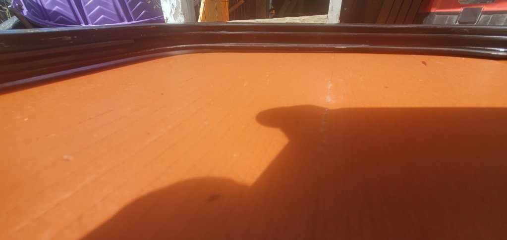

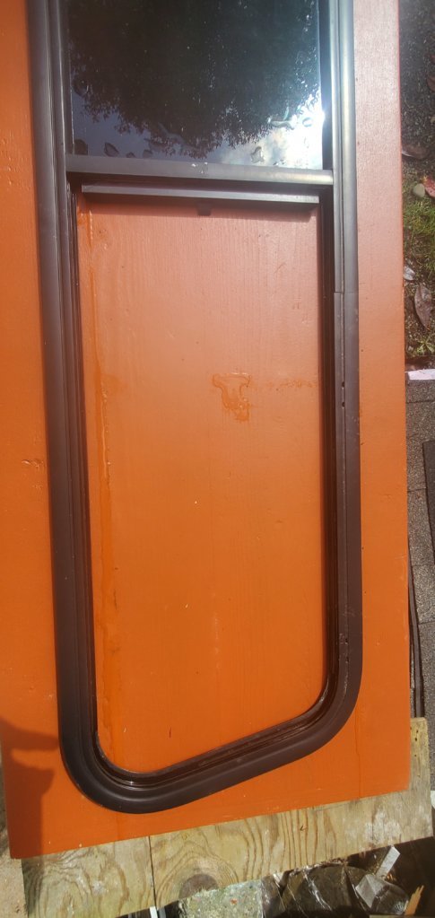

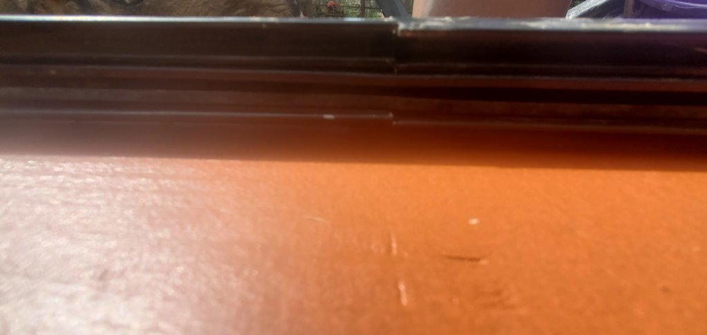

    Here's three pictures of the window frame that I took out of the camper top. The gutter is 5/16 of an inch on three sides and a little over 3/8 toward the middle.
