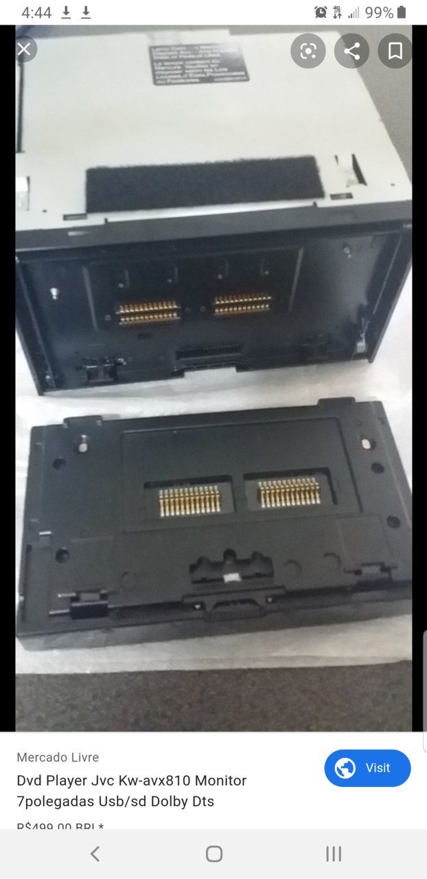

    Ok fixed that problem my dumbass pulled out the wrong rca on the back of the deck cause I changed them out cause 1 rca was bad. Still having problem with the faceplate loose connection with the headunit cutting off. In out

    What is the faceplate loose connection? Can you just solder it to fix it? Maybe post a pic.

    Here it is
