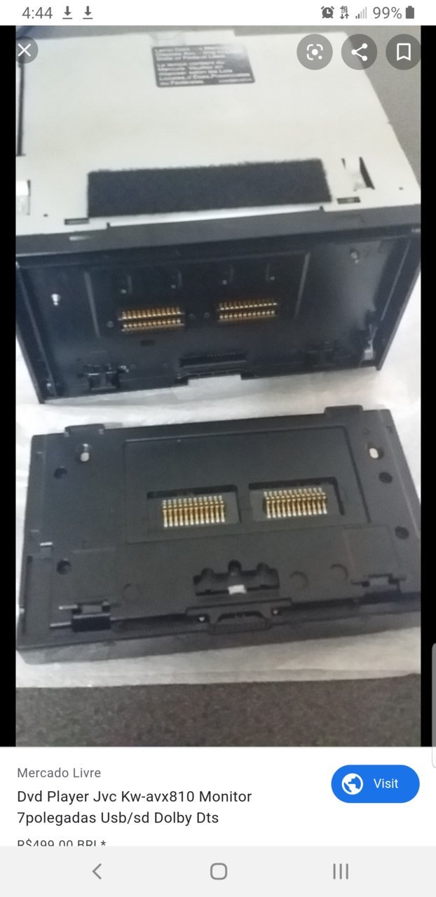

    Hey pink I have never tried to fix that issue but if my stereo did that I would try cleaning the contacts with DeoxIT and make sure the pins are not
    bent out if shape, then perhaps try to bend the pins in such a way that they fit tighter.

    Yeah tried that.. it like loose fit when I hit a bump

    Maybe you can tighten the mechanics by strategically placing some electrical tape to make it solid when it pops in? Or even hold it together with strong double sided tape?

    Wherever it is loose. I used the soft side of stick-on velcro to pad something similar so it wasn’t loose. Trial and error.

    I think it the opposite. It has to he pulled cause when I push the side of the screen the frame edge it will work fine

    I fixed that part now it back of the faceplate connector part being loose. The screen cut in and out. The surf been really good everywhere in the island. We go sesh one day.

    Cool making progress. If you can't get the wires to connect sometimes in the faceplate connector, either clean the interfacing faces again or add more pretension on the springs. If that doesn't work, new faceplate?

    Soo I tilt the screen and haven't disconnected yet. Changed the rca and solved the problem
