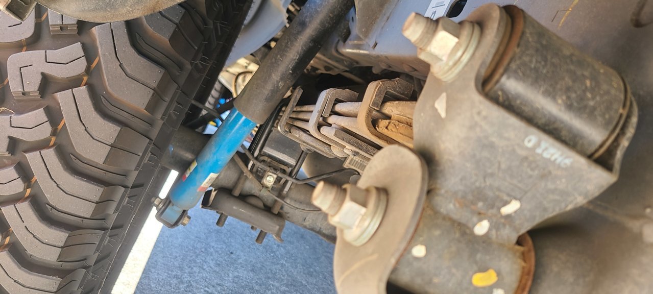

    I put a 3 inch leveling kit on my 2019 tacoma sport and not the leaf springs are flat and some how the right rear sits an inch higher than the left rear, how do I fix this

    Its ok, some pics would also help us help you

    That's the right side

    I guess I am not sure what pics I can take to get the help I need

    Post pics of all 4, both front & both rear.
