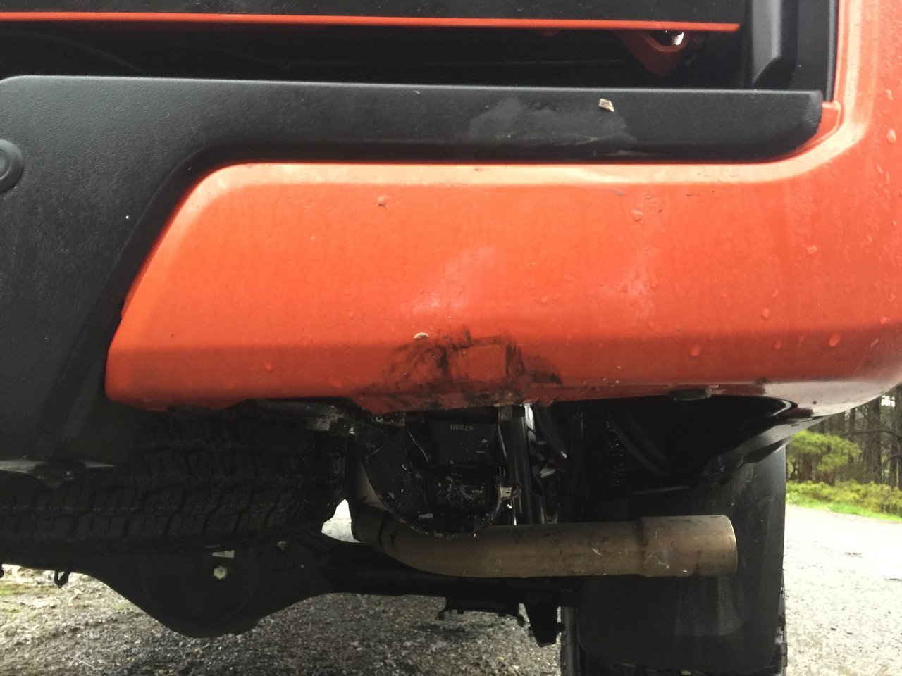

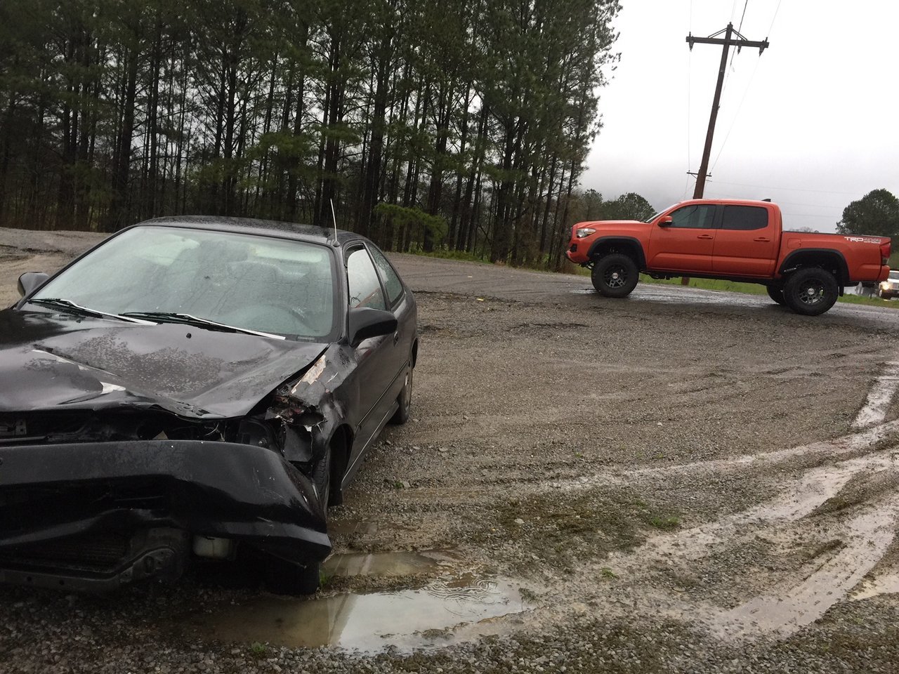

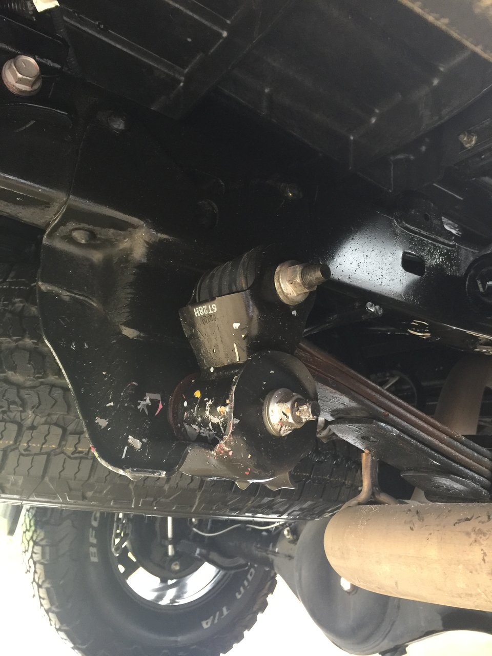

    My wife drove my truck this week and was rear ended. It bent the right rear spring hanger. Has anyone replaced one before and part #?
    Civic lost this one.

    Part # 04483-04080 or 04483-04081.
    EDIT:
    04483-04080 is for prod. 11/2015 thru 11/2017
    and
    04483-04081 is for prod. 11/2017 thru current
    look for the production date on you door jam label.

    Are you running a diffrent size tires front and back? In the picture with the civic in it it looks like the front tires are smller than the rears.
  7. Apr 11, 2018 at 6:24 AM
    mopar2
    mopar2 [OP] Well-Known Member
    Feb 5, 2017
    #209712
    466
    Franklin TN
    No, same size front and rear
