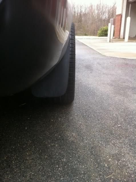

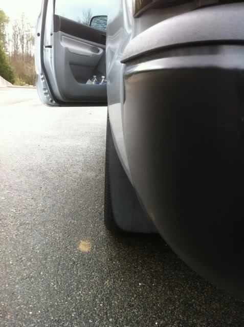

    Mine is the same way. It's less noticeable now that I'm lowered, but it's still there. Took this pic around 25k miles....now at 75k.
    Left side
    Right

    if the 05+ are anything like the 95-04, your bed will be mounted to one side. You can see it where the box and cab meet, it'll stick out on one side.

    I noticed this on my 05 XR after I went DJM and put wider wheels on it. I loosen the 6 hex bolts that hold the bed and realigned it. It isn't as noticeble but its still not perfect.

    I had the same problem. Just realign the bed took care of it for me. :D
