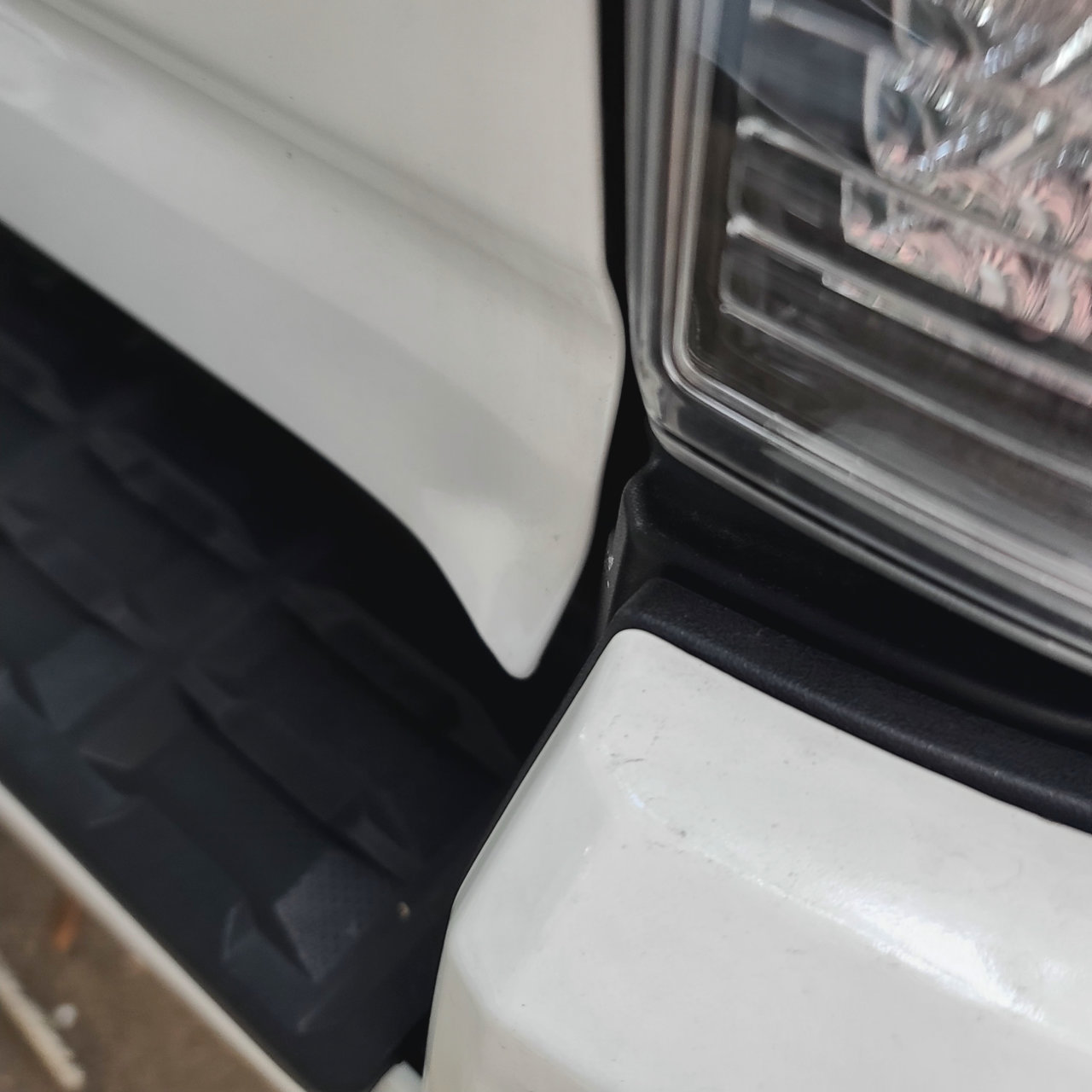

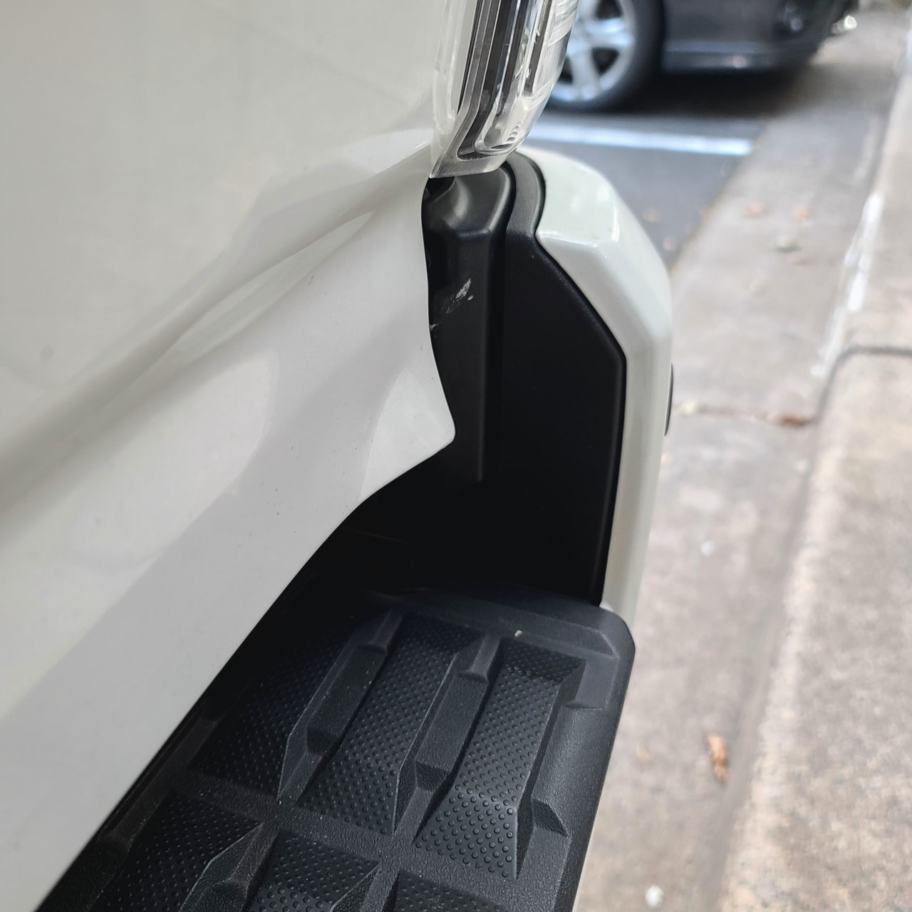

    The right side bushing broke on my 2018 tailgate. This caused the bottom right corner to get bent. I replaced the bushing but the damage is done.
    Any tips on bending it back? I wanted to check here before I make the problem worse. The paint is all still looking good.

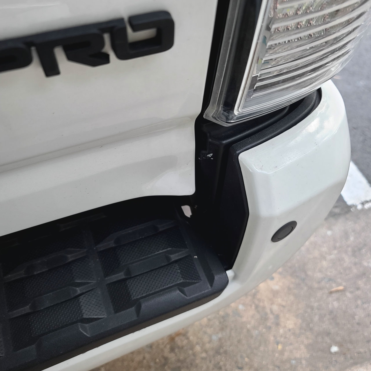

    Went to a PDR place and they said they couldn't do it and that I should take it to a body shop. Body shop gave me a rough estimate of $600 because it needs to be painted. Body shop said the paint will crack when it's bent back.
    I think I'm going to give it a shot. I'm considering heating up the paint first to hopefully not crack it. Anyone want to make a wager on how badly I'm going to mess it up?

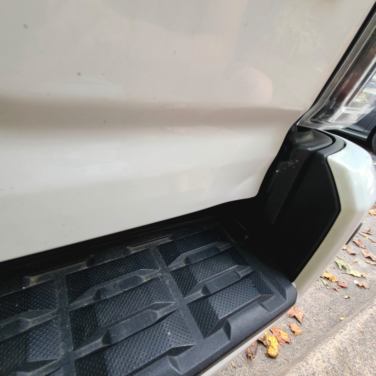

    Did it. It's still there but it looks a lot better.
    I don't know if the heat was necessary but I did it anyway. I used a 1lb rubber mallet.

    Did you remove the tailgate and back the area with a dolly?

    No, I just removed the tailgate. It took all of 2min to remove.
