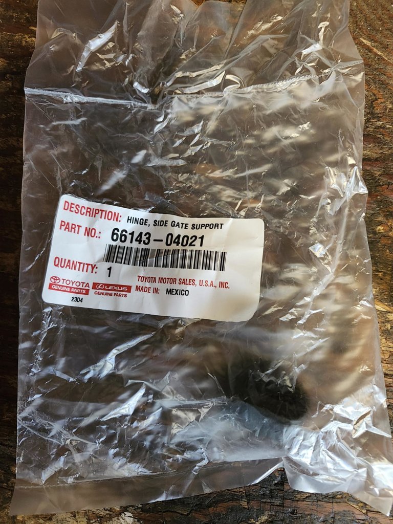

    Afternoon,
    OEM tail gate bushing available again for older 3 gens with integrated damper.
    Cheers G

    ^That's the P/N for 02/2016 and newer trucks. 08/2015-02/2016 needs 66143-04020: https://www.tacomaworld.com/threads/2016-tacoma-tailgate-replacment-bushing-66143-04020.452351/
    66143-04021 is shown in Toyota's part catalog as superseding 66143-04020, even though it isn't a direct fit. The parts counter guy wouldn't know any better.
    There's a Napa part for GMs that's reported to fit: https://www.tacomaworld.com/posts/27177746/
    Canadian sources:
    https://www.napacanada.com/en/p/OES81957091
    https://partsavatar.ca/dorman-tailgate-hinge-bushing-38706
    https://www.thewrenchmonkey.ca/products/auto-parts/dorman/38706/

    How difficult is it to swap the new bushing out?

    Super EZ - just pull the gate out a bit and the bushing is plug and play!
