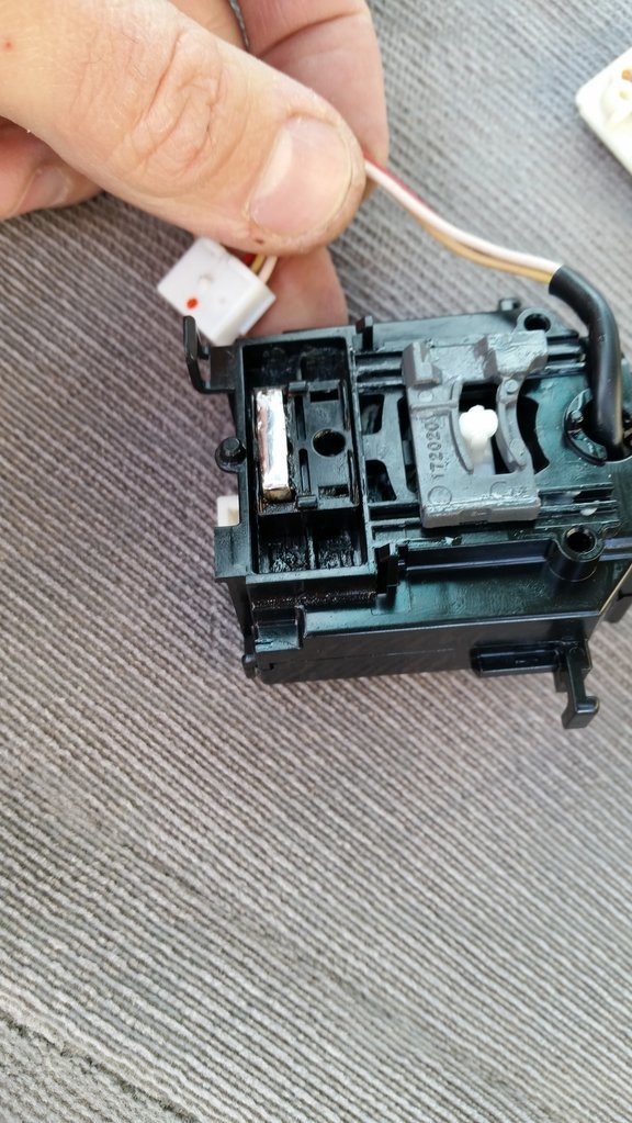

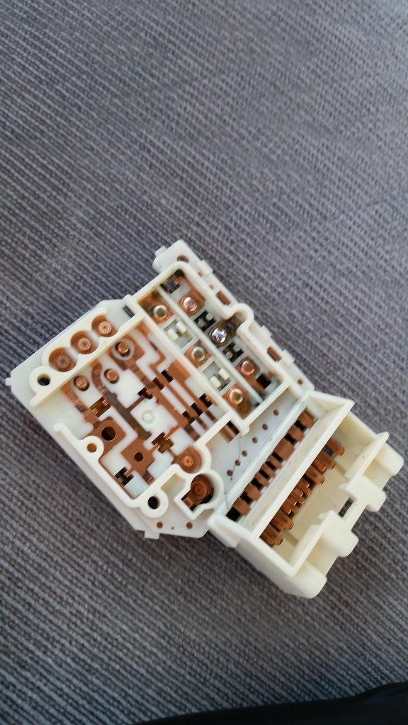

    Ok. I figured I'd update this incase anyone else might run into this issue. I thought initially it was a wire harness issue, as putting pressure on the harness that connects to the signal assembly would make the right signal work. I replaced one of the female connectors on the harness connector but that didn't help.
    Opening up the switch again, I realized the internal switch contact was pivoted. I cleaned it well and then took my soldering iron and some good silver solder and put solder over the pivoted contact. This leveled out the contact. The center contact on the other portion of switch as also worn down. I cleaned that and also applied a little solder. Put some Dielectric grease in there and that seems to have solved the issue.
