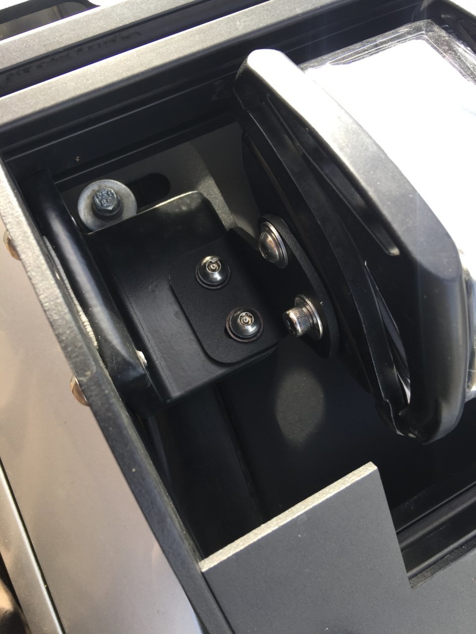

    I'm very happy with it. Adjusting the beam pattern inside the truck is the biggest benefit.
    I have 35" STT Pros, so I really can't tell if it's noisy or not. After installing it I couldn't tell a difference...?
    I didn't get the low profile mounts. I made a angle bracket for each side of the Prinsu for it to rest on.
    Biggest drawback to the bar would have to be its weight. It's really heavy. Lots of wiring, plus it draws more current than a traditional bar...
    Could I ask where you got the angle brackets?
    Also are there multiple wiring harness... I was under the impression that it’s just one harness from the light bar.

    Me and a friend made them. Angle iron tapped with 4 threaded holes, powder coated black.
    There are only three wires coming from the bar itself. Heavy gauge power and ground, plus a control wire. They run into a relay harness. Coming out of that there are wires for the control module and the switch panel that you put in the interior.
    It's more than a normal light bar, and the wire is so thick it's hard to sneak into tight areas compared to other wiring I've done. Even compared to car stereo stuff.

    Would the low profile mounts work with Prinsu Cabrack?
  18. Aug 12, 2018 at 8:16 AM

    There isn't anywhere for them to attach. I didn't see any reason to invest in them.

    So unless I make a custom mount, there is no way to mount these?
    Cause Rigid Adapts with the Prinsu looks slick af.

    There isn't a way to mount them that I am aware of. But, the mounts I made are very easy to replicate.
