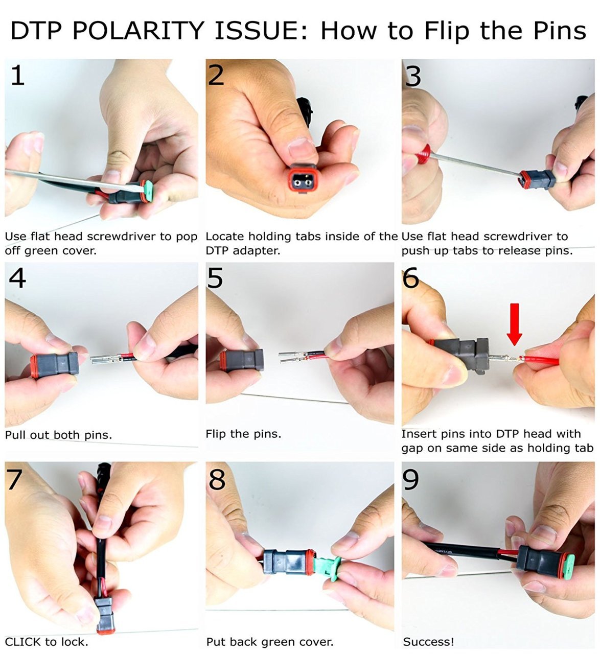

    I have a 2006 Tacoma TRD offroad and I just installed a bumper and added the rigid fog lights and bought the wire set up from caliraised so I could use the stock wires from Toyota to go to the Rigid lights. When I plug it all in nothing works. I tested the lights and they work fine but when I use the splitter it doesn't. I pulled the plug apart on the splitter and use the two prong things and mixed them around to see if the wires where backwards and nothing. I'm not sure what to do. Is it the splitter or something else. TIA

    With most OEM plugs all you must do is a polarity swap. Would say 99% of the time that is the problem, when connecting oem plugs to the original fog light harness.

    Wow! Great info. Thank you all for the quick reply. One more thing I don’t have to obsess about. Love your truck geek house. I’m looking at the amber rigid pros myself and that pic sealed the deal. Now to the winch.....
