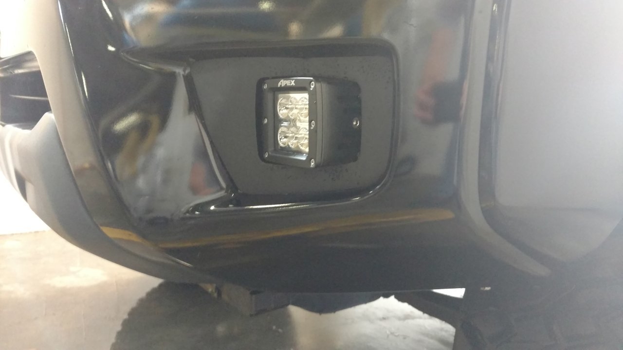

    Any body running those Rago mounts? I have another company's fog light mount with a generic pod. Yes they are bright and light up the road. But they are not at all a fog light. They throw light every where and I get flashed a lot. So I am looking to replace them after only 1 year of having them.

    Yeah you want to avoid forward facing LED designs with a clear lens like that for street use. Aside from blinding others you get a lot of wasted output into the air, vs focused light where you want it.
    There are SAE fog pods that use a center body mount that will fit the CaliRaised fog pod mount. I’ve tested the compatibility for mounting these, but not yet driving. While the raw lumen spec on these are close to Rigid, the power is much less so I’d expect the Rigids to perform better. There are a handful of other more powerful options I have that will fit as well but I haven’t tested them out yet.
