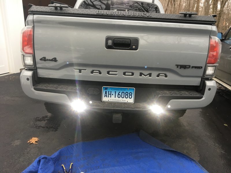

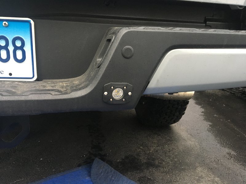

    Mimicking is the highest form of flattery...
    Spliced em right into the OEM bed light harness. 60 minute install with proper splice and solder.
    They come on when the bed lights come on (door open or with the dash switch).

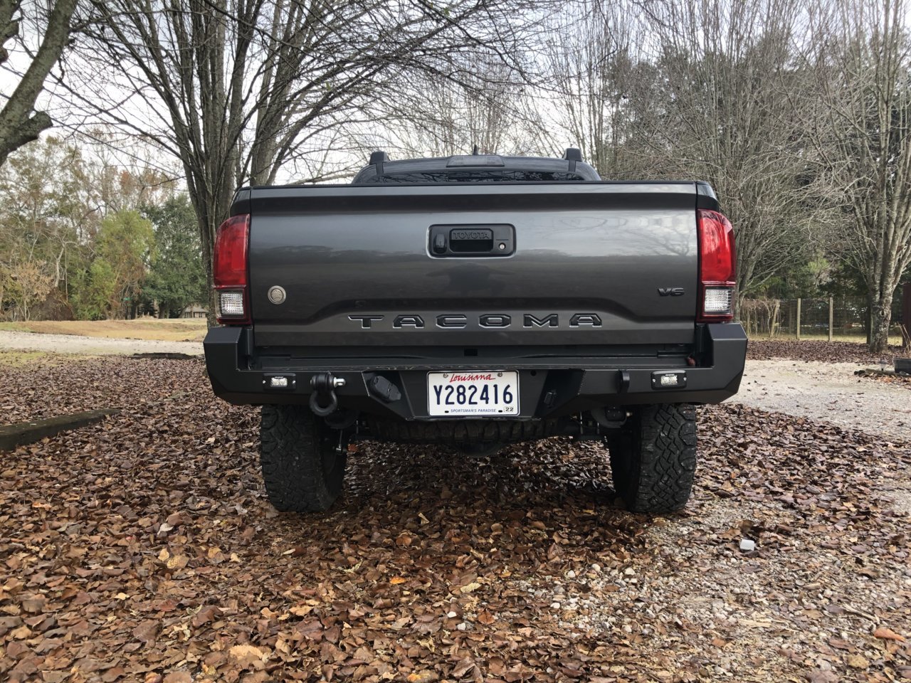

    I cheated.
