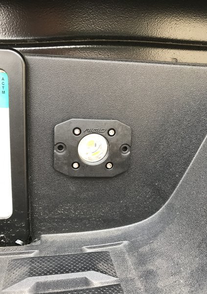

    I don't ever do write ups, but had some time today, so I'll post this thread for another Rigid Ignite rear bumper install option.
    @Siblue (who I originally got the idea from to use this little gem of a light) also did a very cool dual setup towards the outside surfaces of his bumper that many loved and ended up doing to their own trucks. Through testing the single LED pod unmounted, I figured the light was plenty bright, so I chose to do a recessed single unit for my night time work or fishing activities.
    Here's another Rigid Industries Ignite thread along with some pics from Siblue's install and thread OP.
    https://www.tacomaworld.com/threads/rigid-industries-ignite-led.453588/
    I may or may not post wiring as it's pretty straight forward and described in other posts using the same setup. I'll be wiring the switch inside the bed right side smaller storage box along with the one for the @mattgecko bed lights. I was able to source the exact same weatherproof switch he uses.
    I chose this spot initially as it fit perfectly in between the metal reinforcement bumper under the plastic bumper cover without cutting into any steel. The pod doesn't rub or touch anything while keeping it minimal and simple.
    I'll update and put descriptions in later.
    Tools used for the cut.
    There's quite a bit of cutting, checking and fitting, but pics should be in chronological order.
    IMG_0301.jpg IMG_0305.jpg IMG_0304.jpg IMG_0306.jpg IMG_0307.jpg IMG_0308.jpg
    Trim / file the hole till the unit sits flush with the main surface of the plastic bumper.
    The backup sensor harness needs to be flipped up to the other side to make room for the light pod. It's the tab directly located above the light. Just unclip, flip, and reattach.
    I'll likely use some E6000 adhesive to hold this in place. It fits pretty tight as is and it's a square hole, so no worries about it rotating. No need for more screws if not necessary.
    So I said screw it, I ended up snapping pics of the wiring portion of it anyways in case any of you want to attempt the install also.
    Switch/ relay used...
    Getting the switch/ relay and wiring prepped.
    I just did a normal 12V remote lead turn on wiring setup with this.
    Drilled and installed Rivnut with grease ( to keep the drilled hole from rusting up ) to secure the relay unit. This splash plate is just below the AC power plug. 6P connector is the backside of the AC plug.
    Here's the overkill 40A rated Hella weatherproof relay for this little light that only draws ~750mAh. :rofl:
    The new switch is to the right of the bed light switch.
    The two weatherproof connectors inside the cubby storage box. The other switch is for the bed lights. I went this route, so I don't get the urge to flash someone on the road if they're tailgating. :) I can turn it on at anytime with the bed lights away from the cab if needed since they're both hardwired as an independent circuit.
    Final install connections done with cheesy shrink sleeve spades. I will need to steal some old two pin connectors from the race shop at work o_O.
    I went to a small fairly dark dirt patch that stretches back 100 feet and tried out the light. These two are with the Rigid Ignite only. Phone camera is horrible at night and I left the iPhone settings at automatic default.
    I thought the bumper would've blocked part of the beam pattern on the passenger right side of the truck, but seems not to be an issue. Good conical projection path.
    The next two with ultra bright LED reverse on. Nice hotspot with the cyclops pod in the middle seen in the lower pic.

    Yeah, no need for two. These things are really bright. I got the flood version. Just needed a work light.

    Output pics loaded with wiring setup done. Check out those old rusty crimpers from my MECP install days! 20 year old tools being used once every few years now. @mesojdm , I don't mind the winky winky look. LOL. I just need function. Asymmetry would usually bother me too, but look at the position of that fat cover for the tow plug!

    That remind me, OP do you mind posting a pic of your screen at night with the truck in reverse?

    These little lights kick ass for their size. Although...if I were doing these as reverse light, I'd prob go with the honeycomb lens(diffused) since distance isn't more of a concern VS width and even coverage. Good install

    Quick question: Could you have cut a round hole, with four small holes drilled around it? Then you could use the 4 screws to keep everything in place because the plastic bumper would be clamped between the light and the face plate. Just seems like it would be a cleaner/easier solution since you could do all your cutting with a hole saw and a drill. Also, this would eliminate the need for glue

    You could, but I didn't glue mine. It was pressure fit. It was tighter than I though, just need careful trimming. I didn't want to add any more holes or screws as the space was tight behind it.

    Thanks, I ended up diffusing it with frosted glass film. Took it camping and it was definitely too focused of a beam with the spot and clear lens.
