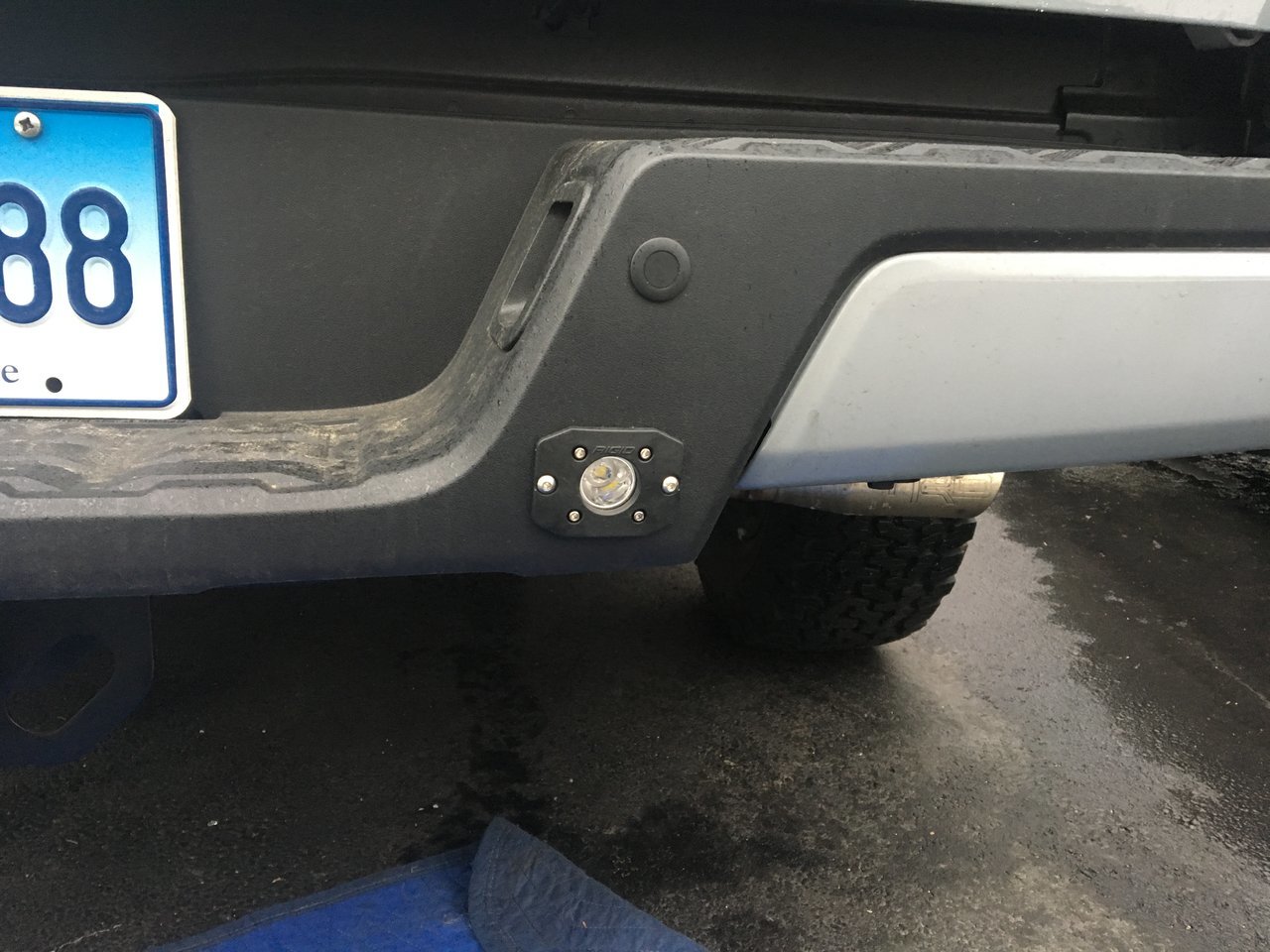

    Since the lens is removable, you could probably get a diffused from Rigid for cheap and swap it.
  3. Oct 30, 2017 at 12:17 PM
    #23
    GPsevinSixx
    GPsevinSixx [OP] Well-Known Member
    Aug 15, 2016
    #194631
    3,021
    Ros Angerus
    2015twoAX2.4techPAWS
    6112/5160AALfnCNTSTRyokG015
    Do it! They're about $60 bucks. Don't even need a relay to simplify things. Make sure the switch can handle the ~750mAh draw :)

    My approach would involve less cutting and youd (hopefully) use the 4 existing screws. You would just cut the pattern on the left instead of what you did on the right. When you attach the face plate, the screws would clamp the plastic bumper between the face plate and the light, holding everything in place. Just wondering if you considered this but decided against it for some reason.
    Parker315 likes this.
  6. Oct 30, 2017 at 12:23 PM
    #26
    GPsevinSixx
    Aug 15, 2016
    #194631
    3,021
    Ros Angerus
    short screws and possible compromised seal. It's watertight to some degree. Would have to add another seal if sandwiched.
    nartmot[QUOTED] likes this.
  7. Oct 30, 2017 at 12:25 PM
    #27
    nartmot
    nartmot Well-Known Member
    Sep 6, 2016
    #196612
    356
    Interesting. Ok, thanks. I see my mistake now. I assumed the light was sealed even without the face plate.
    Thanks again for the write-up. I think its a great idea.

    Yeah, I think there would be more sourced parts to do it the way you mentioned. Not that it wouldn't work. Perhaps you can try it? It's an amazing little light for sure.

    Is there enough room behind the bumper to place the light a little lower, that way another one can be added on the other side under the trailer wiring outlet? Just looking at the pics, it looks like there is enough room in the gap in the metal bracket to lower it.

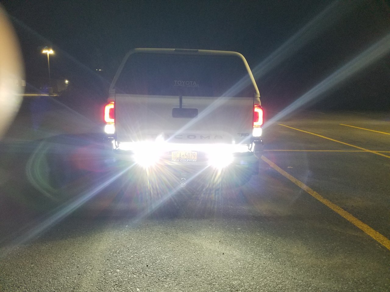

    I have a pair installed also just a different location in my bumper. Also went for Putco BLADE 60"20171002_043526_001.jpg

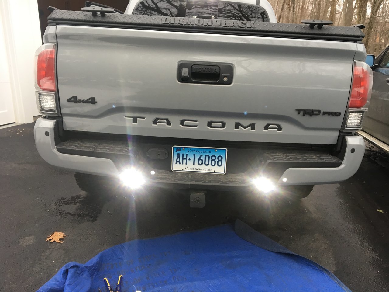

    Got any "off" pics? This deer-in-the-headlights shot doens't help much for installation ideas

    just finished my install o_O

    Yeh now that looks real. Nice install by the way there is only so many places to install them
